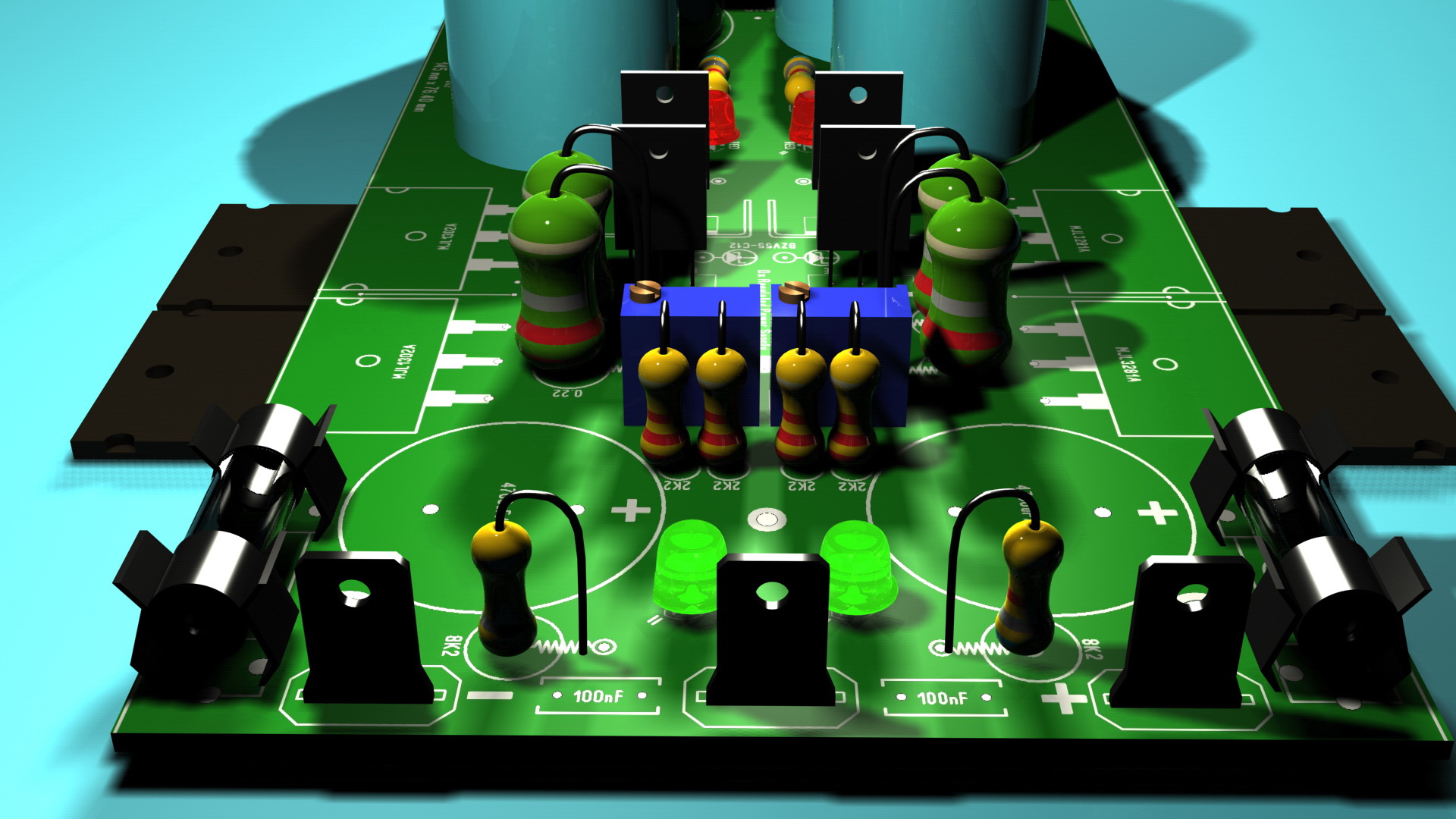

..got it! Thank you Uncle Carlos...🙂

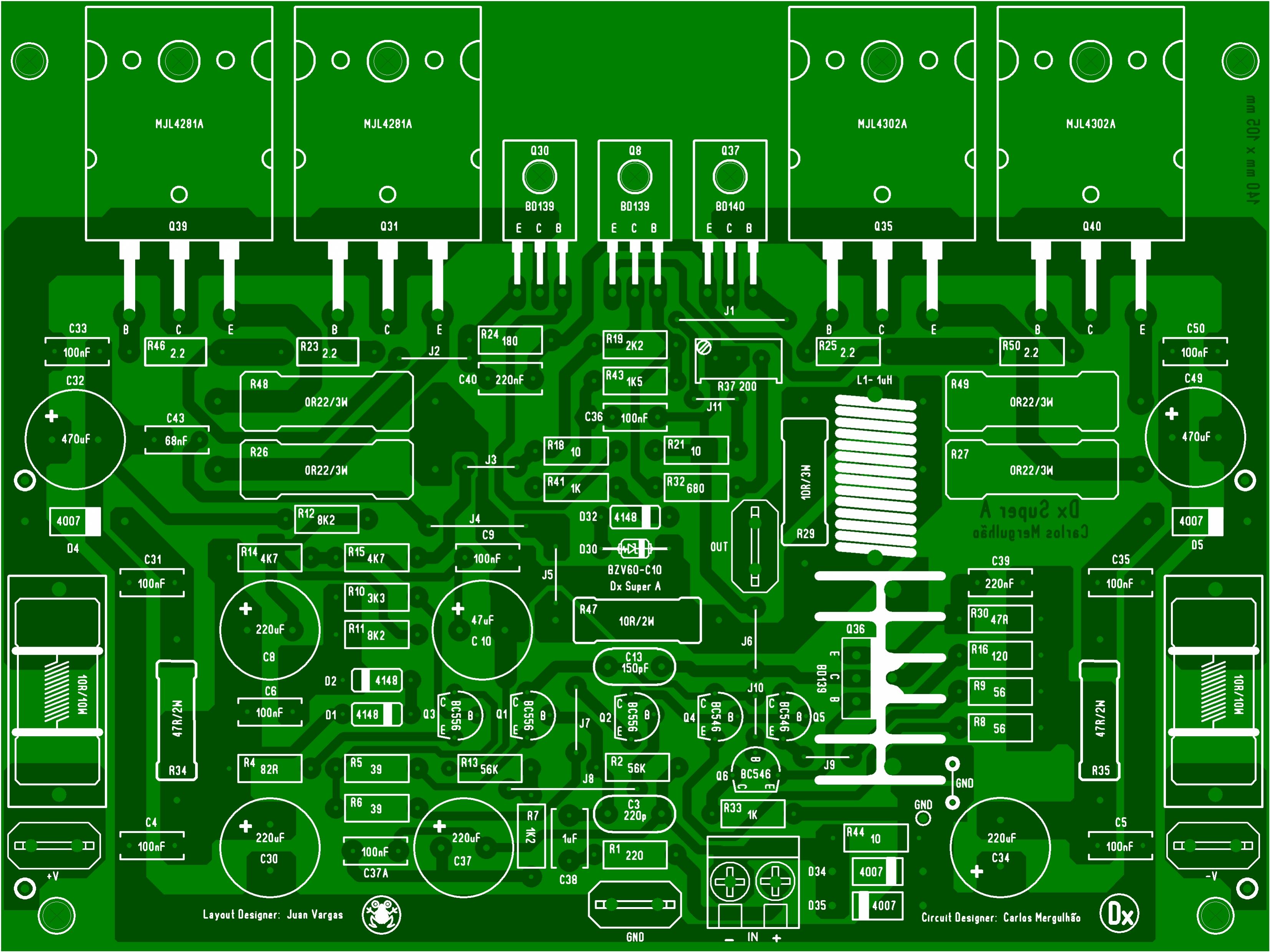

Hi Juan,
...and the pdf bottom copper for etching on this new lay-out? 🙂
Regards!

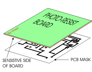

Ok now seriously, here is the layout with the changes to keep track of it. 😉
Regards
Juan
Hi Juan,
Regards!

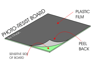

Oh?, well yes actually is not much changes but here it is. 😉 on the UV light sensitive etching I think the way it is after is printed the ink part of the transparent will face the copper clad and then put a glass on top of it to keep the shape of the layout then apply the UV light.
here is a link as an example: Manufacture of Printed Circuit Boards - 1
here is also another example from makemagazine : Circuit Skills: Circuit Board Etching - YouTube
Regards

Thank you Juan,
..as always excellent design from a new revolutionary pcb artist...
..by next month it is summertime in my place perfect for DIY works..😀
BTW, I do toner transfer etching. Maybe someday I could try the photosensitive etching I heard the material is expensive here in my place.🙁
Regards!

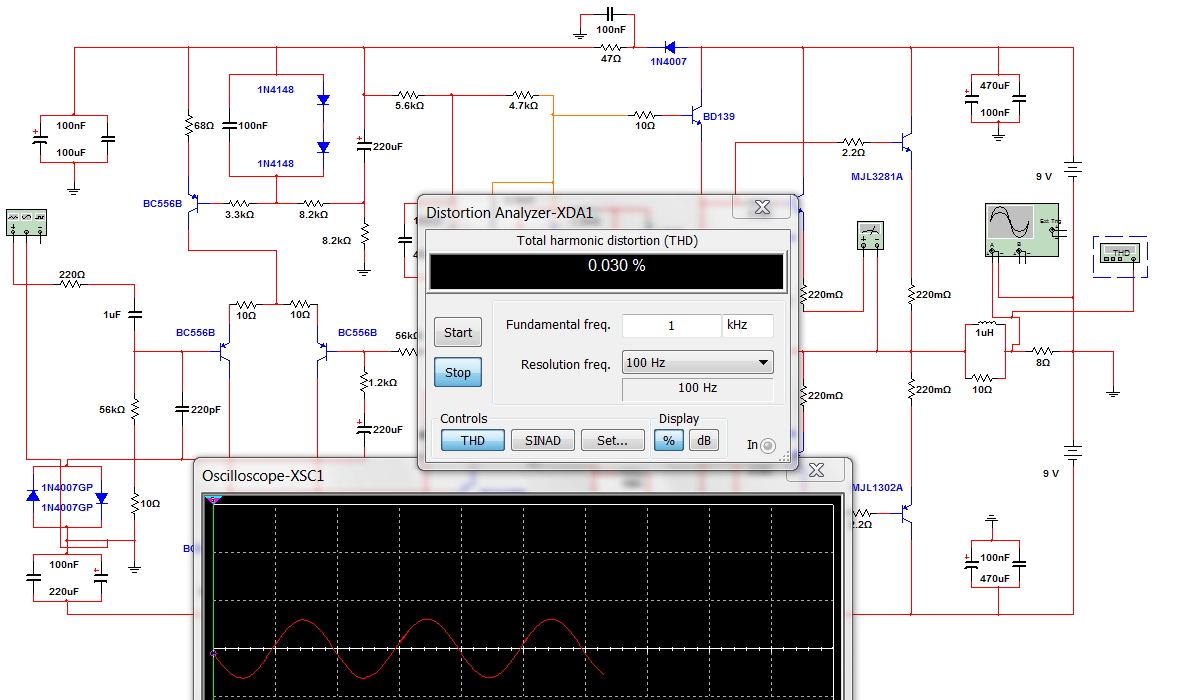

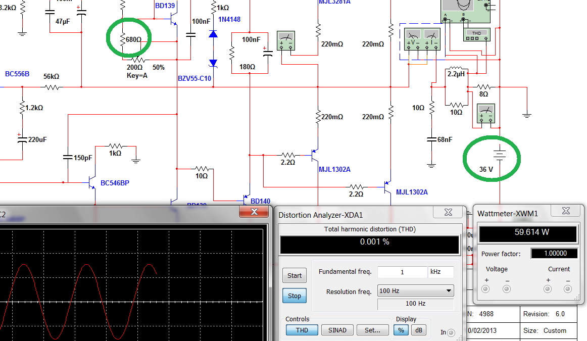

Dear Mr. Carlos,
I'm interested to build this amp but not really sure if the amp will perform same using +36/-36 supply and I'm thinking about the DX Blame ST, you may have explained this before but I thought I was not able to follow this thread for a long time and sure missed out a lot of informations along the line. I know that the design is based from MKII with +42/-42 supply, but if I want to adopt the Supper A to Blame ST what will be the parts I need to change? And can I still follow the same adjustment for bias?

Dx Super A will work fine with 36 volts too
There's no problem about it, your output power will be reduced to 50/100/180 watts RMS aproximately (8, 4 and 2 ohms)... but the overall audio quality will not change.
You may need to readjust the value of the resistor we have in series with the bias trimpot in order to adjust the current you want with this reduced supply voltage because the trimpot may not have range to do it.

Yep... have lost a little.... it was tuned and the supply voltage is important
In the place to have a ratio of 6 to 1 related second and third harmonics.. with your supply voltage the ratio is 4 to 1..... what does this means.... more third harmonic..and humans usually do not appreciate third harmonic.
If you want the best possible performance to this amplifier..then search for a 30 plus 30 volts AC transformer.
It can operate with three AAA batteries to each rail (4.5 plus 4.5 volts)..but the sound will not be good...also the power will not be good...naturally.
There's no magic... was designed to 42 plus 42 volts.... so...the performance is optimized to this voltage..if you change something it is probable you gonna loose something..because optimized means the "best possible performance" under these conditions.

The reason I want to reduce the supply voltage is because i like to use only 1 pair of output transistor (less parts), i just thought that it will be safer to do that with lower voltage say for 4ohms load, or perhaps what i think is wrong?

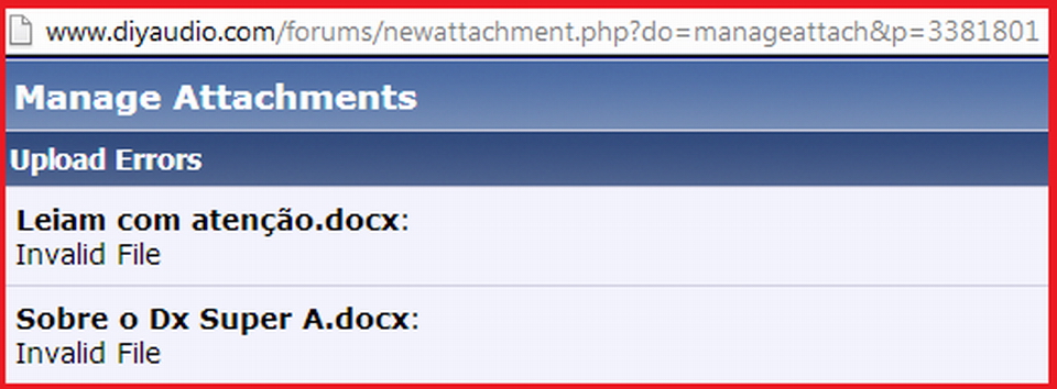

I have made text instructing Brazilians about the Dx Supply and Dx Super A
Details about fuses rating, transformers VA rating to several levels of power, needs of electrolitic condensers and things alike.
I do think it is very usefull and may answer a lot of questions.
Now a days language can be translated using Google translator...you just copy and paste there... write portuguese in the left side and in the rigth side select your own language...not perfect but helps a lot.
I will be posting two word docs, not opened if possible, because not the forum main language, and i would like to say this was posted before in several threads, it is just infomation i put together.
We have several countries that uses portuguese..also Italians are able to understand and several spanish language countries can also understand.... others, if interested, then go to google and i hope it will make a good version of your own mother language.
Sadly forum system have not accepted doc.... if you want, please write to uncle charlie and i will upload to you.
