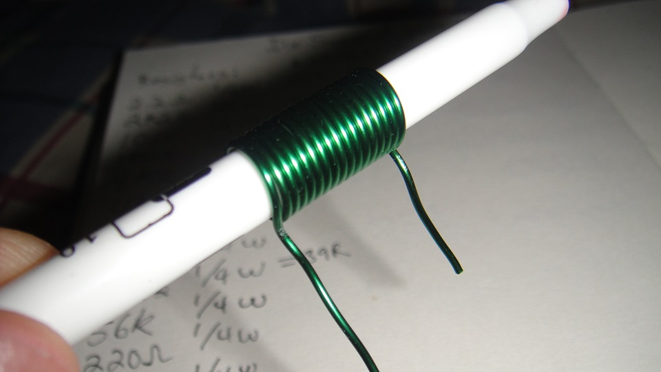

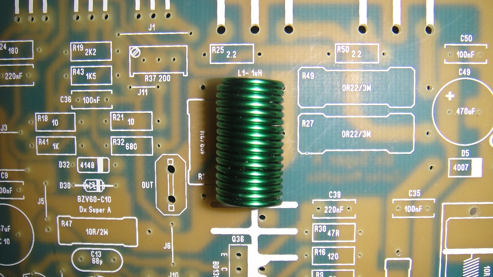

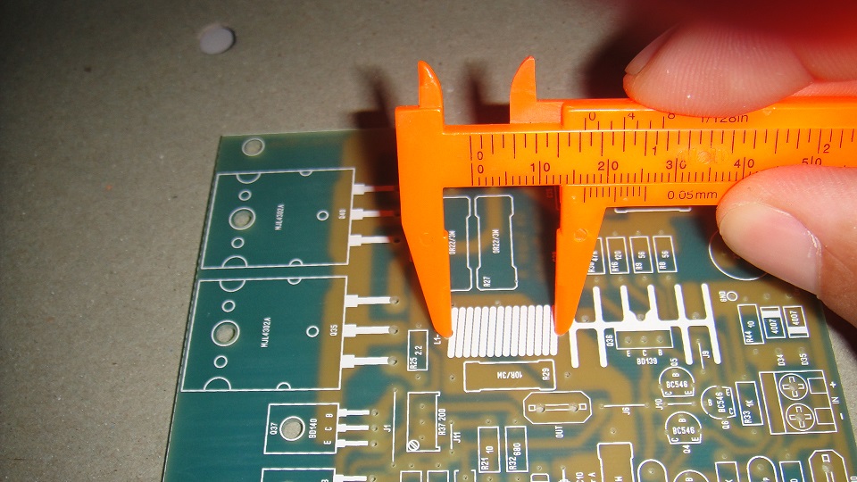

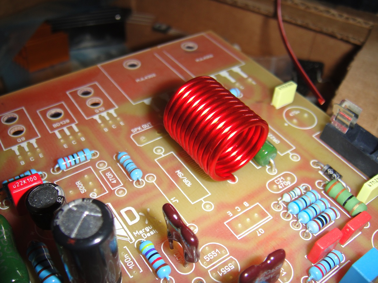

I think I am forgetting something, I do not recall having read on how to construct the line coil. I have here a #16 AWG what is the diameter and how many turns was it?
TY!
Hello abetir is actually 18 AWG but you can use 15 AWG too, I use a broken pen for a core, Carlos instruct 13 mm diameter, but I use a broken pen for my air coil filter looks more "organize" but you do it the way you think make you happy, actually I was checking the coil and is 17 turns not perfect but is close enough, the red coil is from the Supercharger, so imagine how thick is this that wire coil is 14 AWG is a beast!, jejejeje, so you are not going to drive the amp to the extreme so 16 AWG wire is just perfect, so 16 AWG nice will fit really nice, maybe you can get about 16 turns the wire is going to be a big thicker so probably less turns, maybe the diameter has to be increase so the wire length compensate the turns lost. "I know there is a website that calculate that but you know that is to the extreme" is 1uH.
Regards
Juan

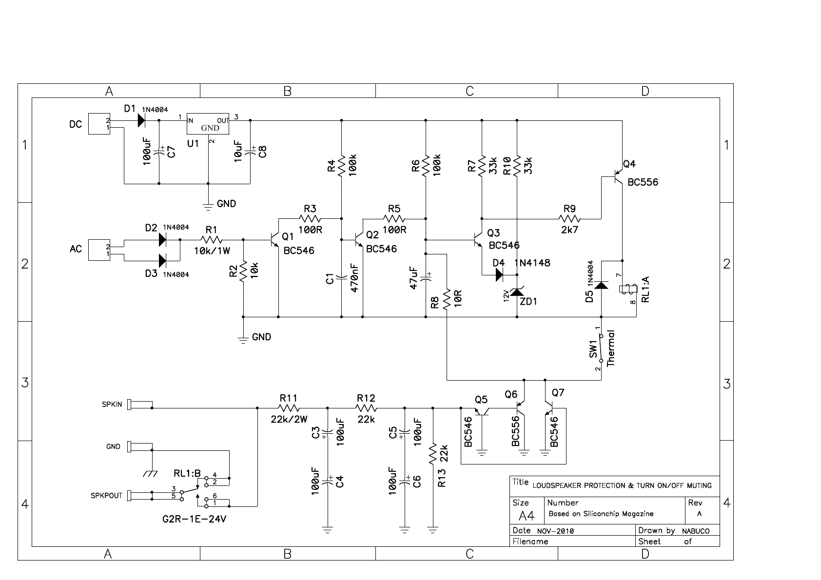

Nabucco Speaker Protection

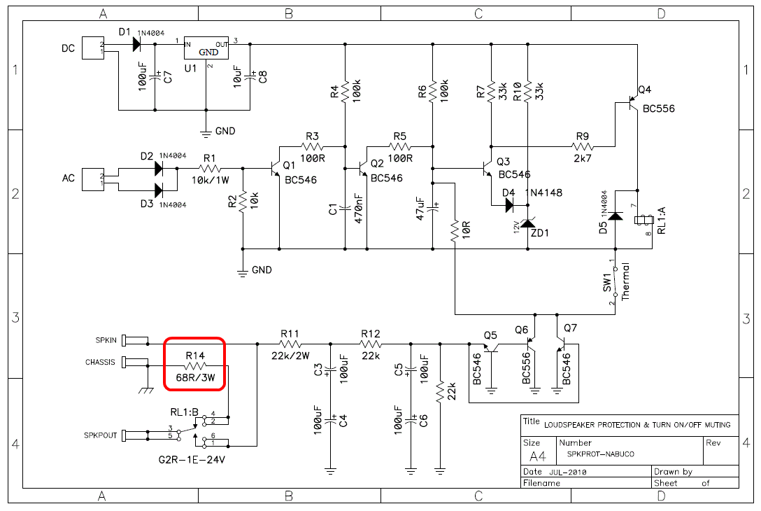

Hello Carlos!
For the protection of my speakers with the SA DX-I realize your protection but I noticed two slightly different versions, one has an additional resistor connected to ground.
There a version of preference?
All the best 73's!
Miguel Nabuco (Mitchel in this forum) is the one made, or copied, or adapted
this circuit.... we made an agreement he would be responsible by this circuit.... so, he will give follow up about surge protection and speaker protection.
I have some knowledge about audio amplifiers ... i am such kind of old folk that use fuses instead of these protections, this way i feel myself unable to clarify to you, as i have not created, designed, copied or adapted this design.... my know how about is very limited.
Having questions go directly to him that will be happy to answer you.... please, send these images to him, and a text explaining your doubts and he will return... he can understand english very well.

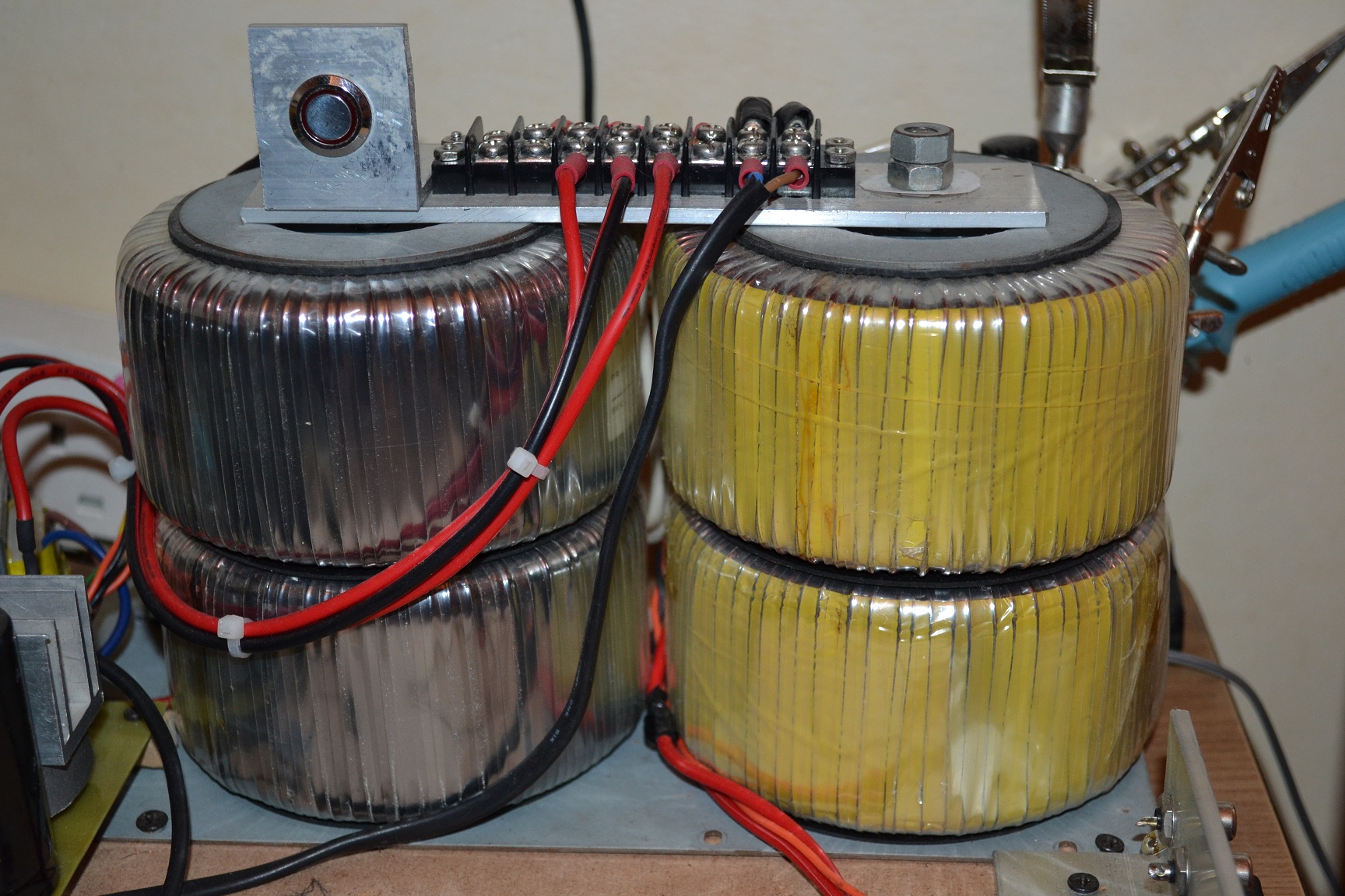

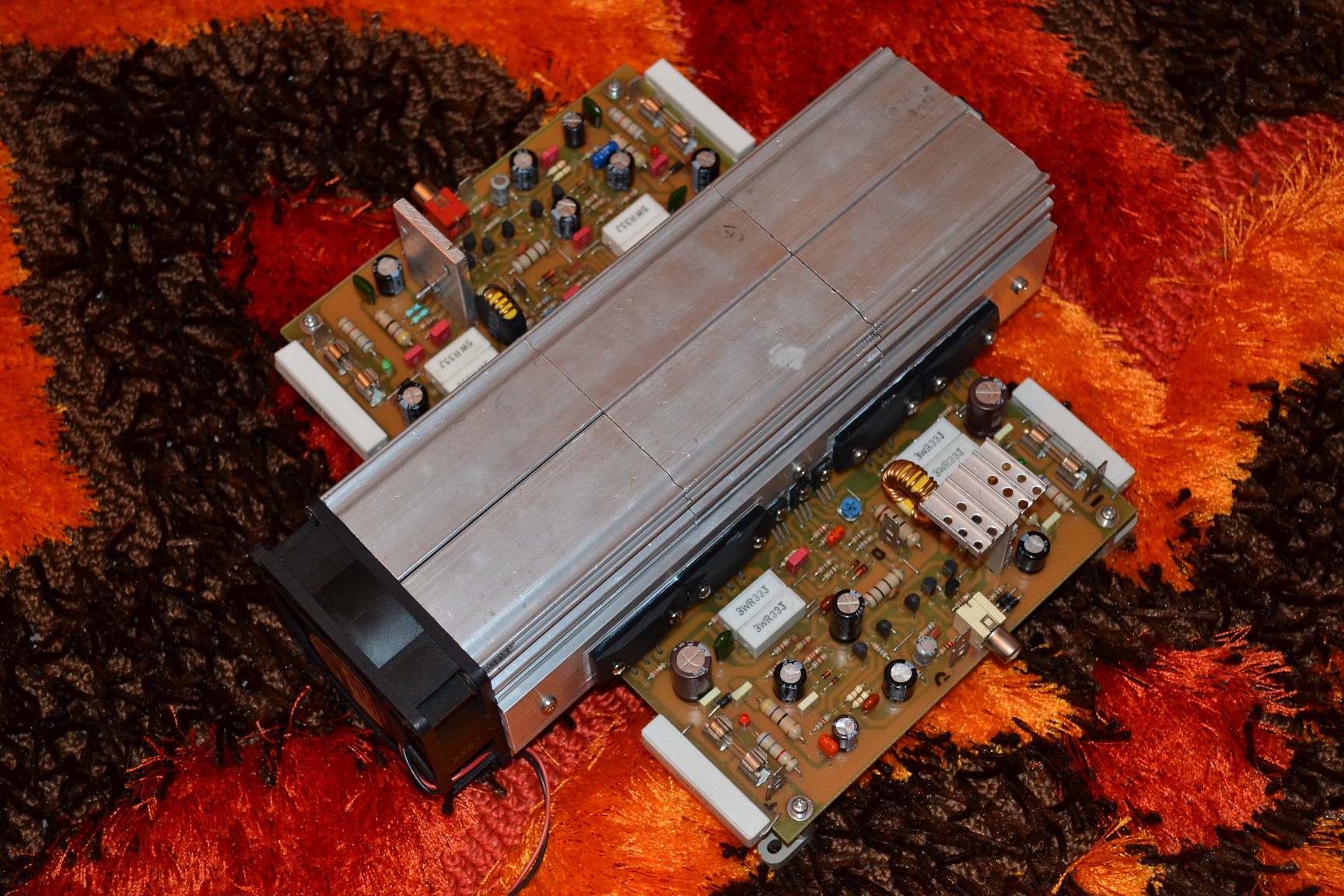

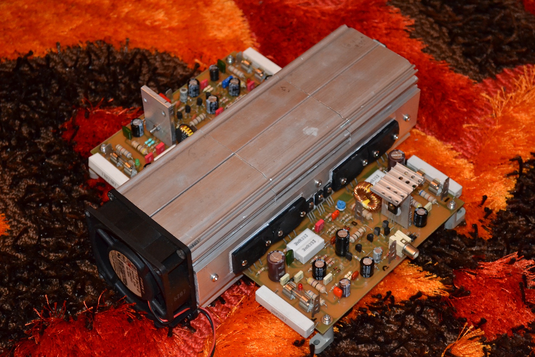

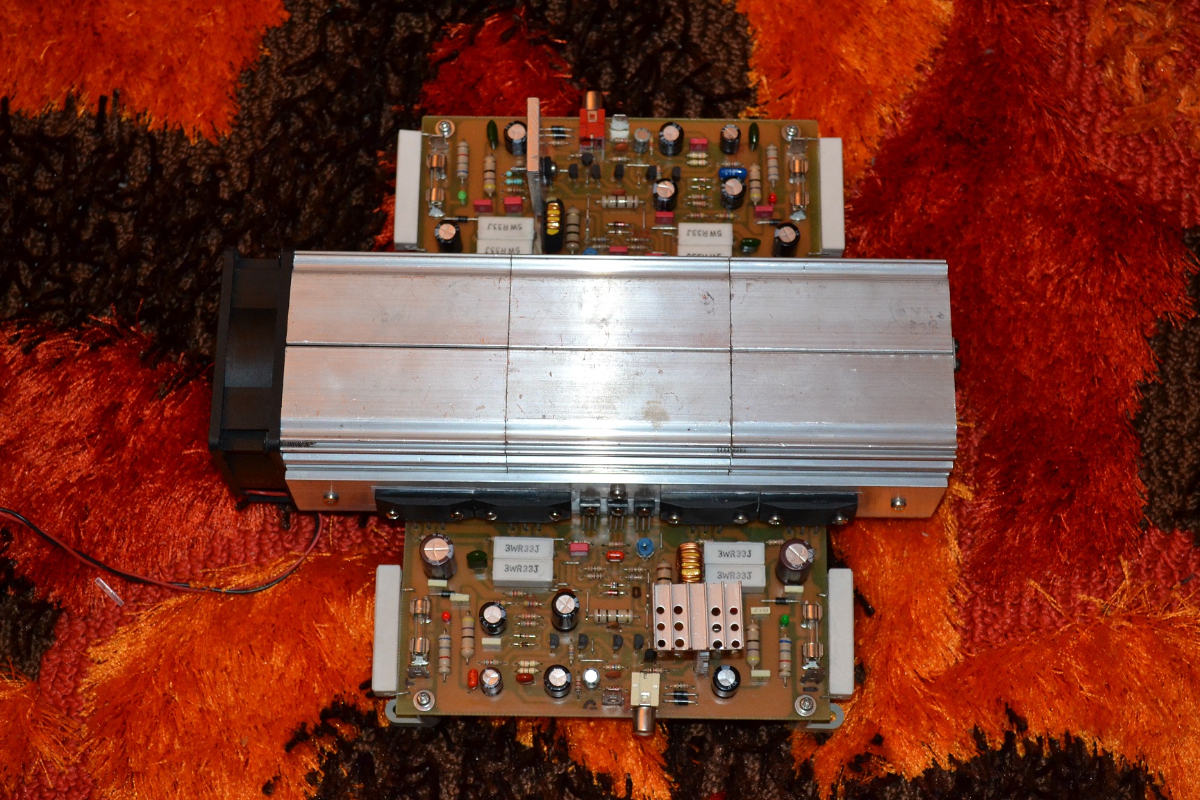

Finally Dual Mono are now mounted on the Final Heat sink
With tunnel cooling fan, both are tested and ready to go……
Toroid’s transformers are just waiting for the DX PSU regulator…
Love it….😉

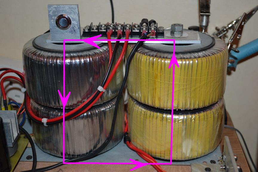

Hi wiljj78.
on your picture of your´s toriod supply.. does the metal plate under the toriods touch the two bolts you use for holding the toriods together? if so the two bolts and the metal top plate will act like a big shorted winding!!!
regards
uglykid

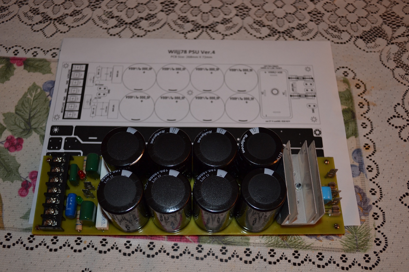

Yes Uncle Charlie I'm waiting Zimmer layout
Each toroid’s 29VAC/300VAC in series to get 29-0-29VAC, at the moment I’m playing my Stereo Super A using my ordinary PSU and I like the sonic very much, I’m not on hurry to build the DX PSU and I can wait till you finalize it with Zimmer, Take your time uncle Charlie no worries.
All the best….
Wiljj78

Willjj782, did you isolate the nuts and bolts of the build of the transformers?
If not, then you are introducing an additional secondary transformer winding, painted pink. This is not good!
Best regards - Rudi

Hi wiljj78.
regards
uglykid
Yes, they touch in all plate and your right in my first installation i face this problem, the metal plate and the transformer it self get's hot because it acts a shorted winding... but i found the solution with that in order not to act a shorted winding and now they all works fine without any problem.
