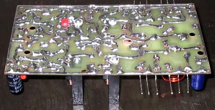

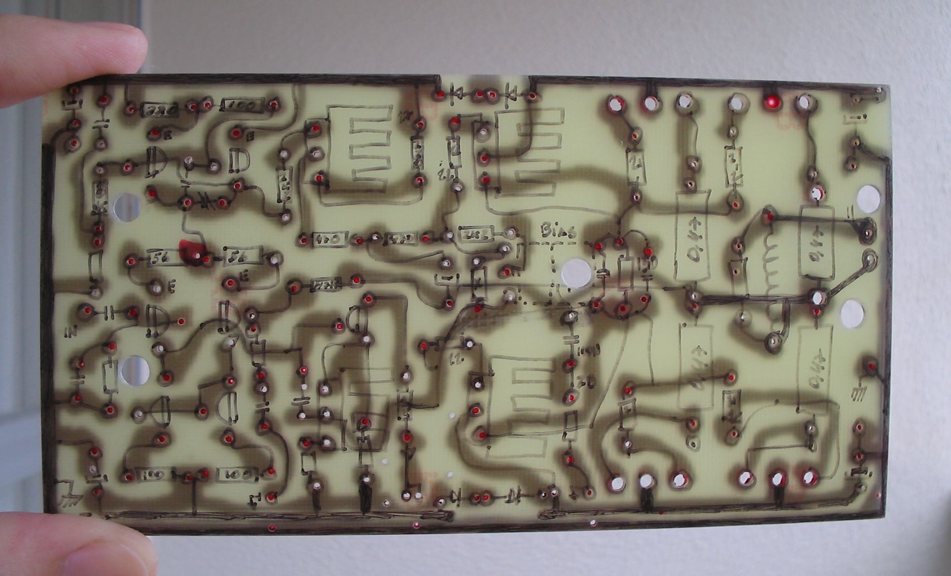

Some more pictures.

Oh! finally a friend recognize this is a nce diy way to do things
Exactly...all i need is a nail polish and copper boards...no computer, no board manufacturers...only hard work.
I have waited 20 seconds to rtch this board, and copper was thick...because of the chemical i am using...50 percent of hydrogen Peroxide (grade 40 of agua oxigenada) and 50 percent of hydrochloric or muriatic acid or spirits of salt
Thank you as you have made my day.... please inform your country my dear downranger.

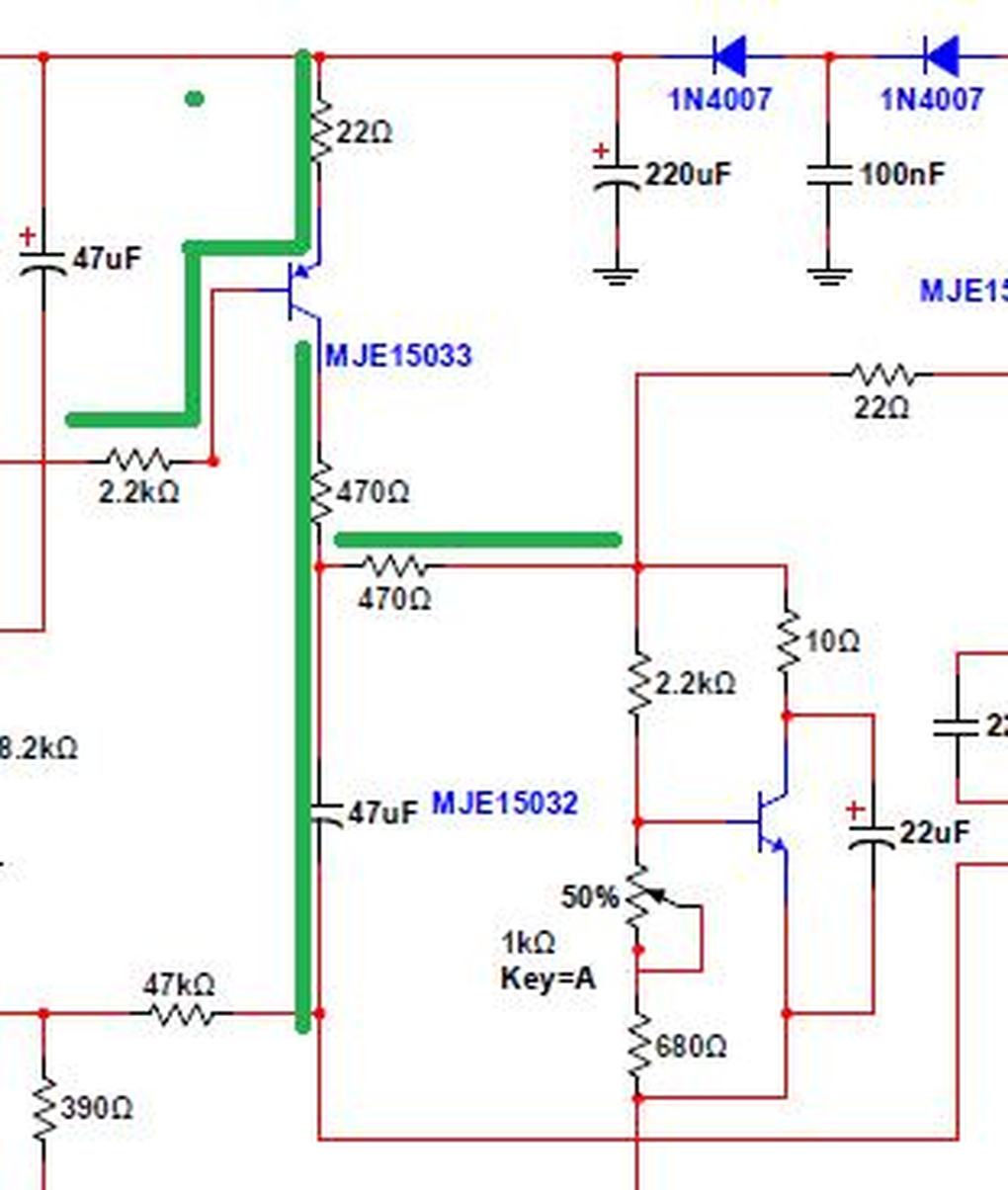

Carlos,
I notice you now use 1k collector load on VAS buffer device - to protect from destruction during clipping. Did you consider option of connecting the collector of this device to the output signal instead ? The output is nominally at ground, but when the VAS is most in danger is when the output is negative clipping and then the voltage on VAS buffer collector is low enough to prevent destruction. There is some impact on sonics, but it makes your VAS more bullet-proof and this idea is also patent free 😀
Good idea...i do think i have used for the Troyan, a more standard
darlington style VAS....thank you dear Bigun...now it was made...i left a couple of days waiting for suggestions, but now i put the machine to work.... in other words, the modification season finished.
I will try your idea to the next design. because becomes confused and troubleb when we have to change things, schematics, bom, pcboard layout and so on.... also when we have version 1.0, 2.0, 3.0 and so on.... this confuses a lot...i prefer to finish, to end and to start a new project.
Thank you very much..i was waiting Andrew T to say something...he said anything then i closed the design this morning and said to Alex to run the black and white images and post them in order to allow people to produce boards..so...no more changes...but i do like very much your idea and i thank you very much...i gonna check it in the future and i may use it and will say people the idea came from you.
