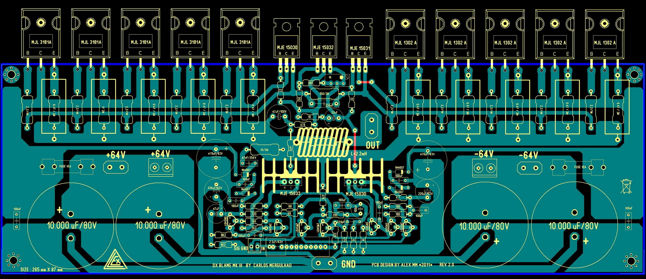

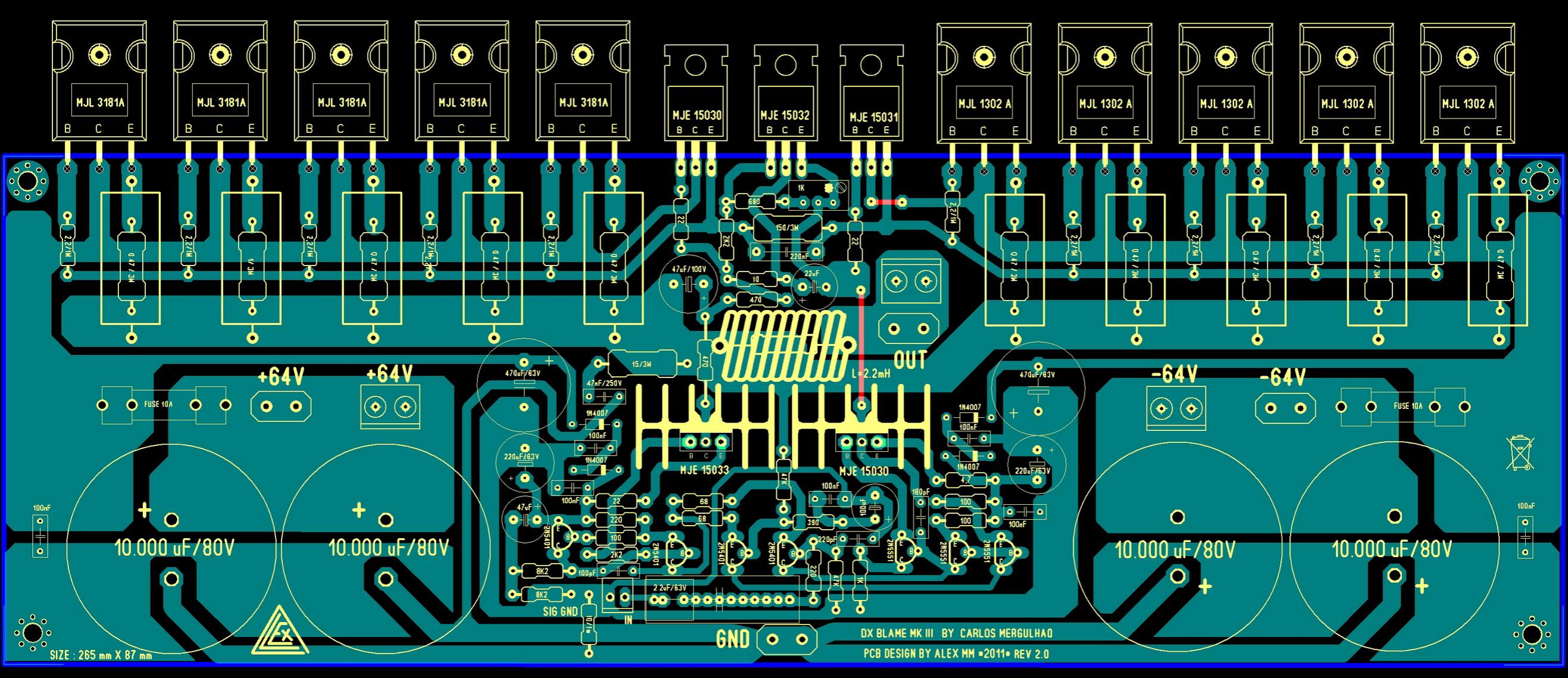

pcb last rev. acording new schematic
..... I'm ready to show you latest PCB acording schematic posted by designer .
Alex .🙂
Thank you very much Alexandru (Alex mm)
Nice board....and you have made it very fast, as usual.
Let's wait a couple of days to see if we gonna have interesting suggestions, it is already time to tweak a little as no one have ordered boards, so, modifications can be included in these board layout your are producing without too much sufferings to us.

PCB with Power GND and signal GND .....
.... this time I made thinks much better , I have split the GND exactly in two, power ground and signal ground as Rudi Ratlos sugdested in PM .Thank Rudi
Alex.🙂

This amplifier has not lifted ground to input..you see
the input ground is the same ground you have in the output...the speaker terminal ground, called negative or black wire, is the same input ground, that is also the transformer secondary center tape... a system's ground.
I do think this may work better to lifted ground amplifiers alike the Dx Blame ST that has a 10 ohms resistance to the power ground...so...special input ground...in our MKIII Hx ground is the same...but no problems to make this way....if this may not help too much...also cannot be bad.
Thank you,
regards,
Carlos
yes , it will still work.
Thank you,
regards,
Carlos
But not as good. 😱 Charging pulses of the large capacitors are quite big at the leads of that capacitor. With dual supplies and two exact width and length traces going to a center point is like 2 L/C filters to that point. At the center point the (pulses) tend to cancel each other out slightly... to a point. Add to this another 10R resistor plus the capacitance of the input stage component's .... this is another R/C filter. You are basically filtering your ground like you would do for your amplifier rails... and YOU can't say that is not important !
Another advantage to the resistor is that it will filter any RF or line noise (on the ground) from the sensitive input stage , the house ground return can pick up PC PS switching pulses , CFL's - as it is just a big antenna , as well. This is worse on a toroid trafo than an EI core. On both types of trafo's an AC line filter is a good thing to add. If the amp board has a separate power supply board , this is not all bad. The added wire has more inductance , but at the same time can pick up other "garbage" by the fact that it exists. So , some OEM's (and DIY'ers) put the cap's right on the main PCB. This is good provided that you isolate the sensitive VAS/input stage from them (pulses). Most OEM's will use larger local decoupling (R/C) and a better grounding scheme when this is the case.
Think of ground as yet another signal path , not 0v. 😀

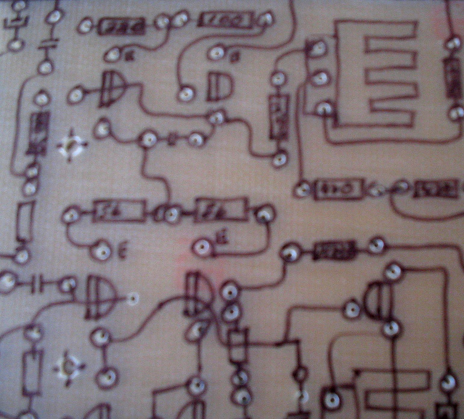

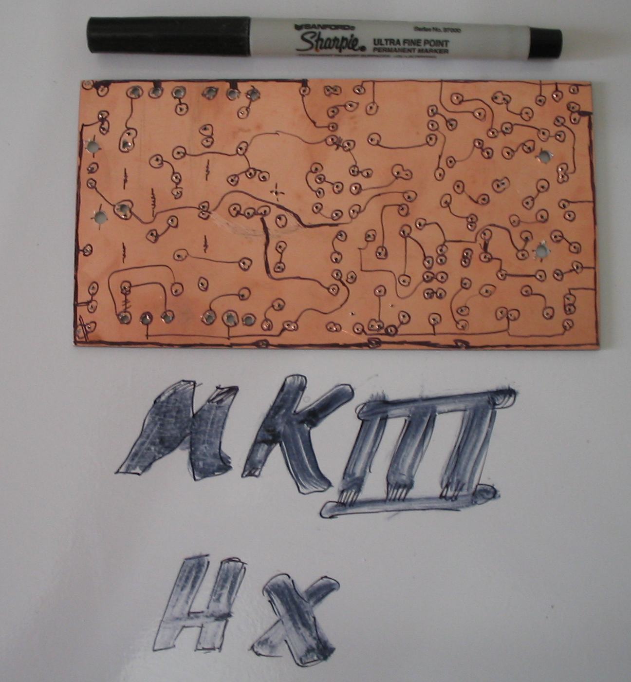

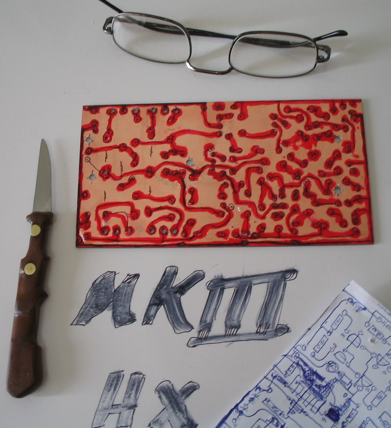

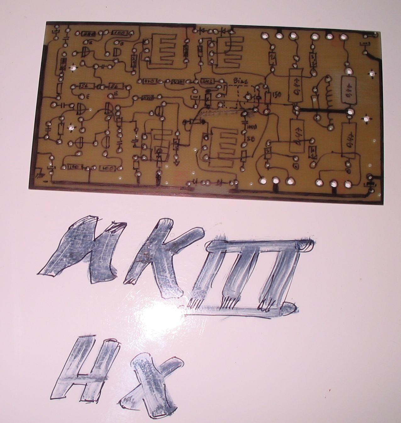

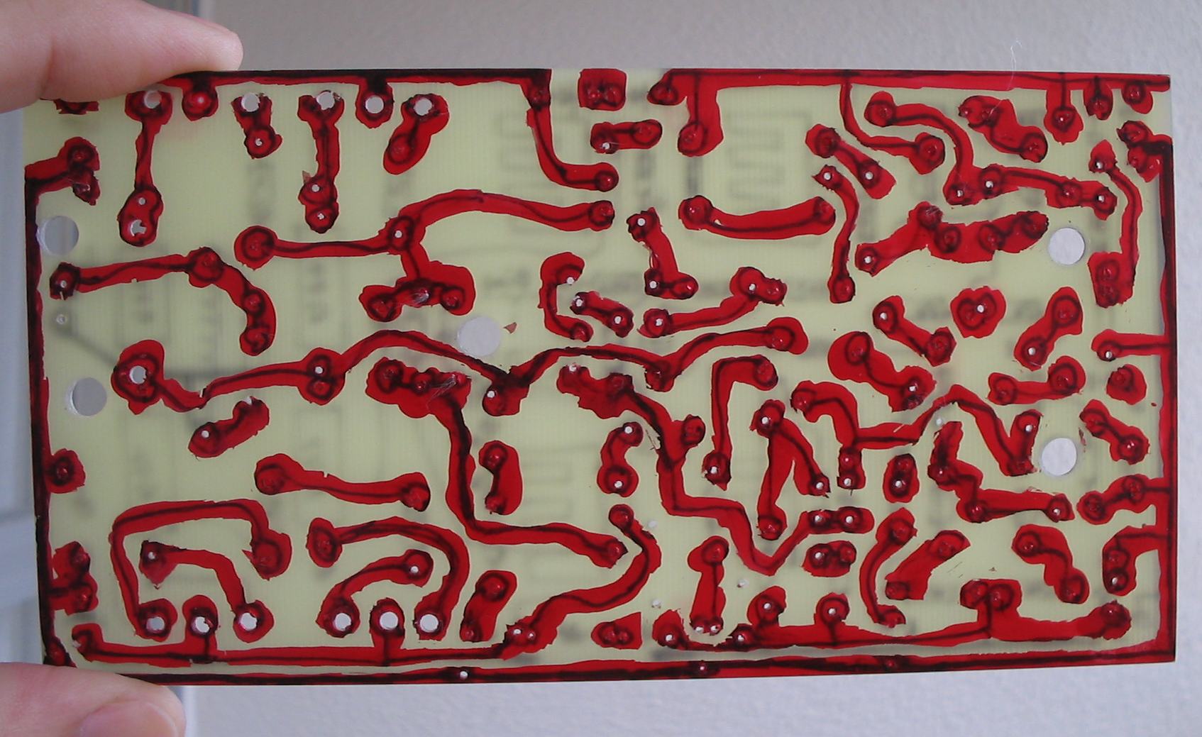

I do think i am getting old.... delaying to much to make an amplifier
in the past, 2 to 3 hours was all i needed to make layout, produce board, etch board, assemble and test...now a days i am spending this time only to produce board.
60 years is really old folks...uncle charlie now slow and lazy.
knife is to remove shorts in between tracks... we spend less time painting thick lines than trying to make them thin and perfect...time removing shorts is less than 5 minutes...so..we save time with the method.... the copper lines are made watching both board sides flipping it constantly, once a second...then you compare what is painted over and the need to trace lines to connect dots.
regards,
Carlos

Why don’t jou use iron and laser print
