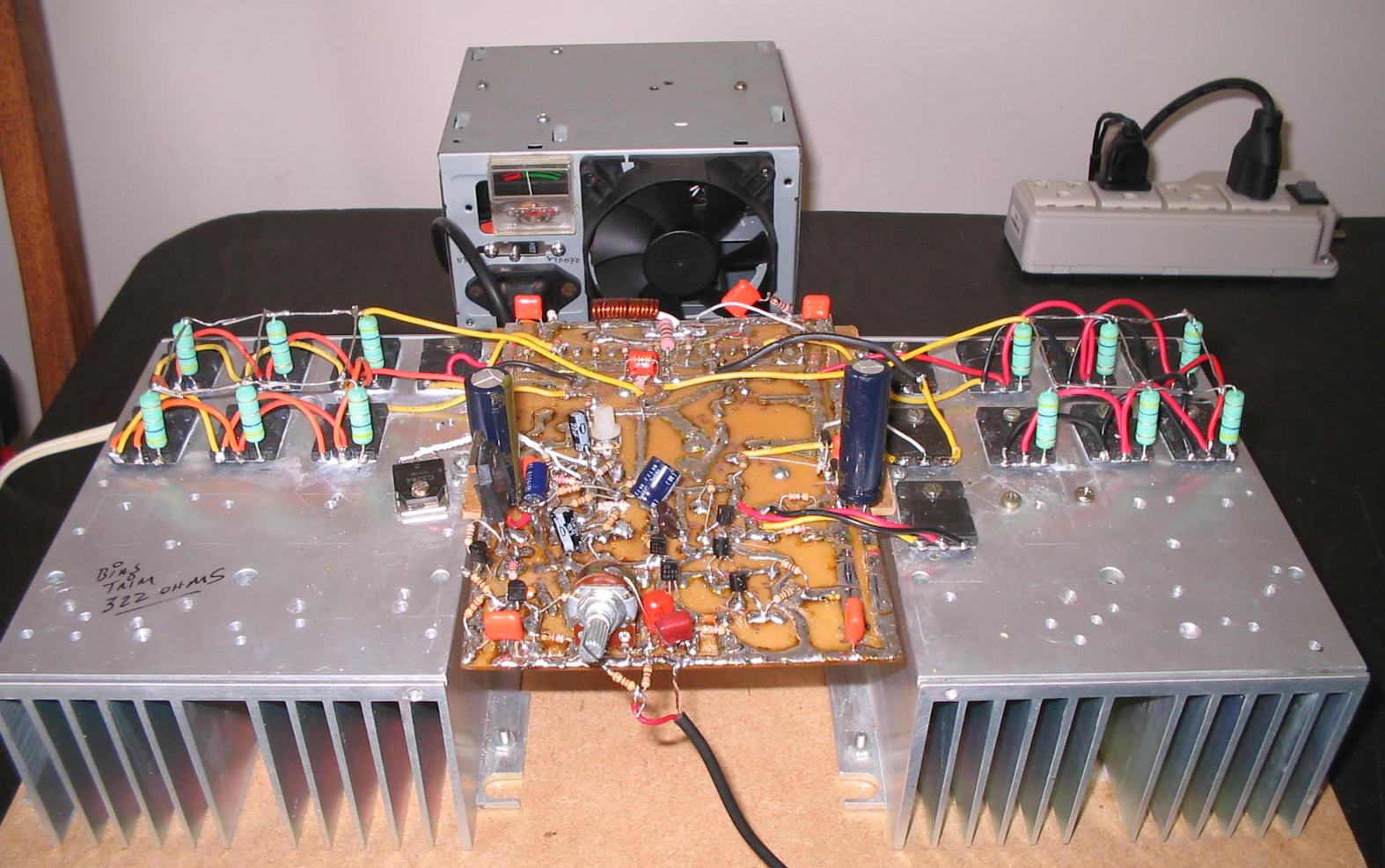

Here you have prototype assembled
A low power test.... soon i will make the high power test and will publish video...sorry by the quality, i am in a hurry and i cannot edit and spend time with it.

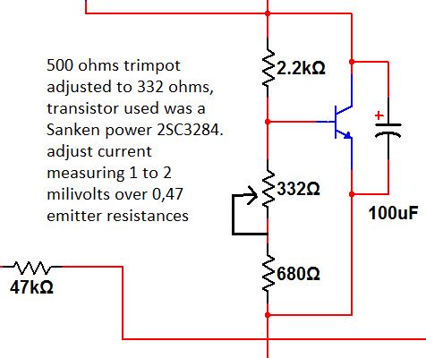

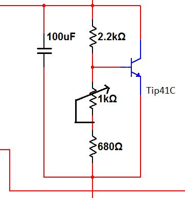

I have found something different from the schematic
I have used other values into the bias circuit.... total resistance from base to emitter seems to be around 1200 ohms.
I have also used different transistor, a TIP41C that was in the front of my eyes in the junk box, watching me and asking me to be used..then it was installed (hehehehe).
I will check this better tomorrow, then i will use another transistor for bias, will try to find a plastic one that gonna be better, also the supply voltage will be different..then i gonna check the stuff with more precision.
For a while, if someone decide to assemble, them use 1K trimpot in series with 680 ohms resistor..this may work fine.
We gonna see the final value after further testings... also i need more power, more heat, to observe thermal drift... do not assemble for a while if you intend to do.. wait a couple of days please.

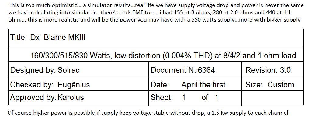

I have tested using 1.1 ohms....i could have something around 400 watts RMS.
It is a 150 watts at 8 ohms and go increasing power depending how huge is your supply.... i am uploading video and then you will have some more details...will take some time as i have to edit, trancode and encode into youtube.
Final setup for bias is the image attached...be plugged into this thread..soon you gonna have the video link here.

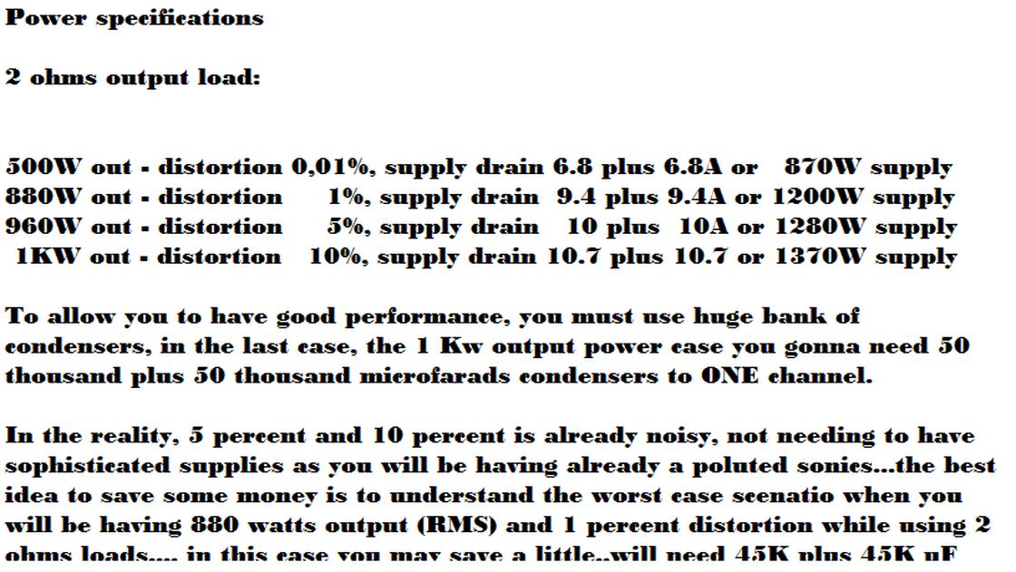

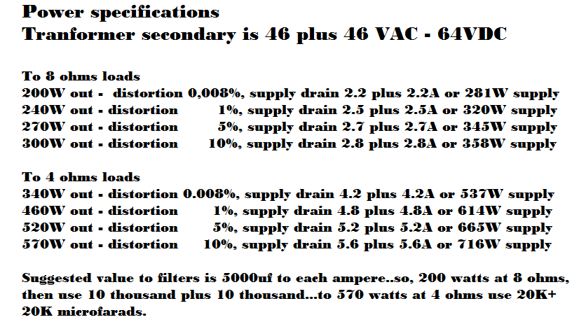

MKIII specifications from the simulator and power supply requirements
The video explains in details... there are two parts...here you have the link to part 1:
YouTube - MKIII amplifier, specs. and power supply requirements - part ONE

MKIII specifications from simulator and power supply requirements
Part two:
YouTube - MKIII amplifier, specs. and power supply requirements - part TWO

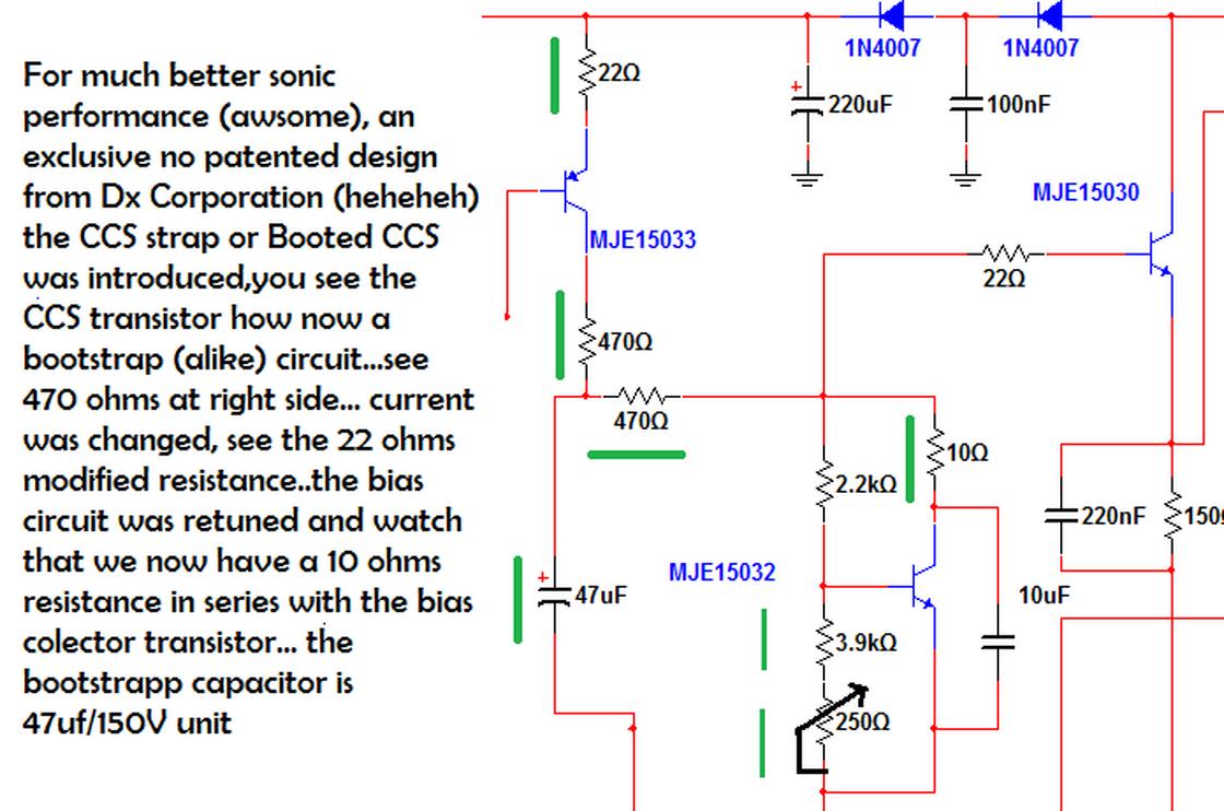

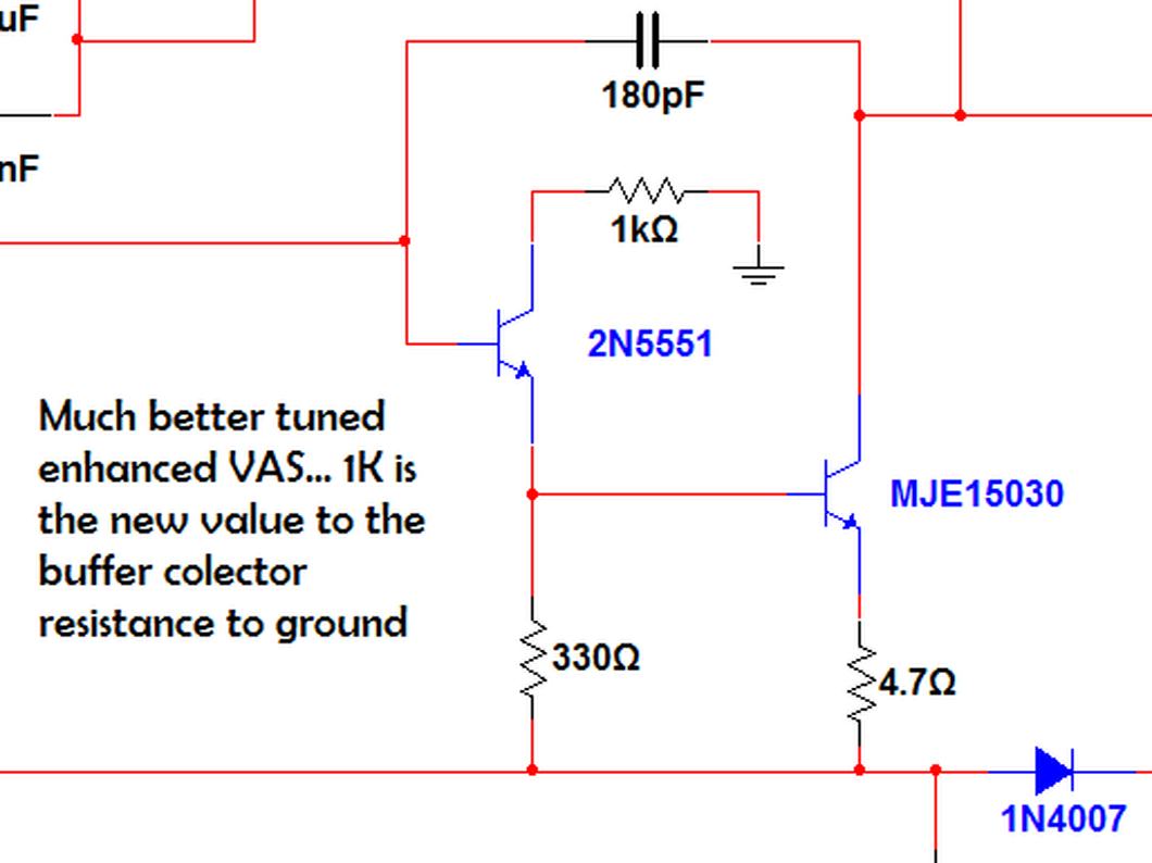

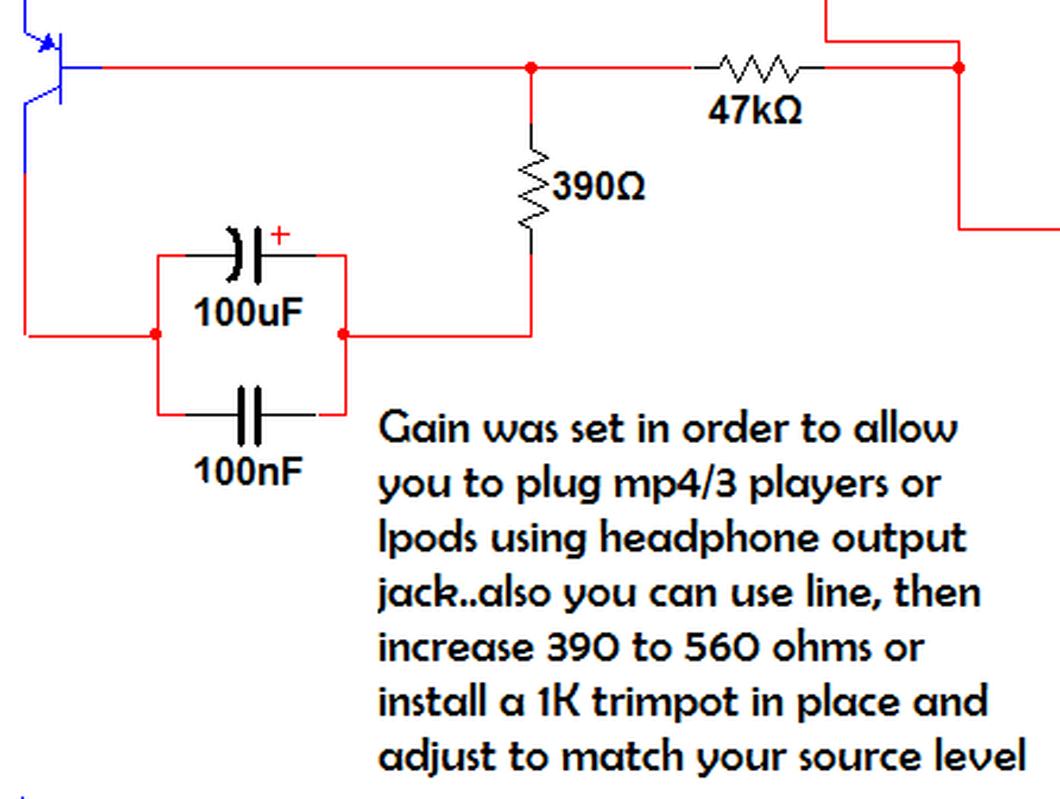

MKIII Hx model was the result of some tuning made
Now sonics are the best possible to this schematic, Alexandru will prepare new boards as i have made some changes, and they are described in the images you will see attached.
regards,
Carlos

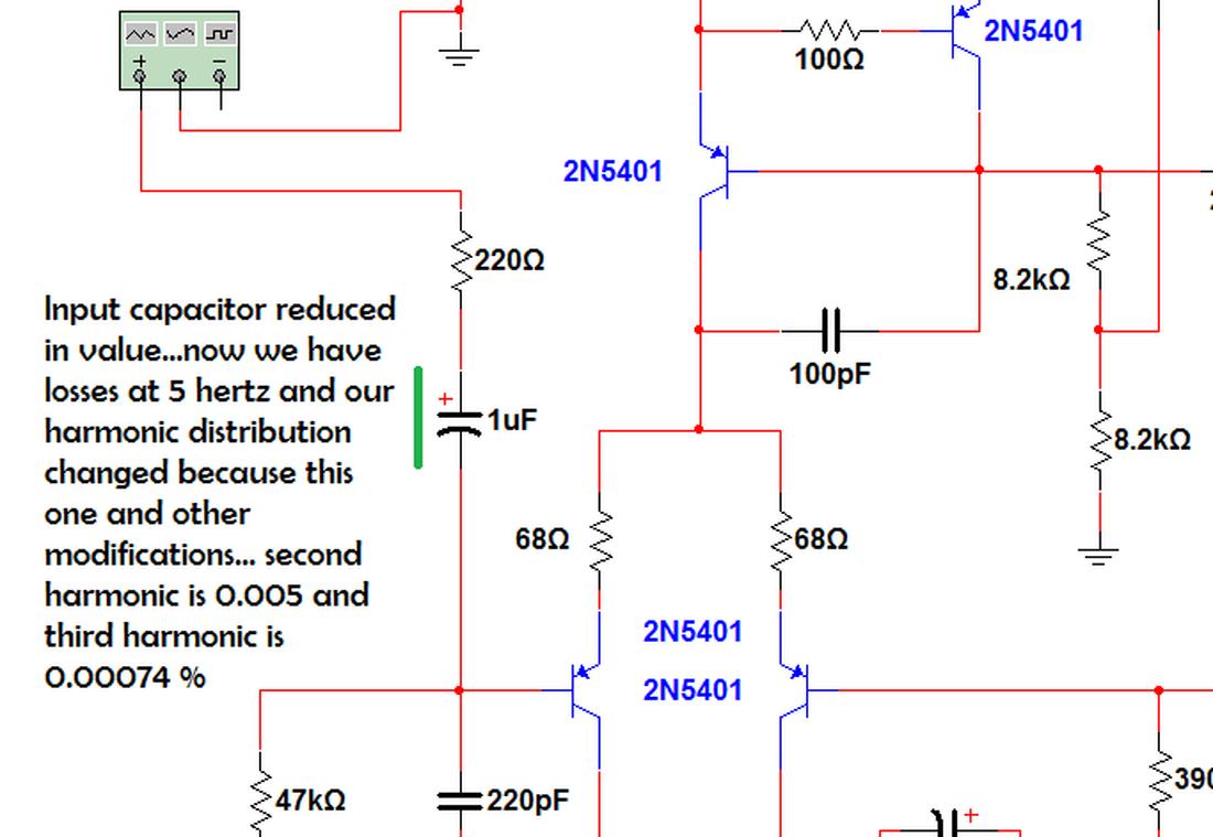

Here you have more realistic values to the bias control
Schematic attached,
The circuit was tested naturally, as it was tuned listening.
regards,
Carlos
Schematic attached,

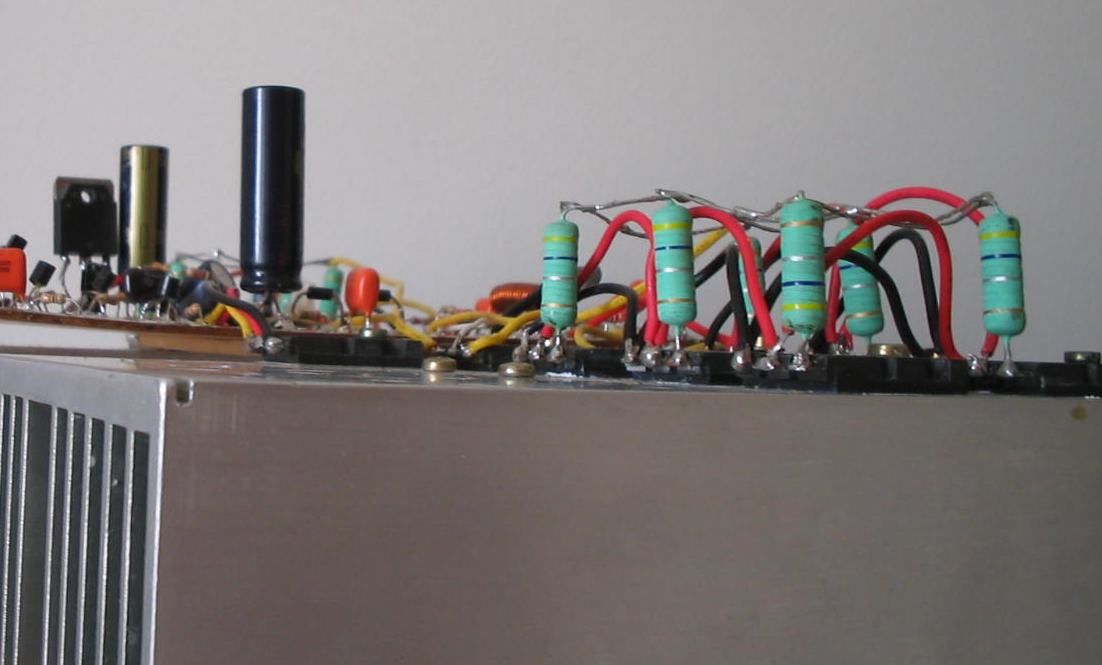

Hx is a hair raising amplifier.... produces strong emotions
YouTube - Hx is fast, a very precise audio amplifier
The prototype is ugly, but sonics are beautifull.

I like the vertical emitter resistors.
Makes the assembly look like playing 3D chess. Not I could ever cope with playing 3D chess.
The component values in this latest schematic are starting to resemble good design.
Am I allowed to suggest a few minor adjustments that might result in further improvement in sound quality.
Come on!Am I allowed to suggest
Who will forbid you, AndrewT?
Is there anyone who can or will stop a good suggestion?
