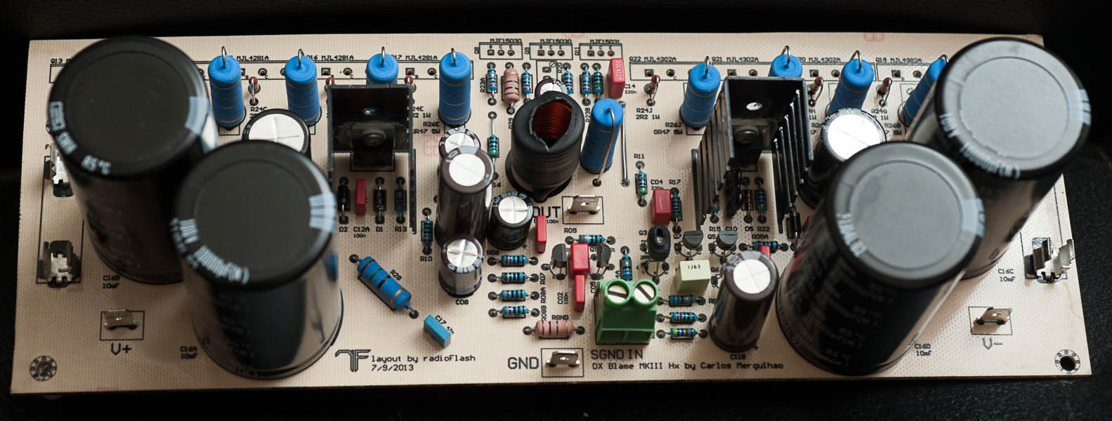

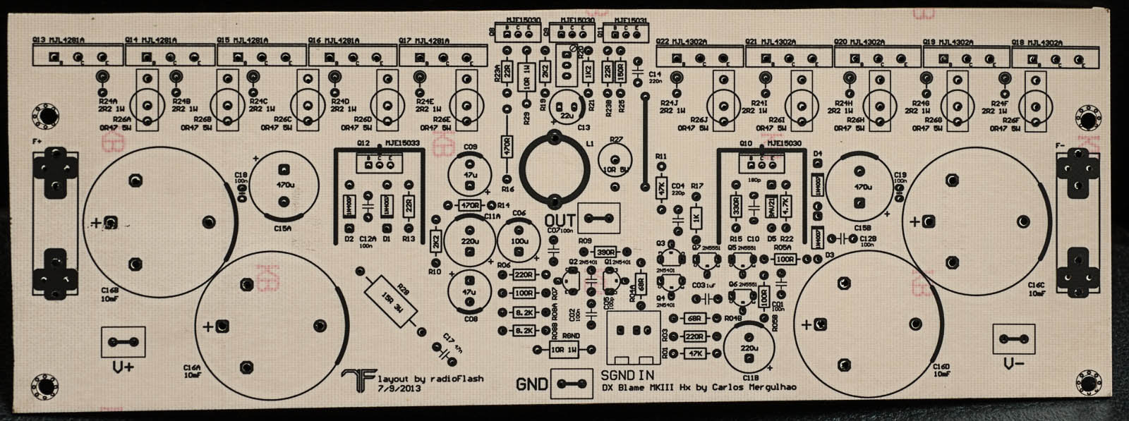

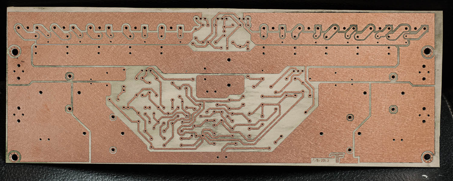

I've been working on populating the board. I noticed I had a missing track for R08A to R08B. I also increase the hole sizes for some of the electrolytics. Attached is a PDF with some of these corrections.

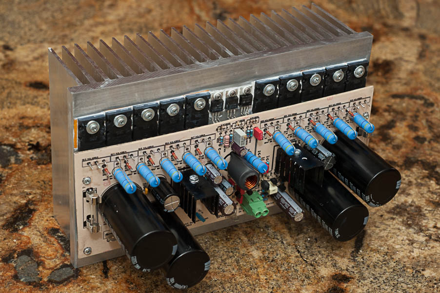

Yess very nice indeed... But i'm thinking on Q12 and Q10 Heatsink are enough to handle the heat if R13 used 22R??
It looks nice Newton. Do you have a chassis planned for it?
radioFlash not yet, but I'm thinking of a model.
><>Newton J. Costa<><
Thanks for your kind comments vargasmongo. As for the the heatsinks on Q12 and Q10, they're rated at about 7°C/W. I'm not sure what the power dissipation of Q12 and Q10 are, so I'm not sure if that's sufficient.

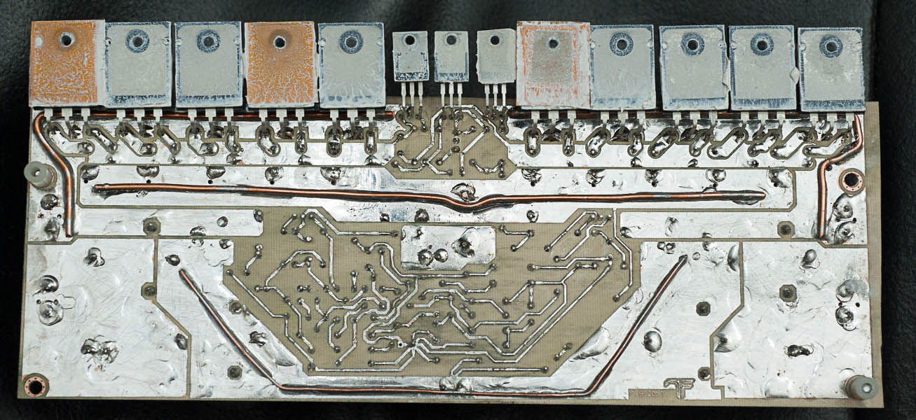

I finished installing all the components on the board using my layout and turned on the amp using the lightbulb tester and no load connected and a +/- 40V power supply. The lightbulb flashed as the caps charged and then went out, but I see +35V on the output without any input signal. The oscillocope shows DC. The good news is it provides another "learning opportunity" for me!
So far, I've done the following in-circuit checks with the amp powered off:
* Set VR midway
* No short to heatsink for output transistors
* Inspected soldering and did continuity check--did not find any shorted tracks
* Verified correct transistors installed in correct locations
* Diode check Q12 ok (b to c, e)
* Diodes 1n4007, BAV21 ok on diode check
* Checked all transistors, no shorts
* Did not note any unusually hot components or observe any obvious physical damange such as scorched/smoking resistors or capacitors
* Checked resistor value R10-correct 2k2
* Checked orientation of electrolytics-ok
* Checked continuity of rails to OP transistors: only saw continuity with collectors as expected
