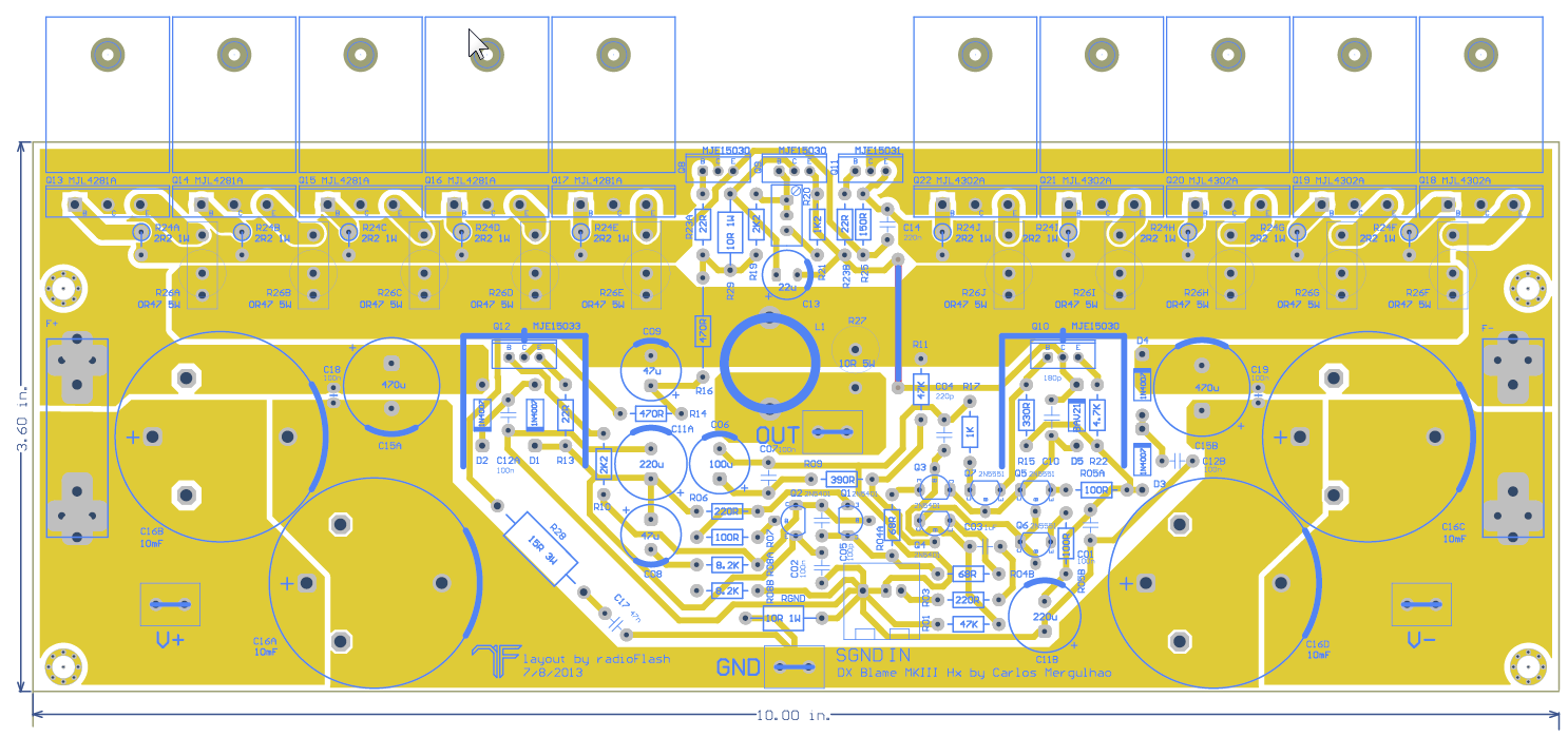

radioFlash,I like it nice layout

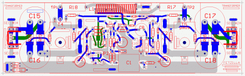

Can you provide the possibility to use the MPC emiter resistors?
Thanks. Here's a version that would support an MPC resistor with 10mm lead spacing. It's based on the footprint of the TE Connectivty resistor
(HPR5RSR47J Product Details - TE).
Nice,that's what I mean.What software do you use?

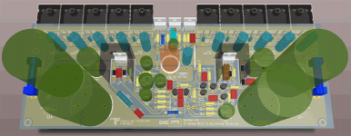

I wonder, if it's not better to put a resistor between the two psu caps to reduce the charging current?

I've done a groupsbuy of this amp together with Byronlawrence and Alex did the layout.I realy like the layout from radioFlash.Maybe there is a new groupsbuy coming up with this layout.
Fitter maybe,me personal don't like those big caps direct on the boards due the charging currents,I could be wrong.What purpose ...?
