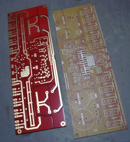

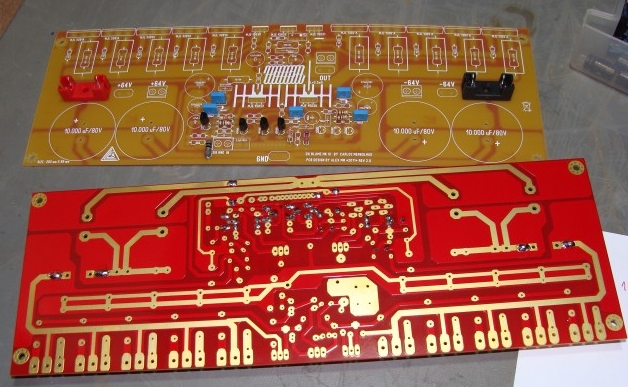

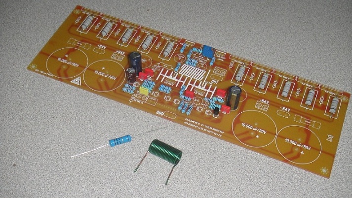

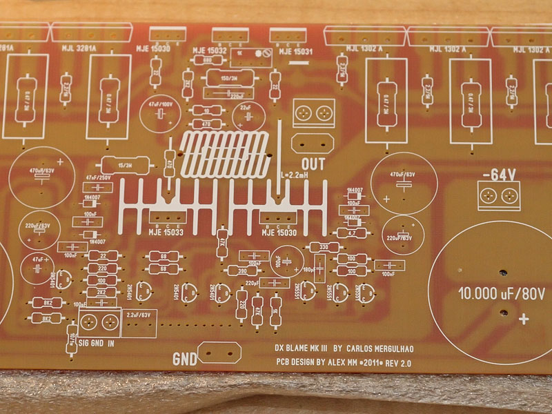

Board a different version?
The boards Junie got are marked V2.2 and the ones I got are Rev 2.0... What are the differences? They're from two different orders?
Martin.

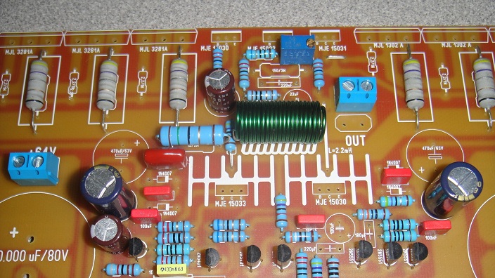

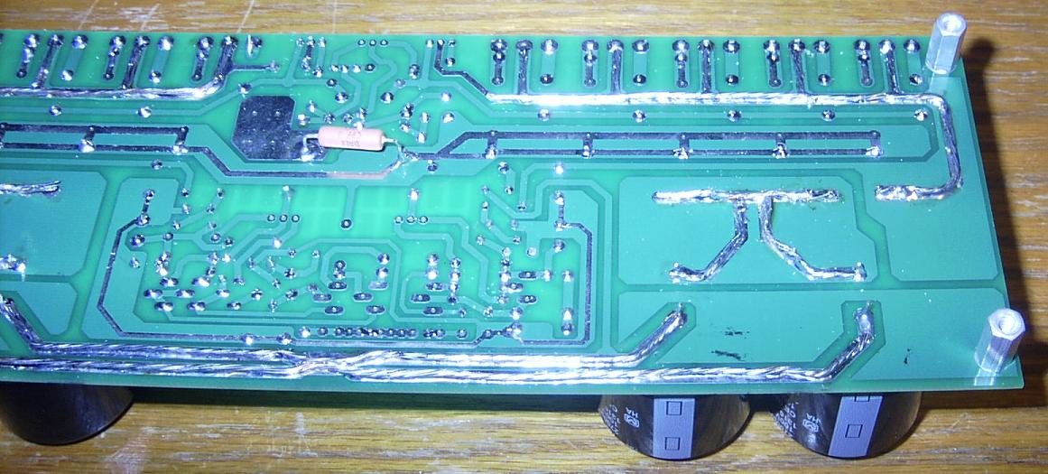

OK. If Junie is going to show off photos I'll show off mine😛 But my camera is not nearly as nice as is Junie's.

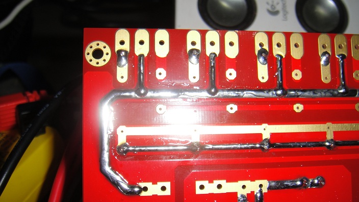

I'm still waiting for those heatsinks I ordered weeks ago! I soldered 14awg wire to the high-current carrying tracks.

I thought about that, adding to the power traces ......What value inductor are you using in the output , where did you get it ..?
I decided the inductor value was not very important. I wound my own with magnet wire, then covered it with heat shrink tubing to keep it from uncoiling. I tried to use Dayton's WT3 to measure it, but its lower limit is 50uH, so I only know the inductance is <50uH.
I recall Alex writing that he left some tracks exposed so we could tin them. Adding wire is just overkill. My only advice is to tin the tracks after you add all the components.

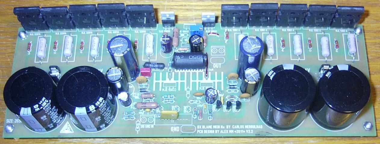

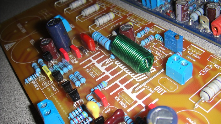

Hi guys!
I'm putting the parts little bit by little bit at the time and I think it looks great, don't mind the air coil inductor y like green lol thank to destroyer x, meanman64 and Alex all the people involve, muchas gracias de aqui de Puerto Rico.
