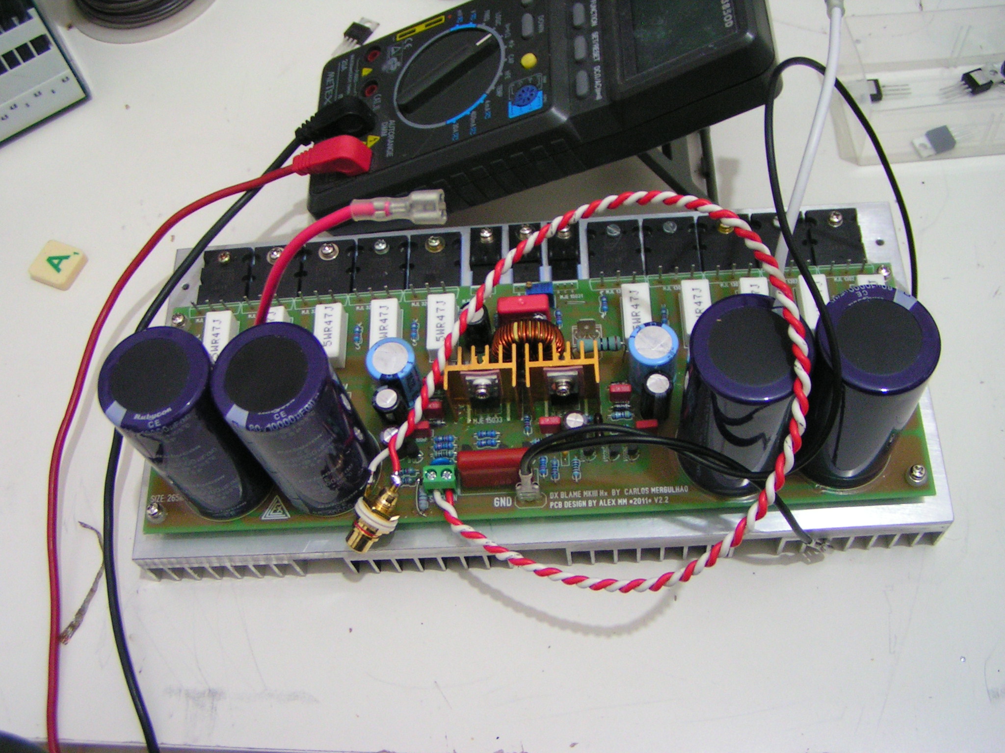

testing in progress....
With 73v-0-73V supply voltage rail to rail, I got 64V voltage drop in 100R/10W...damn crazy high, something is wrong with my build...
Where was your bulb tester at the time? In the cupboard, maybe?
I will use that bulb now Andy..
though this happen, I got no blown fuses, no burning trannies or smokies parts..maybe bias problem?

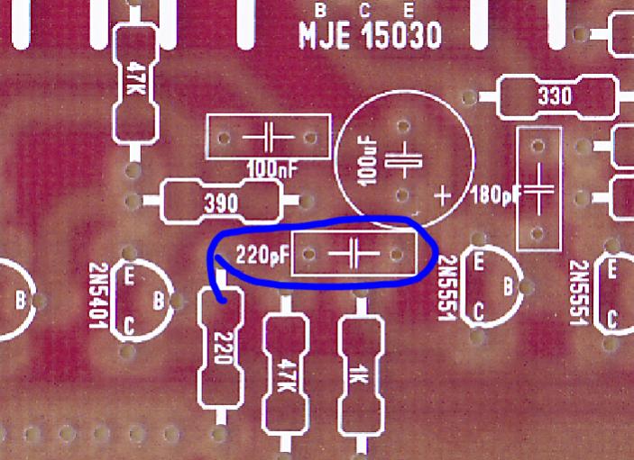

Hi mister Junie! did you use a 45+45 toroidal transformer? is about 63.63 45x1.414 close enough to 64VDC rail to rail, maybe is a solder, I always check that is so damn small that solder can ruin connection between tracks well that can not be because that can cause burning tracks, now you got me thinking what can that be uhmmm?
regards
vargasmongo
regards
vargasmongo
Hey Amigo! I don't have that trafo what i'm using now for testing is the trafo i'm using in my precision and it's working fine in there. I'm wondering what went wrong, this is really bad the two module are having the same problem.
WOW! they are different I just realize that now
Dear Vargasmongo,
Explain! what is different?

Is your bias trimpot adjusting?... say... changing current when adjusted?
Your current changes when you tweak bias trimpot?...if yes, then increase base to emitter resistance in order to decrease your current....if not, then search because you made a mistake..... you see that both amplifiers presents the same problem....seems the same mistake was made.
Be sure i have tested and i have tested with 84 volts supplies.... also i have tested with 4.5 volts, 12 volts, 20 volts, 35 volts, 45 volts, 55 volts, and 64 volts.. and worked fine in all conditions.
Check bias transistor position, check insulators, measure transistor colector and check if they are really insulated from the heatsinks.
Use a lamp in series with your transformer as your resistor will smoke soon and go searching...the mistake will be there waiting for you.... i am sure sooner or latter you will find it... relax...take a breath... take a rest...and go searching.

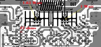

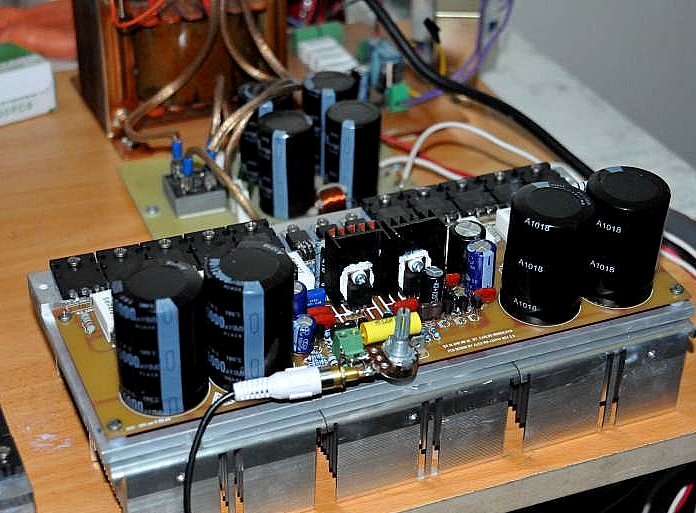

A friend from other forum told me these two heatsinks are reaching 52 degrées celsius
these units are too much hot... 52 degrées Celsius (Centigrades)... this is too very good.... better if you can keep these ones at 45 to 47 degrées.
A taller, or bigger heatsink will be needed for him to cool down these two transistors mounted in separated heatsinks.... they are lovely but small, not that tall as i was dreaming for.
The guys is using 68 volts supplies...... and the higher the supply voltage the bigger will be the problem related these heatsinks.
In my construction, home prototypes using standard supply voltage, i have not noticed heat there because these transistors where mounted into the main heatsink...but seems you may face some trouble because heat there.
Be aware you may have to replace these heatsinks for larger ones.

No, is about the MKIII green board and the red one the 220pF cap is oriented, in a different way that is all, mister Junie show me, that is way I say that, nothing to worry about I'm sorry I'm Puertorrican I get exited for everything
regards
vargasmongo
Yes, the board is very crowded. I recall moving some things around to increase the space between tracks and between pads a bit. the schematics are the same. I apologize for any panic I may have caused.

People that feel these 2 small vertical heatsinks too much hot can reduce VAS current in order to reduce heat there.... i have simulated and i found the original schematic fine... with the modification you will have changes in performance, but not that huge.
The 22 ohms resistor that sets the CCS current can be increased to 47ohms in order to reduce current...then you will have these transistors mounted into vertical heatsinks (CCS to VAS and VAS transistor) less hot.
I found power there not that big...the left one is the CCS transistor, CCS to feed VAS (Voltage Amplifier Stage) and it is dissipating 1.65 watt.... the rigth side one is the VAS transistor, the second stage, the most active unit, following the buffer and the power there, dinamic power, will be around 1 watt....not that huge power and the small heatsinks should fit in most of the cases... exception is when people is using higher supply voltage... say... really higher voltage.
You can replace the 22 ohms resistor by a 27 ohms, 33 ohms, 39 ohms or 47 ohms.... i suggest you to go to 47 ohms because will really cool down in order to work fine with tiny vertical heatsinks... with this resistor replaced, the performance when using low impedance output loads will clip earlier.... some loss in power...not that huge, not that important.
Some high current. high voltage and high speed diodes installed into the output, in the power transistors, from colector to emitter, can be used too as we gonna face some back EMF there.... so, if you intend to push the amplifier hard, then search for high speed, high current diodes used to fly back purposes there...what model to use i cannot suggest you as i do not use them, so they are not familiar to me... search for high power amplifiers and copy the diode model to apply to yours....this is to play heavy metal, full power, distorted sound and connected to 2 ohms loads... an extra protection if you intend to operate your amplifier above the limits, entering distortion and draining huge ammounts of current and generating enormous output having a lot of back EMF in your output line.... normal civilized use will not need these diodes.
If you decide to use alike dB competition of bass, operating in clipping mode..for sure you will need these protective diodes.
Enjoy your amplifier boys...sound is awesome and you will perceive that instantaneously.
