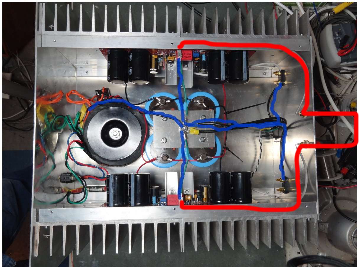

Common PSU is conected to two amp modules, and input cables shields are than conected again together.
I'm not sure what you mean by input cables shields connected again. The shield of my input cables are the ground wire for the input. it only connects to the RCA and the - input lug on the PCB. They become connected when the source is connected because the source plugs have a common ground. This is very common.
Ground loop, sensible to induction form magnetic fields. Transformer somewhere nearby. Result is induced current, causing voltage drop at cables shielding resistance, this is known issue.
I have the transformer as far from the input and output as I can.
Minimize loop area (twist input cables together, place power modules as close as possible) and minimize currents in input ground loop (use correctly 10R resistor separating power ground and input ground).
You lost me here. What power module? I did install the 10R resistors. No change.
Thanks, Terry
Exactly, and hum in such topology (common PSU, unbalanced inputs) is also very common because ground loop induced currents (voltage drop at nonzero impedance of cables shields is added to input signal). Power module = one channel of amplifier..
If You insert 10R in such loop (in each channel one independent resistor), shield resistance and 10R form voltage divider for such disturbing signal, and hum is much lower. To one end of 10R can be connected only input bias resistor ground end, input cable ground (shield) and ground point of NFB divider, nothing more! Other end of this resistor is connected to power ground (center point of PSU).
It can help a lot, but it is not the best possible solution (dual mono, independent PSU, or true balanced inputs..)

Terry, look at this.. You must break this loop (to reduce induced ground currents) with inserting 10R between power GND and input GND, on each channel PCB (interrupting PCB ground traces, some "modifications" needed)..

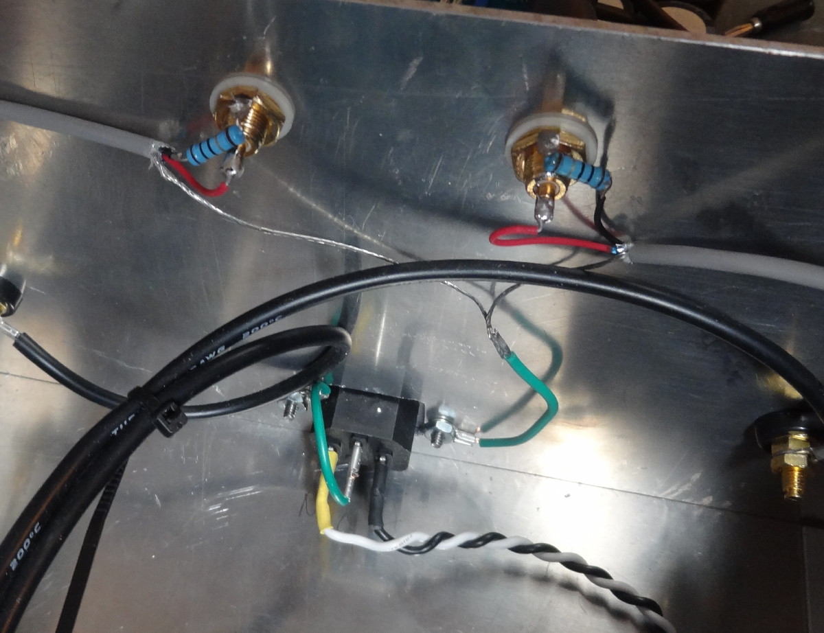

OK Guys, thanks to the kind help from all of you I believe I got to the bottom of it. The first thing I did was pull R30 and reinstall the jumper per Carlos' suggestion. Then I installed a 10R 1W resistor between the ground wire and RCA connectors and connected the shield to the case per BV's suggestion. That completely eliminated the added hum when attaching both sides from the source. I still had some noticeable hum so I disconnected the power supply and connected up my DX PSU with a 40-0-40vac transformer. The amp is dead quiet now. Looks like I will have to fork out for some new filter caps. 🙁
At least I know what it all was now. I would recommend installing those resistors at the RCAs. It is easy to do and really made a difference.
Blessings, Terry
Wrong, I never sugested that.. You only got lower level of hum, but for "blameless" function You need to change grounding (change PCB..), on upper side of 10R can be conected only R01, C04, C06, C07 and input cable shield. On the RCA conector the shield could be conected direct, and RCA (isolated from case) could by conected to case via 10R.
Sorry BV, didn't mean to misquote you. Regardless, adding the 10r resistors at the RCAs solved the problem and insulating the center tap from the case cured the rest. The amp is dead quiet now. I will not be modifying the PCB. This amp is finally playing nice so I am on to other things.
Thanks, Terry
I had to make one more change. Every thing was fine as long as something was plugged into the input but if nothing was plugged in, there was a bad hum. I had to short the input ground to the case to get rid of it. So my fix was to install another 10R resistor between one of the input grounds and the shield which is connected to the case. I'm not sure if a resistor is the best choice for this but it worked. If one of you thinks something else would work better here I am all ears. 😉
Blessings, Terry
