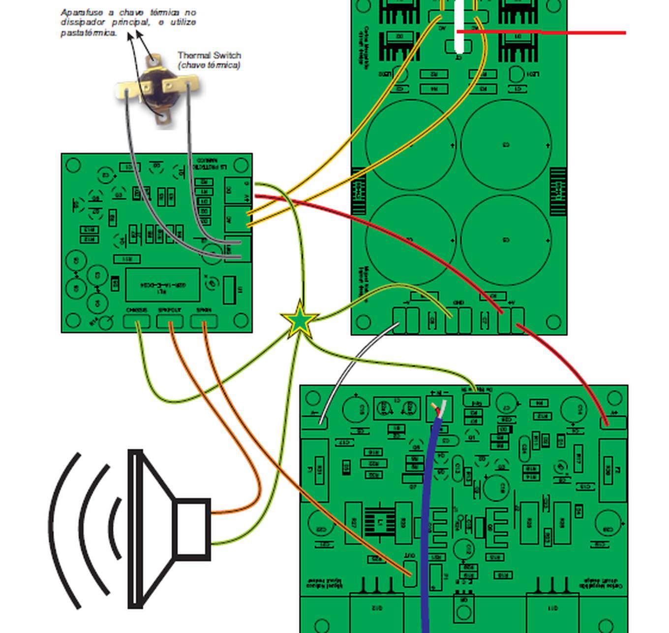

Oh!.... it seems ground loop.
Elect a center ground, or star ground...connect there your secondary center tape and run your shielded cable again.
Do not forget to ground the input volume potenciometers metalic case.
Star ground is the point of junction of all ground wires and shield from cables.
regards,
Carlos

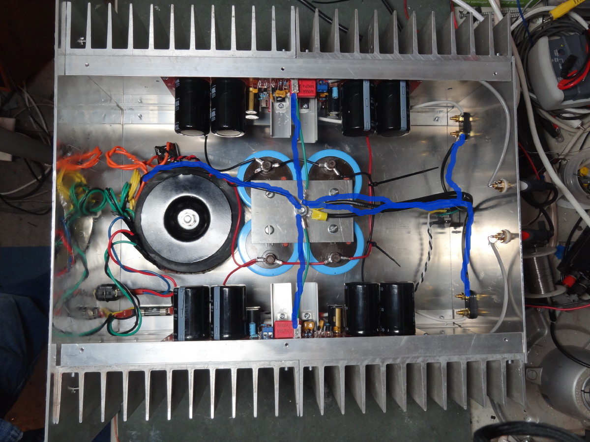

I have the center tap right in the center of the cap bank. It is attached to a bolt that attaches to the ground plate and the bottom of the case. You can see in the picture below. I have highlighted the ground wires. There is no volume control in the amp. I will replace the shielded cables this morning but they are run exactly the same way as all my other amps.
Thanks, Terry

I don't know how popular this is, but I have grounded a amplifier this way before,
Using star ground as normal but with a wire that bridges the grounds of both inputs at the sockets, to the chassis at sockets,
And a wire from there to the star ground, and this is only place where star ground is connected to chassis.
Correct me if this is totally wrong
Maybe should connect centre taps to left side of capacitor plate and ask other grounds to star point on right side of plate
The hum happens when I connect the two input grounds together
Common PSU is conected to two amp modules, and input cables shields are than conected again together. Ground loop, sensible to induction form magnetic fields. Transformer somewhere nearby. Result is induced current, causing voltage drop at cables shielding resistance, this is known issue.
Minimize loop area (twist input cables together, place power modules as close as possible) and minimize currents in input ground loop (use correctly 10R resistor separating power ground and input ground).
