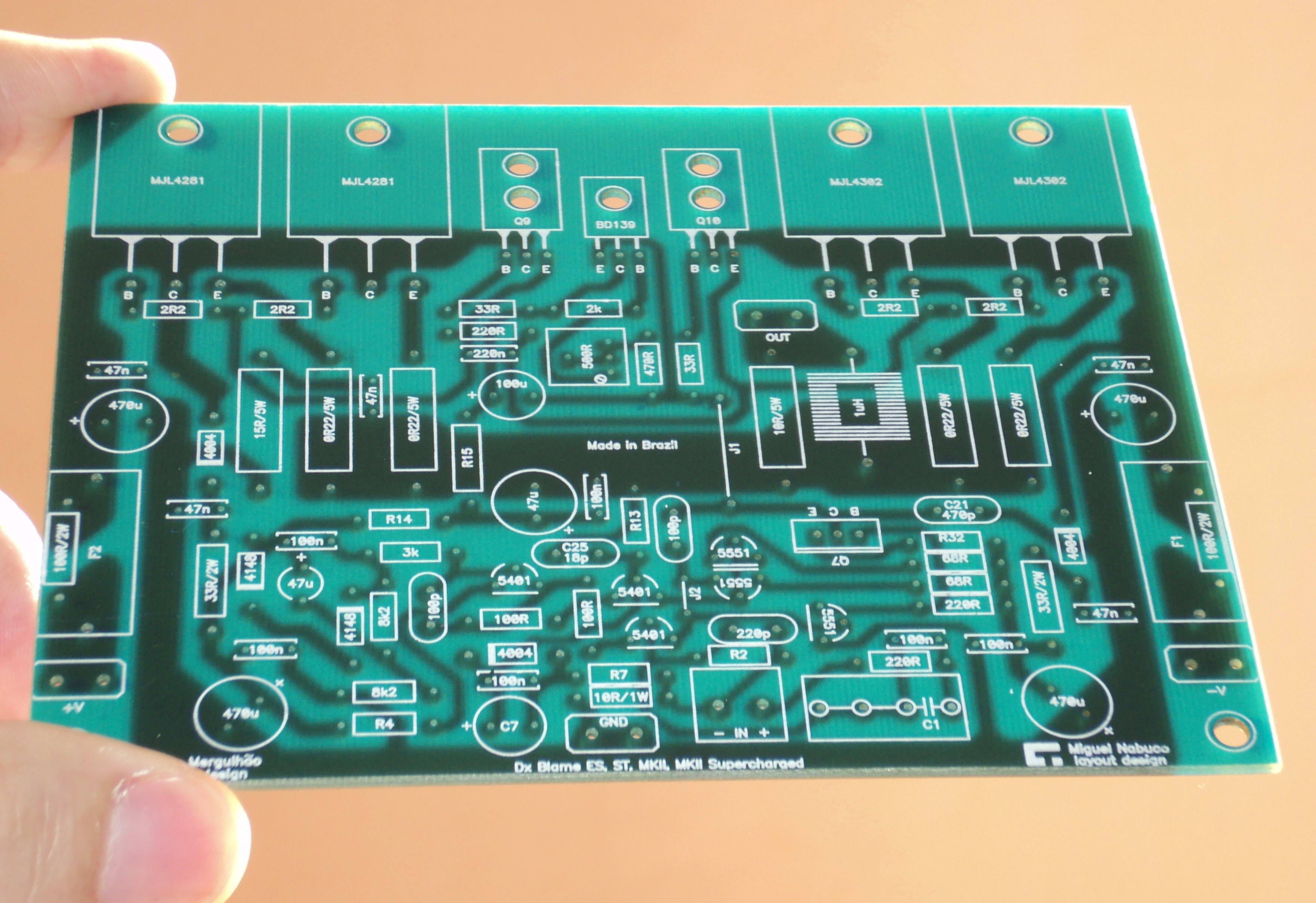

PCBs are being shipped today!
I have just arrived from the Postal Office.
All envelopes were shipped by registered priority mail. This way, we can keep track of the packages.
Our mail service herein Brazil is not fast, specially on Christmas time. I ask you all to knidly wait about 3 keeks to receive the boards. Some countries, like Italy and Israel, are known to take longer.
By now, I can only track the packages through Brazilian website. Once the packages enter the foreign country, you will be able to track it through your local post office website.
If you would like to have your tracking code, please PM me.

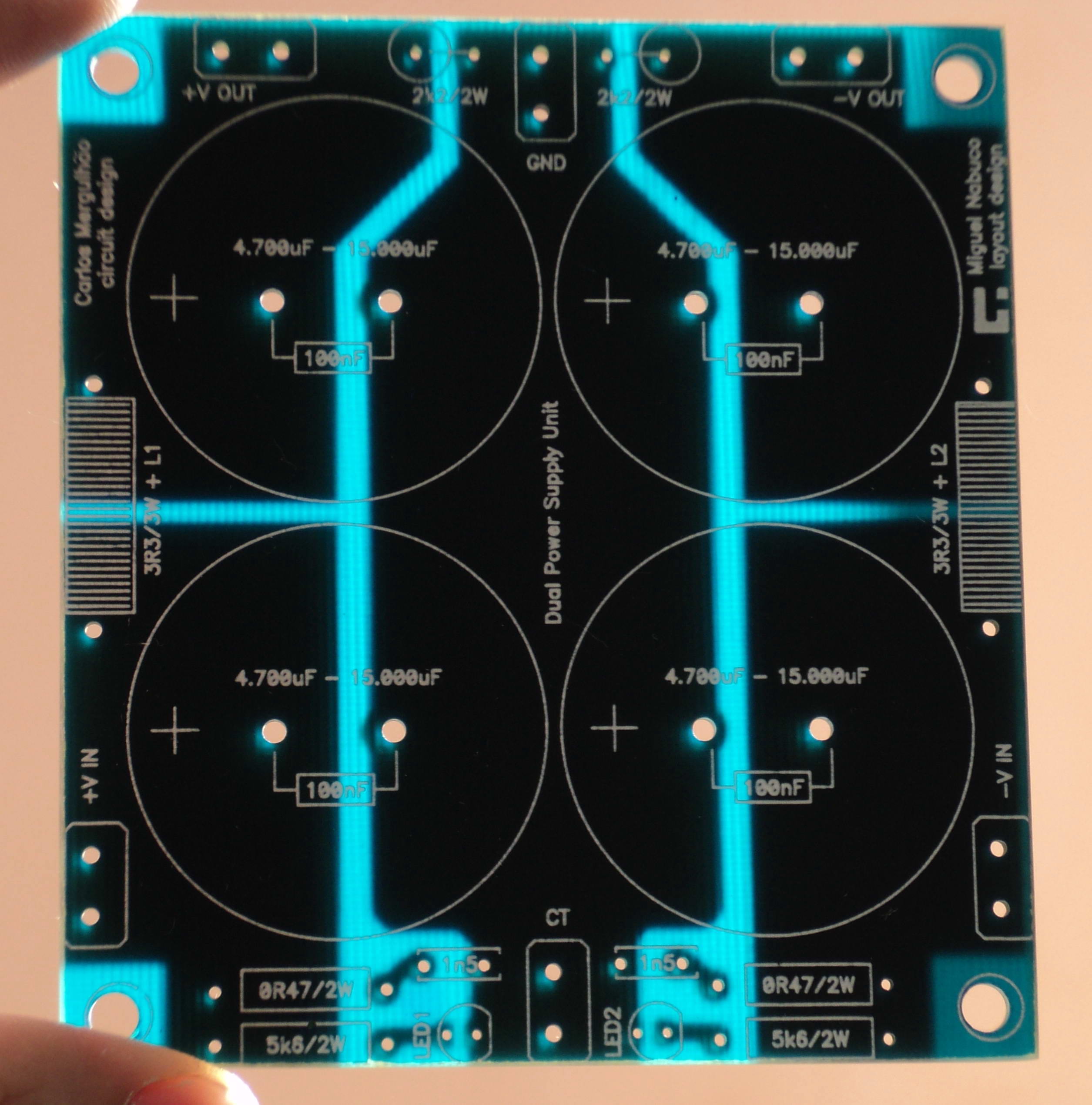

I would like to invite you to read the Supercharged thread from the first to the last
post.... in special the last posts will be helpfull to you to assemble..also to order transformers or to check the ones you have at home.
This amplifiers does not accept higher voltages nor higher power in the transformer...as output transistors are the limiting factor..so.... take care about the transformer..they can be smaller than the values suggested..but not bigger.
The transformer power selection, also voltage, was made in order to protect the output against excesses of power.... so, transformer is the limiting tool..need a good selection.
Transistors are only two pair...so..they are into the limits when operating 4 ohms...and cannot operate with lower impedance anyway... was made this way to reduce cost to builders...but, a mistake into the transformer power can allow the amplifier to reach easy 300 watts RMS... and this may destroy the output transistor...so.... the small transformer was selected in order to limit the Supercharged output power to 200 - 240 watts RMS only.

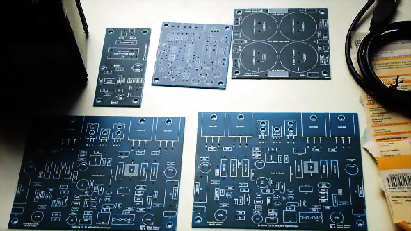

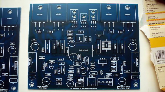

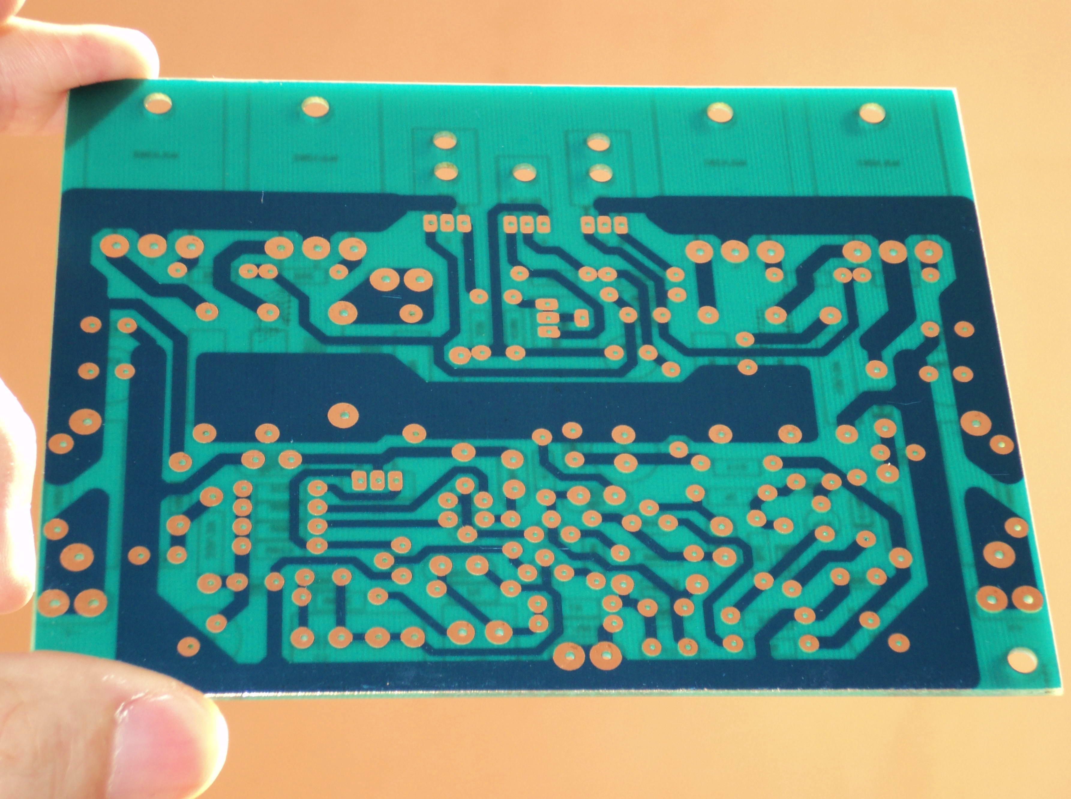

Here you have some pictures.... your boards are on their way to your home...soon you gonna have them.

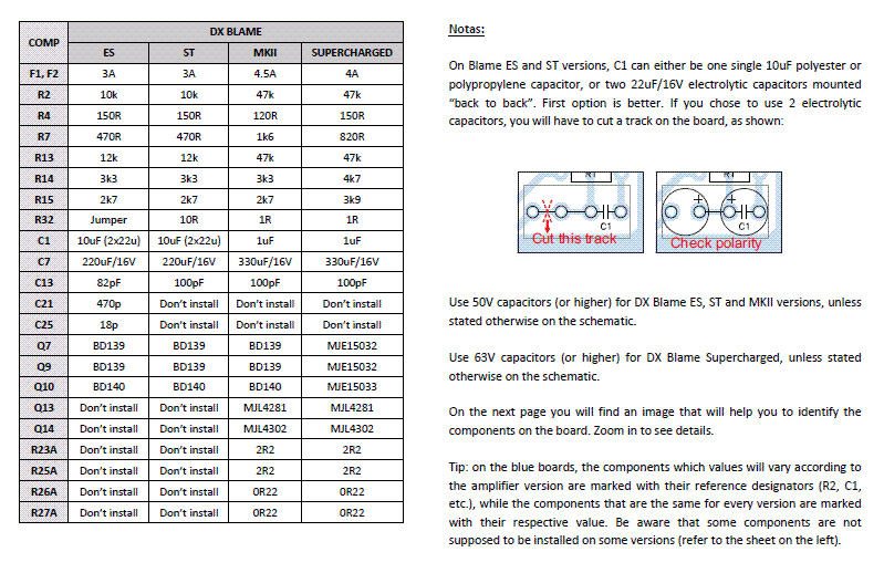

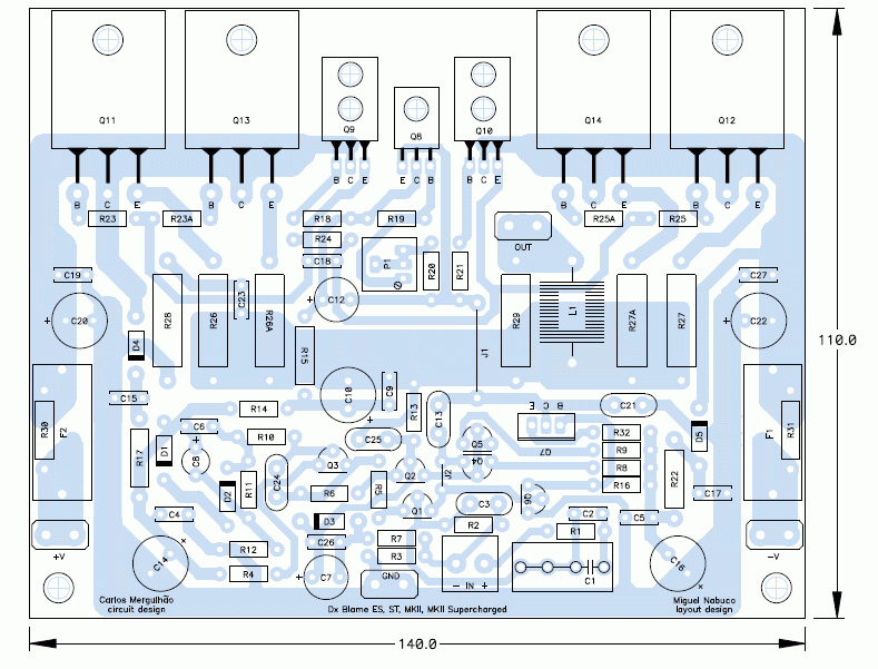

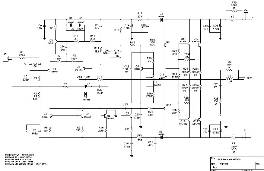

Here you have more detailed instructions prepared by Mitchel
Here you have Mitchel's link:
http://www.nabucoeletronica.com.br/dx/files/Esquema-universal-english.pdf
This is a link for higher resolution images.
All informations will be also at Greg site:
Greg's Web Site

My boards arrived in UK today. Nice quality, many thanks Miguel and Carlos.
I'm still trying to decide which version to build. Probably either ES or ST, I take it the ES sounds better but the ST is more stable?
Is it possible to provide a list of components that are directly in the signal / audio path?
Thanks again guys
