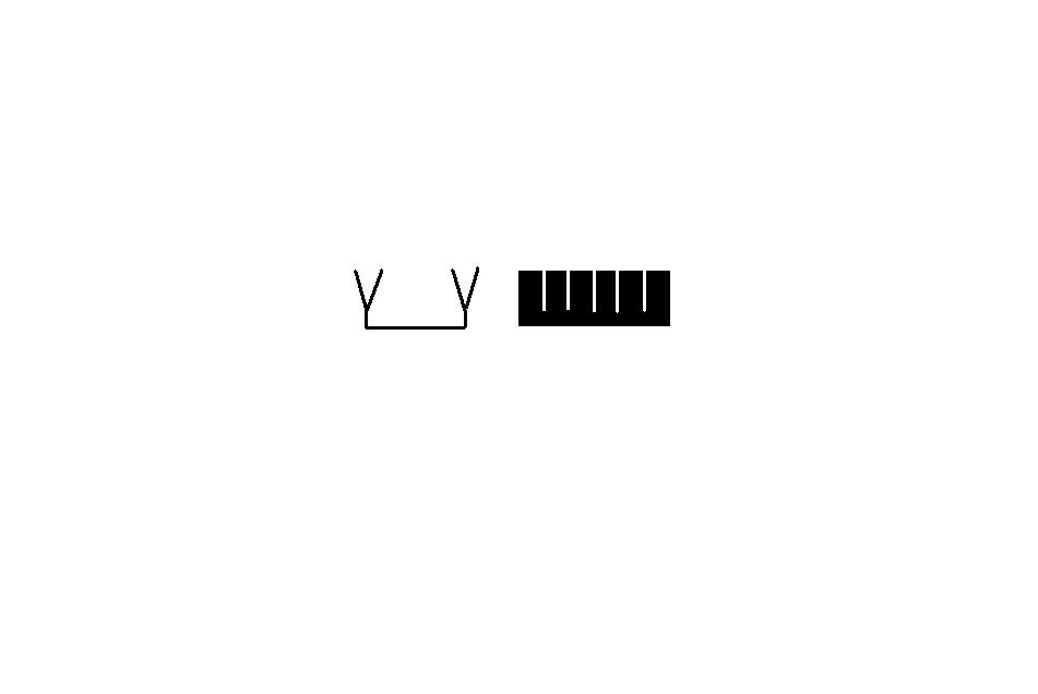

Yes, bending will result more effective, as the lower fingers will not
transfer heat to the upper fingers when the convection hot air movement happens.
The way they made, efficiency is very small.

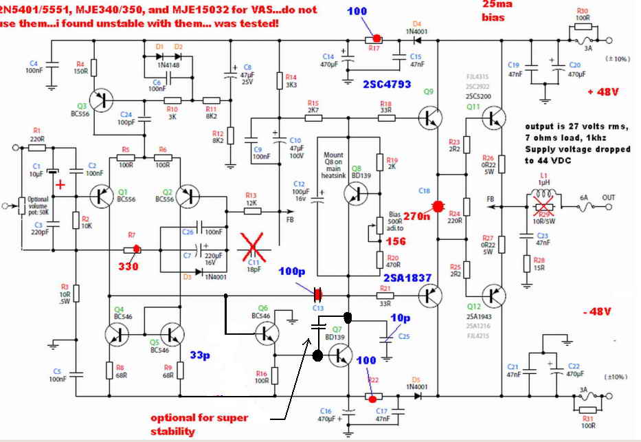

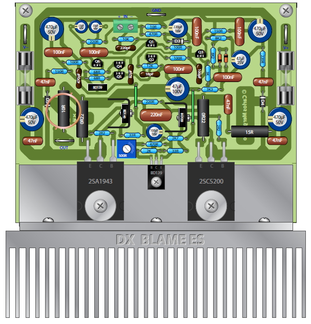

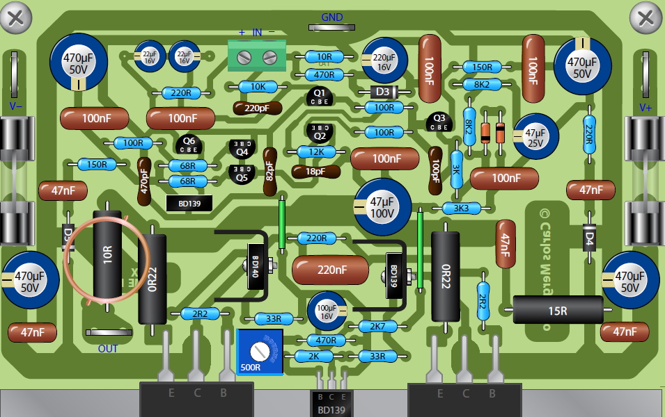

Here is the final schematic posted once more.
Also pcboard layout in Ray X vision style
Also copper tracks to toner image transference and other to photo chemical
If you need a very high resolution Image, just mail me, i have a 5.3 Megabytes image that you can zoom a lot without edging defects appear.
You can have this, and much more, in the Greg Erskine (Gerskine) home pages, the ones dedicated to the Dx Amplifiers:
Greg's Web Site
Adjustment instructions can be found in Greg Erskine pages.... what are you waiting for?... give yourself a chance to listen to the best wide world audio amplifier (at least i could not listen anyone better those last 50 years)
regards,
Carlos

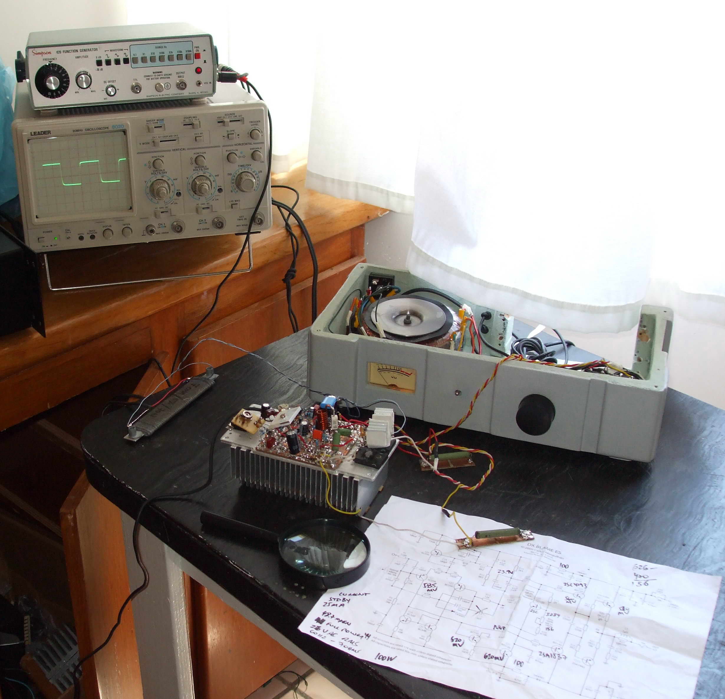

AVANT PREMIÈRE.... not the final one..but what i have made today
Maybe, something alike will be released march,28..... i am not sure..quality is not the same compared to the design offered..BUT, this one is much more stable... sound is not that good.... a very normal amplifier, without nothing very special, just the superb stability.
Removing the 33pf capacitor you have in the second VAS, from base to colector..then your sound is much better..but high levels of square wave, near the saturation, near the maximum..shows some small oscilations superimposed to the horizontal portion, the DC portion you have in the square wave....better sound without the 32pf miller capacitor to the second VAS (BD139)
To be continued next post:
regards,
Carlos
regards,
Carlos

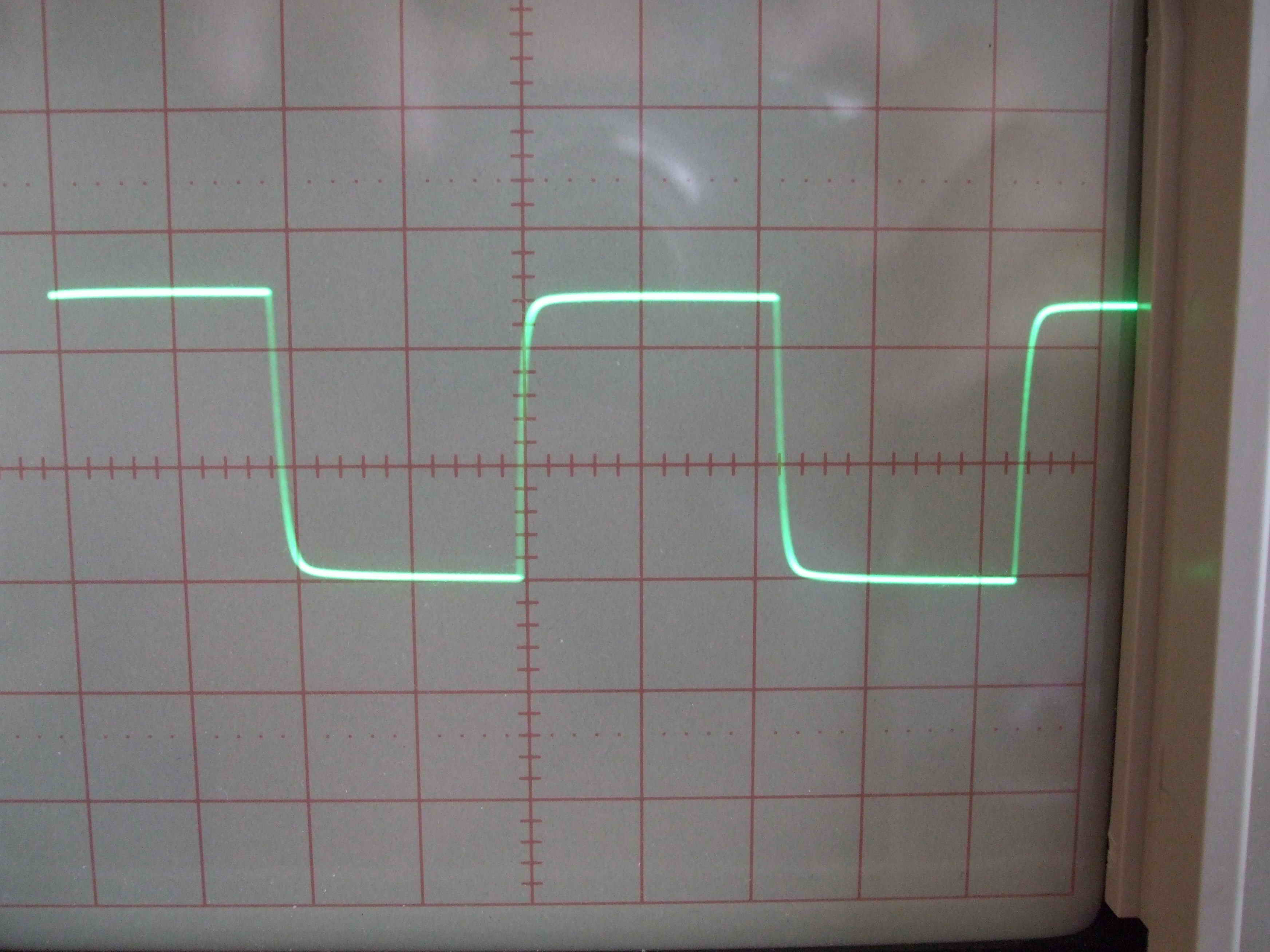

Sound is excelent, but it is not so good as the 35V version
But it is much more stable..... to the ones loves measurements, then this one is better...to the ones loves awsome sonics, then use the 35V version.
Differential VBE voltages 585mV
First VAS and second VAS VBE voltage is 620mV
Drivers measure 560mV of VBE
Output measured 510 milivolts of VBE
Off set is 8 mV
bias adjusted to 25mA
Voltage drop in the rail resistances is 1.5 volts
Voltage between R14 and R15, measure do ground is 23.9V
Supply voltage, unloaded is 48.7V
Supply voltage full power, 7 ohms load, is 44V
Output is 27 VAS RMS, over 7 ohms loads, 60 Hertz, sinusoidal unclipped
I have used 2SC4793 and 2SA1837 as drivers...my intention was to increase supply voltage to 60 volts..... i will remove them..not needed with this supply voltage.
Bias trimpot was adjusted to 156 ohms
I am not sure if this one will be approved, but it is another option, for more stability.
Thanks to Krachkiste.... really the remotion of C11 (18pf) resulted good... a big surprise to me..thank you Kraschkiste.
I will be listening and testing next two days..then i will tweak for sonics once more... today i have tried stability and more power only.
It may reach 200 watts in 4 ohms..unclipped.
No!... i have not simulated this one.... had not time to do that.

Apply the three steps to see if you like the sonics.
It is good that you have one working stable, so, you will be able to compare and to confirm what i have perceived too.
First remove C18.... having good result stop there.
No good result?.... then remove C25...... having good result stop after this removal.
Still having troubles?..... then include 27pf, or 32pf, or 33pf, or 47pf in Q7... connect from base to colector.
And give me your feedback about.... also compare sonics.
I found the sound resulted not fine doing these three steps...... the third step is the worse one.
Audio quality, in my point of view is 98 with the standard schematic....... 93 removing C18 only..... 86 removing C18 and C25.... and dropped to 80 when doing these three modifications together.
In other words..audio quality goes to the same Dx Amplifier, the Dx Standard level of quality.... a good amplifier, something no one will be ashamed compared to others, but will not the awsome, astounding, incredible anymore.
I will revert my monitoring amplifier to the standard, official schematic, today.
Mine worked without these bias fluctuations...maybe you have something wrong, something you could not find yet...let's see these super stabilizing modifications will help you.
Will look forward for your thougths about.
By the way, dear funky... these 33 volts appear in both rails?..... this means 330mA...so, a class A amplifier....how is the sonics when this happens..what you perceive in the sound reproduction......no!...i am not saying you not to try to find errors and to fix them....but we can learn something from these things happens..how is the sonics when you have this bias increasing... that seems to me oscilations... how sound these oscilations?...of course works very hot this way.... 11 watts each rail... 22 watts of heat...so, alike several JLH amplifiers.... good to cook eggs this way...i hope your heatsinks are big enougth, or you will loose output transistors because overheat.

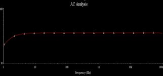

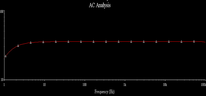

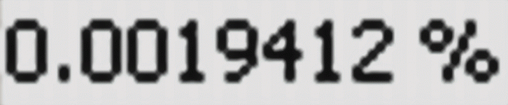

Interesting.... this "avant première" unit, is perfect in the simulator
Distortion is the lowest i could find.... or one of the lowest ones.... terrible flat...absolutelly flat...losses only below 5 hertz, waveform perfect...fourier perfect, harmonic distribution lovely...but this one is stucked in the bass...has no dinamics.... a hell thing... unbeliavable!... modifications are very small, and all them for stability.
Once, a good man told me the excelent amplifiers are the ones operates in the threshold of unstability.... i found that nonsense...but now a days, almost 5 years latter, i am realising that good man was rigth.
Will try something in between.... to see the result...not absolutelly stable, and not showing easy signs of unstabilities....maybe i am very wrong, i use to put my finger in the input, and i do all i can to listen a pure 60 hertz tone (my mains frequency)....but maybe if i listen some "chirps", or beatings, or nearby broadcasting radios may be a good idea.
Well... i will be sure about that.... and today... as i hate these doubts.

Powering up my "Lilly-board",
which is of course one channel of my BlameES.
I am sorry not to have the time I need to complete the amplifier faster.
I have to work very hard for my company right now.
So I do it slowly - beginning with the "Lilly-board"; the "Rachel-board" (right channel) will follow soon.
Powering on:
The PSU shows 38.2 V (without any load); two red LEDs saying: O.K.
After 5 seconds: the small green LED in Lilly's hair begins to shine, then: KLICK: the relay coil switches the relay's contacts.
The small speaker delay/protect circuit (in the front, below the power caps) works as designed.
So far - so good.
Maybe I have some time on the weekend and do a first test with a pair of Toshibas and a test heatsink.
Best regards - Rudi_Ratlos
