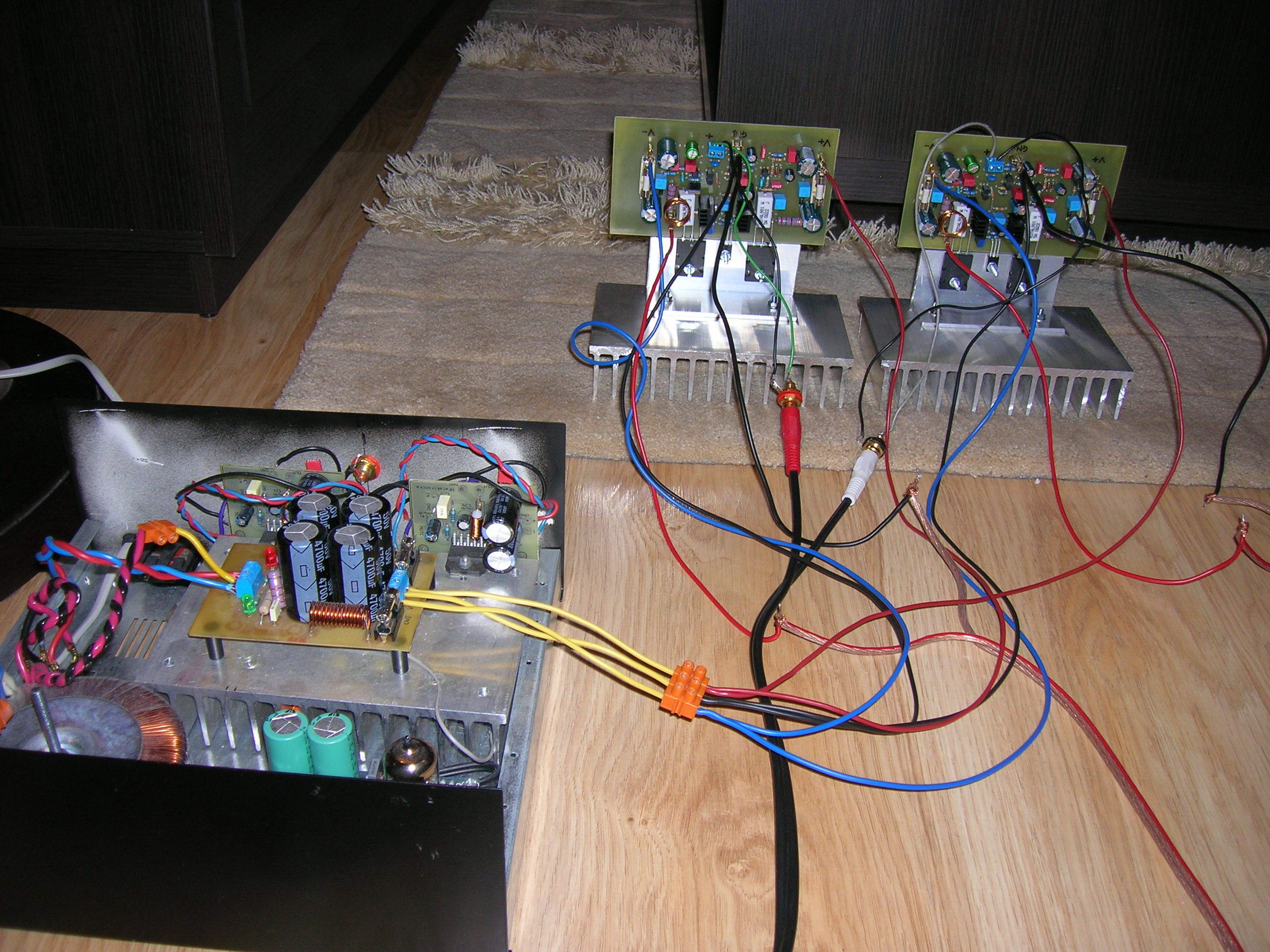

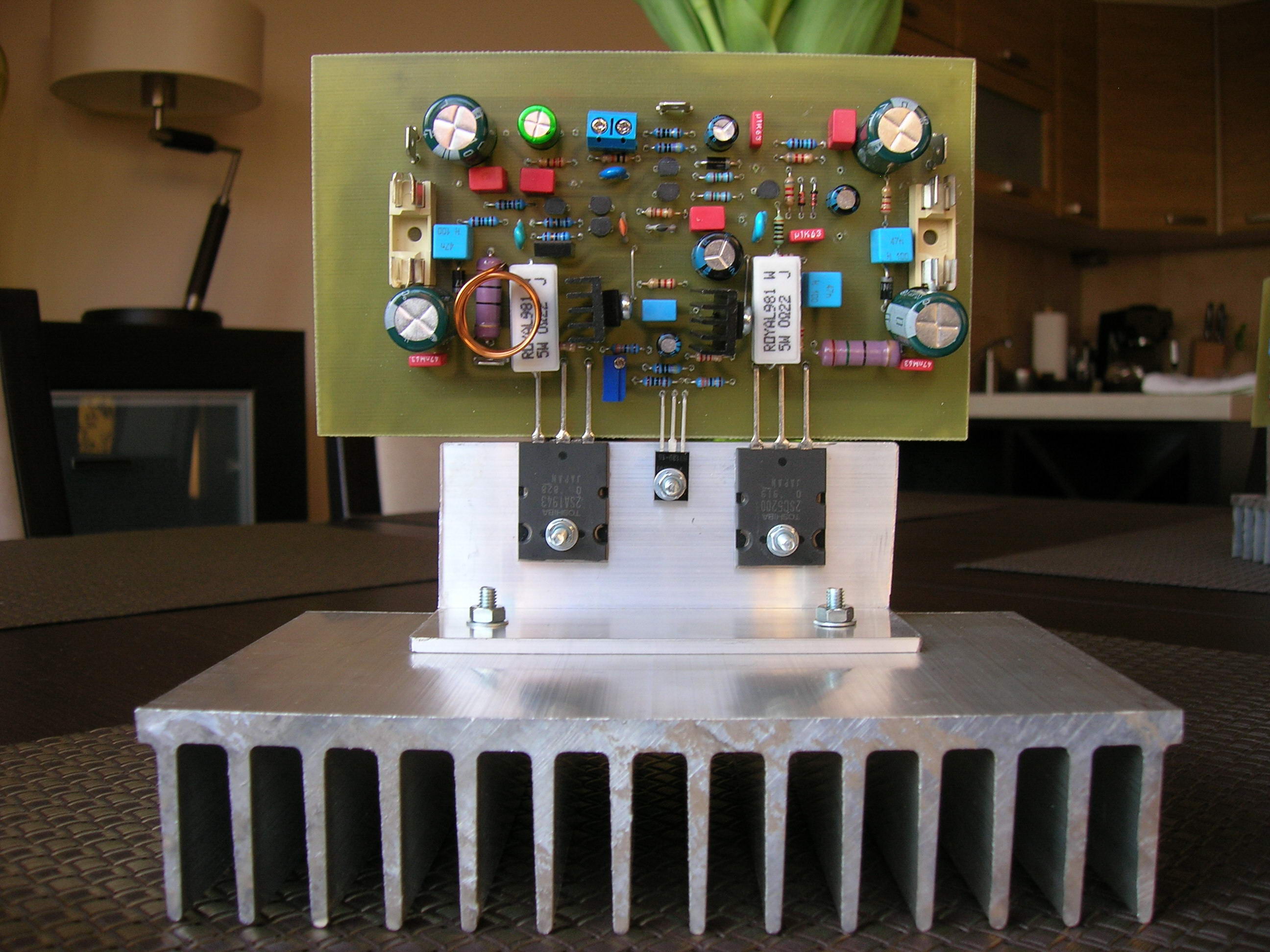

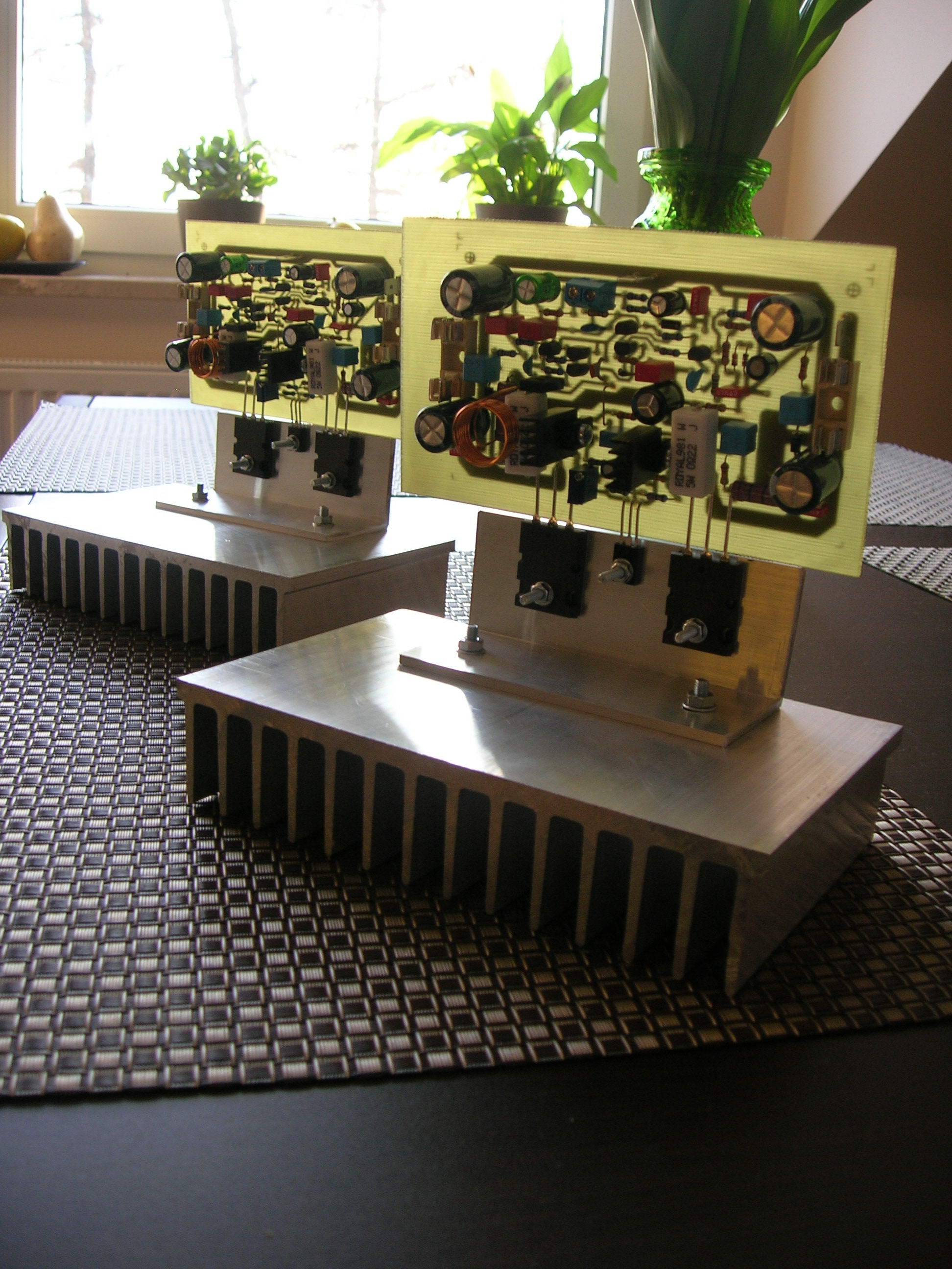

Dx Blame ES .... based into the Blameless, i am trying a new amplifier
Good Luka...but i have found more stable boards oversized
20 to 25 percent bigger... this create some troubles to capacitors distance..but i could see, tests made today, the bigger one is much more stable than the official board.
So, i suggest you to increase your boards size prior to building.
I have some tricks to unstabilize circuits, and i see the bigger one is hard to unstabilize, when the official sized board is easier to unstabilize.
Thank you Luka....nice picture...nice evaluation.
I will suggest you not to tweak bias...better to keep it the way it is..just check if you have current in the power emitter resistances, and if you have more than 500 milivolts from base to emitter in the power transistors.
Luka coil style is better..i found the coil is coupling to the input...i have shield and i felt strange superimposed signals above 500 Kilohertz have disappeared.
Luka pictures posted....Luka from Polland, the previous post.
regards,
Carlos

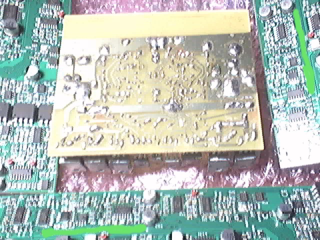

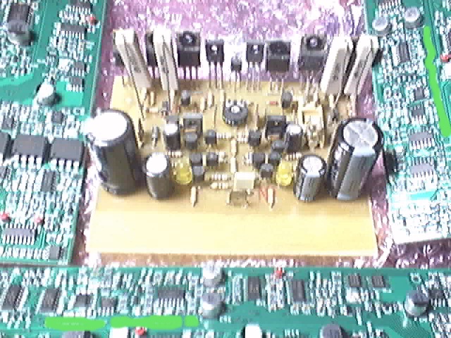

You should not have ignored my advice, now you are probably where I was 10 years ago. Take a look at the pictures, compare my 10 year old DIY work covered in dust (similar to yours, see BD139 and BD140) with my current work for the professional audio market.
10 years ago I had trouble finding and solving parasitic oscillation and cross-conduction issues in class AB output stages, I feared these problems. Now I design switching amplifiers whose working principle is controlled instability, my preferred ones 😉

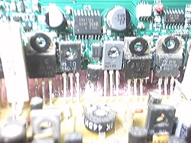

What i mean with the word unstable.
In one moment behave fine, next moment do different.
Normal use, standard recordings alike MP3 320K, then nothing happens...plays fine..but when you use high quality recordings, alike the Flac ones Rudi sent me from Germany..then things appears.
Recordings where you have high levels of treble.... loud high frequencies, then you perceive, from time to time something distorting in the loud high frequency tones, during peaks..but fast recover when normal levels are playing.
While adjusting my meter, a VU meter, to read precisely the power...then i tried high levels of bass, a steady tone in low, mids and highs to see my meter movement..also i have switched these tones on a off to see how fast meter would move..to see he average measurement... the meter has small capacitor but after diode bridge...audio is captured in the output, having 1k in series..so...this is not loading the amplifier...load was 7 ohms inductive resistance..some microhenries there...maybe 70 microhenries.... the unstability happend with other loads too, also without the meter...... well, while adjusting i decide to see how the VU would behave with 20 kilohertz full sinusoidal power.....MAN!.... the oscilation came when reaching the threshold of clipping...and them the amplifier burns first time...my home constrution, the one was playing since last Christmas.
Then i did this same test using the standard boards, the official boards.... i had fuses burned..this time nothing happened with the output.
I tried with the enlarged board...and nothing happened, not even transistors burned or fuses...but i could see some small signs of oscilations, the lost of synchronism in my scope..that unstability in the scope waveform shows that something is not fine.
Back to my point to point board, i have replaced the output and drivers... all them shorted...have changed capacitors, removed C18 and other small modifications..... increasing power.... then burned once again... this time VAS transistors (2), drivers and output gone.
This repeated four times...them i dismounted the whole amplifier...cleaned the board, inspected using magnified lenses, all parts replaced, the original official schematic used....assembled entirelly and then i have made the same test once again...... i could reproduce 500 Kilohertz..perfect waveforms...good square wave till 40 kilohertz... the i switch the whole thing off and went out for food shopping..when back home, tried once again to adjust meter..the meter was connected previously (do not blame meter, it is fine, not loading)... oscilated and burned output once again, and one driver, this time the NPN one.
I have replaced drivers by TIP41 and TIP42, as they do not oscilate easy...they cannot oscilate high frequencies because they do not work in high frequencies, they have enormous losses..... even this way the whole amplifier burned..gone VAS (2), gone drivers and output power.... nothing happened in the input..never burned any input transistors.
The garbage basket was filled with several transistors, and 10 expensive power units burned, shorted there.... i decide to inform you, and to suggest you not to build anymore..also i did that to my Orkut friends..they have complained, they said their units are lovely, working great..i said it is not stable... they may face surprises near future..... that i was unable to find a good solution without destroy sonics...the "avant première" version published does not oscilate, anyway..but sound is AWFULL.... and this is not a good solution.
