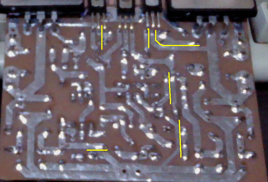

Shows and prove, that wiring matters.
Also boards copper tracks matters, there are rules, and Taj knows these rules and he use to obbey...i have not created these rules, i just obbey them too.
Copper tracks must be short, parts must be close one each other but never touching one each other (exception are the differential transistors, these can touch case to case, it is good when they have same temperature).... enormous distance from input to output is mandatory (have too)... carefull about radiating antennas alike the output coil, big distance from copper lines to the nearby ones, to reduce capacitances (each line is a capacitor pole.. air core capacitor)... carefull about line lengthes (each line is an inductor, and this increases with length)... and never use 90 degrêes, as this increases inductances and produces printed circuit board coils, that tunes receivers and transmitters and usually put transistor into oscilation.
Always prefer an ugly jumper instead to run a long way of copper track line.... to avoid inductances and capacitances.... to cross connections is much better than to run them in parallel..runing in parallel you have coupling..crossing you have not.
If we can, never use electrolitic condensers, these animals are coiled inside...a big trouble they are.
Thick lenses only to power the output colectors and grounding lines.
Parallel long line are for computers.... they can oscilate..well..they work oscilating into the clock frequency.
The good board use to be small and ugly, and when looking,you see input at left, output at rigth, positive use to he up and negative use to be down... exactly the same you see in the schematic..doing this way, line will be shorter in length
When you can, better to install a low speed transistor to slow down the circuit..this will avoid the whole thing to oscilate..the one will not oscilate..because cannot...so..the whole thing will not oscilate too.
Following these basic rules... we do not have troubles.

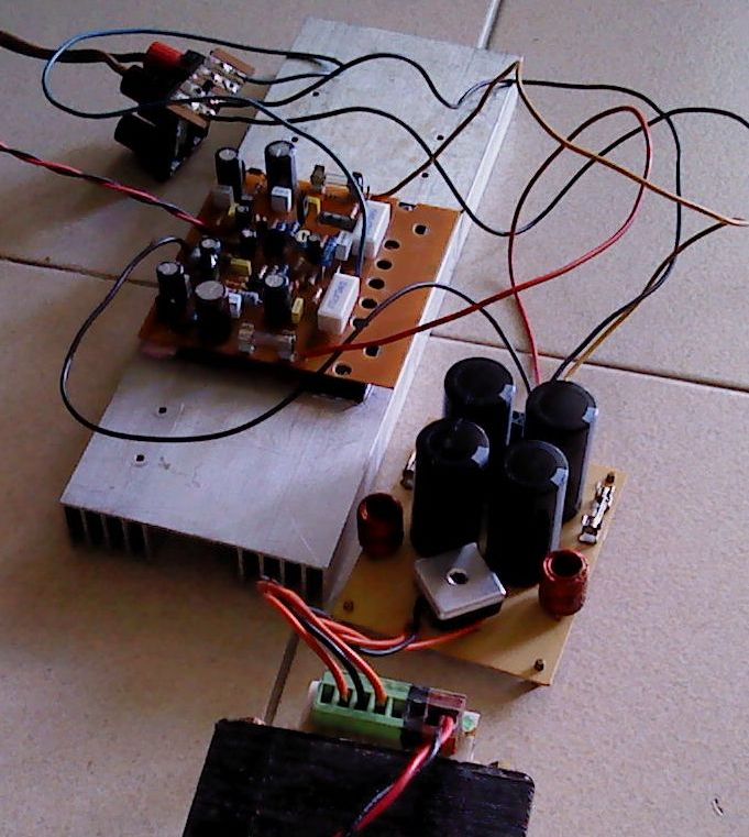

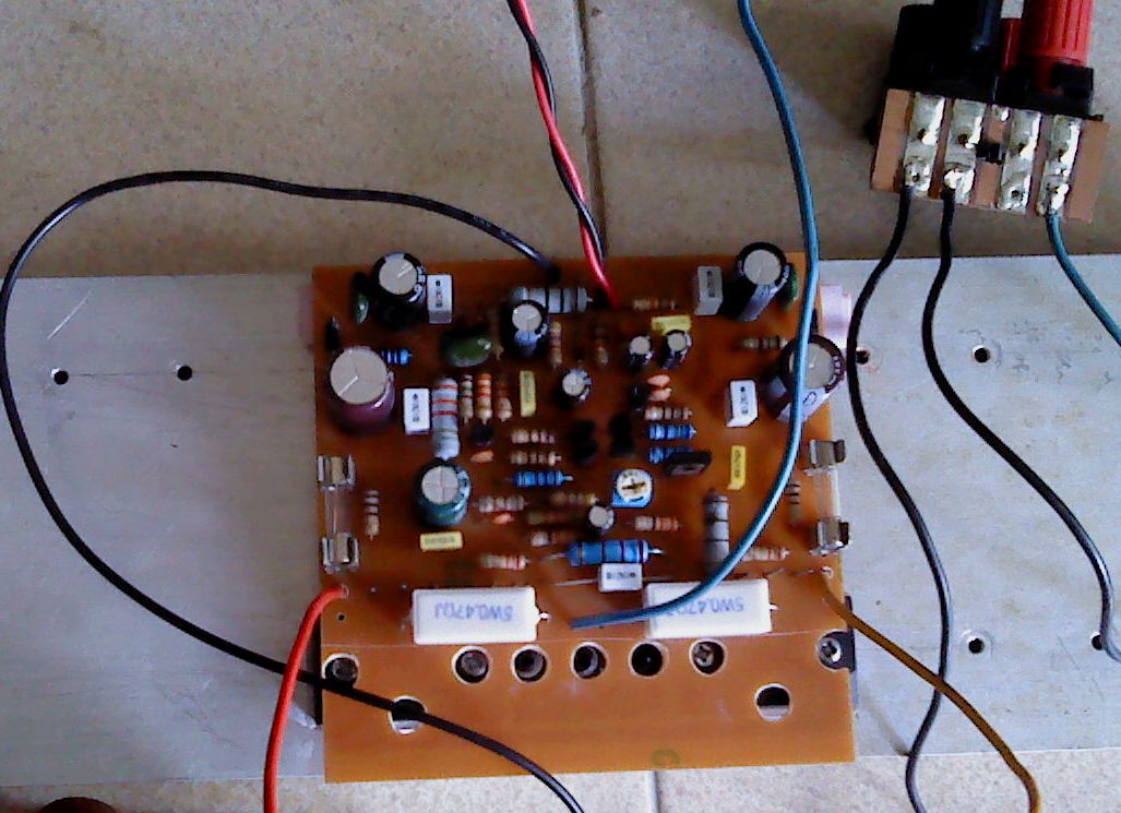

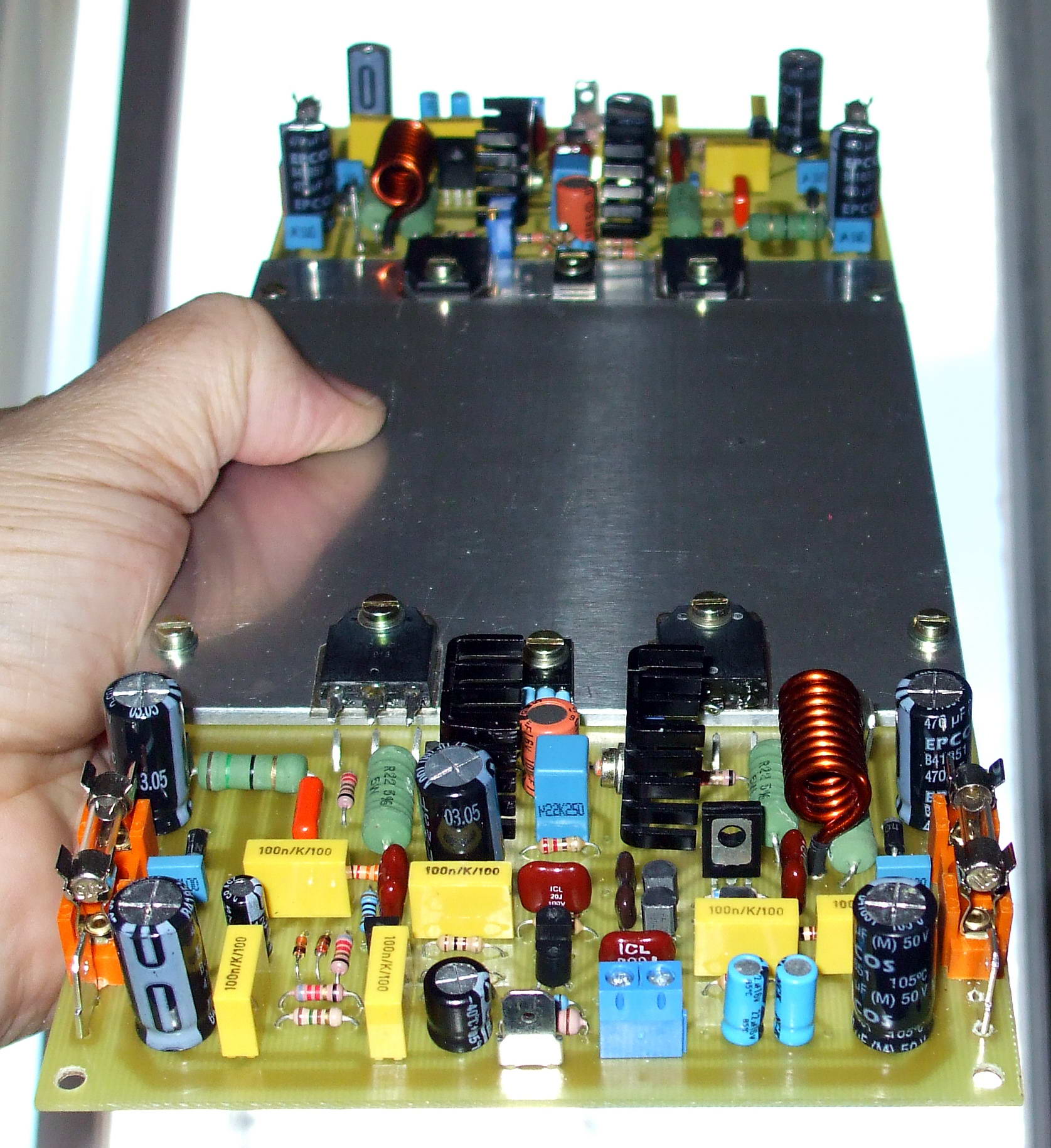

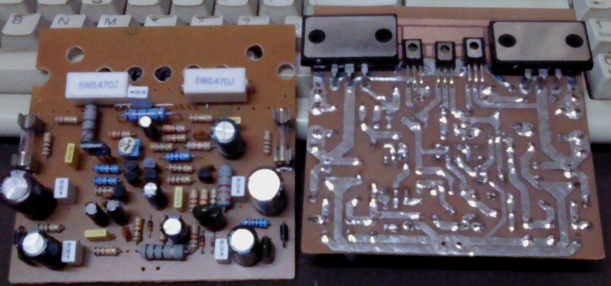

Prepare yourself to face strong emotions dear Zharmo
This amplifier is the best unit i have ever listened to.
The Dx Corporation thank you by the preference and guarantee you will never regret.
But.... you board seems different, not the official boards, and i could see small distance between some copper tracks.... i wish you luck...but you may face troubles.
Guarantee goes to the official boards made by Taj, other boards, are luck adventures, may work fine or not... i hope your unit result fine.

Sometimes we face problems...you see, Funky2x had problems, and maybe because wires
and coaxial audio cables....your amplifier seems good, you seems to be skilled, your capacitances are in low sensitivity stages, this means to me you know what your're doing.... current gain stages are less problematic than voltage gain stages.
Good luck.

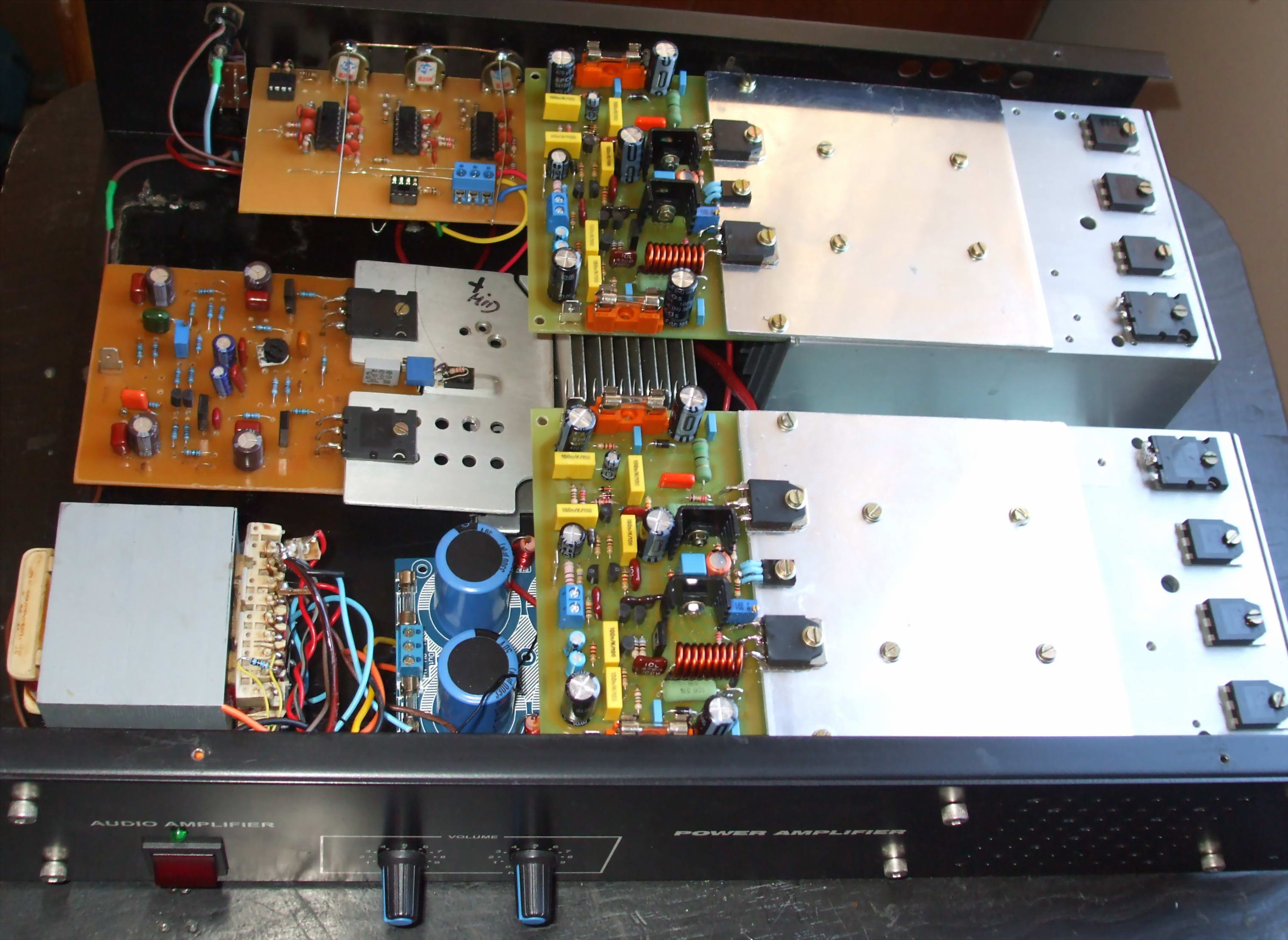

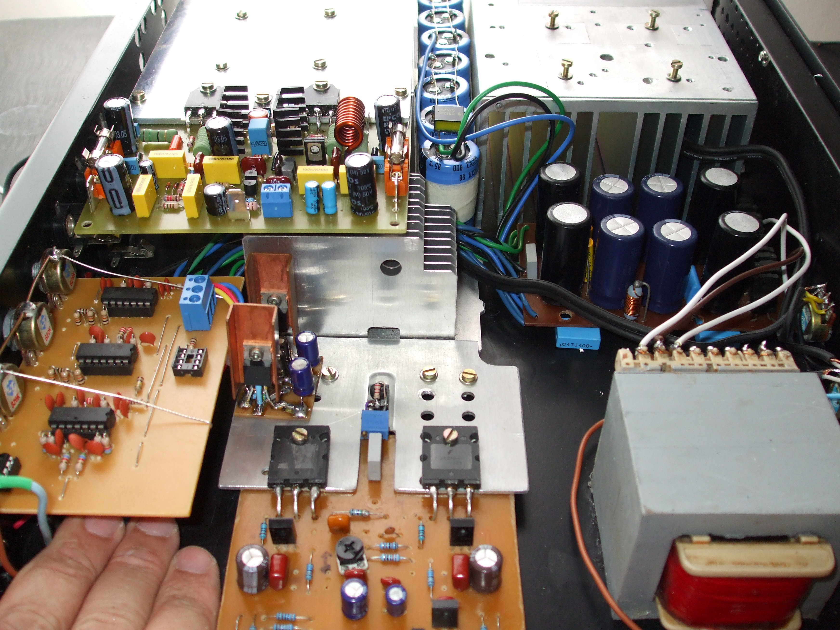

One channel is live!
lucky me... one channel of my DX BlameES is live... just work!
Connecting output to speakers, put music source to input, connect to PSU... then power ON! ... loud music goes to the speakers!
No thumb, no noise, just nice and clear loud music
Not yet measurement, nor bias setting... later... enjoy music first
Congratulations, you are skilled...you have made your own board and could succeed
Your sucess is my happyness...thank you very much to let me know.
