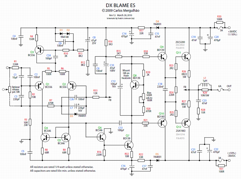

Here you see the schematic of the Dx Blame ES (Yes..you can blame me).
It was made for excellent sound reproduction.... very low harmonic distortion and interesting ratio in between second and third harmonic that matters a lot.
Despite it is the best in sound reproduction when you compare the ES with the ST, the first one had first VAS (buffer) transistor shorted and overheated ... some guys reported.... increasing of the emitter resistor or the insertion of a colector resistor can fix that... also, a 2N5551 can be used instead too.
Well...i am still using the ES.... sounds better i think..i do not mind if will be damaged..and was not because i do not use to listen into distortion levels.
Excellent unit...almost unbeatable..the one could make it is the Dx Super A that is almost the same amplifier, with increase bias in stand by mode and a Dx Super A feature (not the Super A feature from JVC or Technics.... this is Dx Super A idea only)... also a different harmonic distribution if you watch fourier analysis chart.
This unit, together the next model the ST (fixed the problem related the first VAS) and the Dx Super A had almost 500 units distributed, mainly in Brasil...people built and they have not found anything better to assemble till our days..to be as good or better must be the same topology, for sure.
In my point of view, if people want to match it or beat it must start from the same topology...no other way...i have tried so many different diagrams along my 63 years of life that i have no doubt it is the best possible topology to be deeply explored.... if you do not trust on me it is easy..you build the 5000 amplifiers i have built since i was very young and them compare with this one...then come to me and say.
