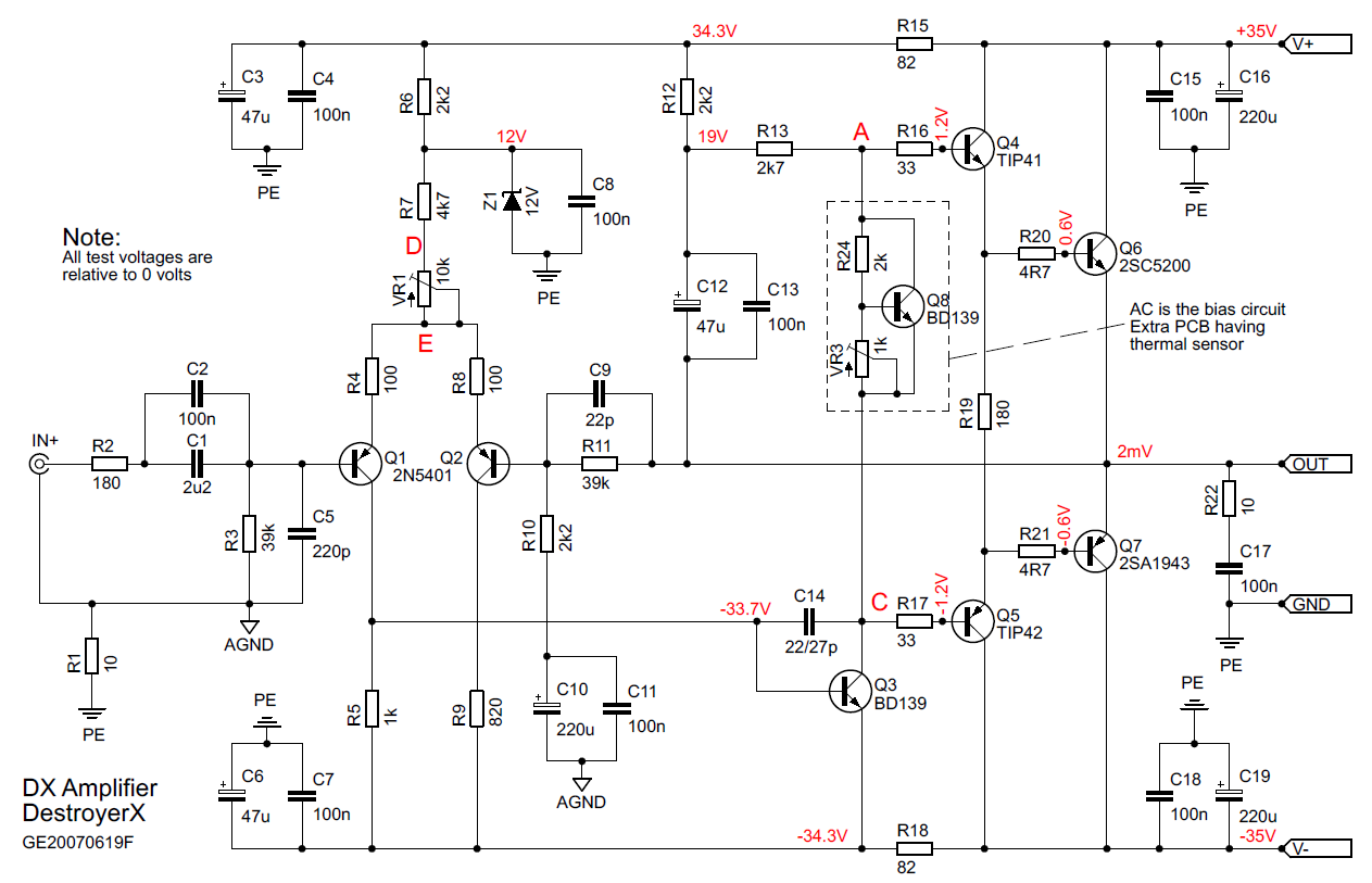

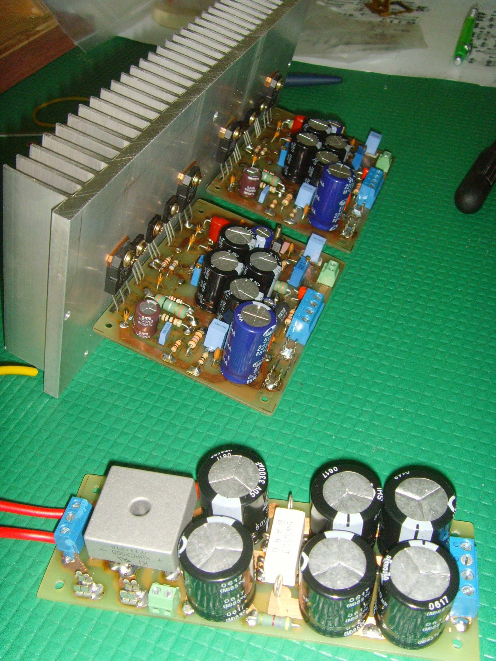

I will remind you something about the Dx Amplifier
It was a kind of design used inside all brands cabinets....all brands, Sansui, Pioneer, Macintosh, Sony, Philips ...all them used...since 1970.
Extremely developed by the best Wide World Ever Born Audio Designer, Mr. Hugh Dean, the one made the Aksa 55, from Aspen Amplifiers, now took the name NAKSA because someone stole his name creating KSA brand name.... the guy that did it was cursed..anything went well in his life..his amplifier have not take off and now a days he is publishing his schematic to see people using his failed job...i do think he deserved the destiny he had.... well done!
Aksa 55 and Lifeforce was an outstanding audio amplifier, deeply tuned, a very high quality High End product sold in kits and latter on assembled inside the enclosure....Hugh was so famous, the unit has so high quality, so highly respectable that people use to fly from USA to invite Hugh to a dinner in Melbourne (Australia) to receive and to pay in cash the previously ordered amplifier.... these guys spent several thousand dollares (air tickets, dinner and general expenses) and i do think, till our days, that was very cheap by the quality applied.
Even Todd Johnson travel to Australia and met Hugh Dean....oh!...i felt so big envy about that.... he cannot believe i became green of envy!
One day, people started to say that Hugh should show a conceptual schematic, removing all sub circuits and tuning that represent the secret of his design and also produce the outstanding sound quality....he made that and i helped him opening the thread and publishing the simplified schematic (Hugh will show you the Aksa 55 schematic!)...i already had my Aksa 55 and i was amazed with the quality...Hugh to me, was and still represent something valuable as a God.
I took to myself the honor to be the first to develop, from that simplified schematic, something to have my name, to share, to help people to understand how it works, to see people have the enjoyment to have their own amplifier and to have the chance, the oportunity to make some modifications their own way..... i have stollen the basic concept from Hugh because already published and already used (the main frame, the skeleton, the topology) by hundreds of factories...but no one could achieve Hugh results due to his research....mine unit had no one of Hugh secrets applied on it, also my unit performance was worse...no one!.. no design secret applied!... mine unit was not made to sell...no unit was sold...was a result of contribution of several forum folks producing layouts and helping me a lot....was the real forum amplifier..the real DIY amplifier... a lot of guys contributed...Klaas Veenstra and many others..all then have posted stuff in the thread.
Hugh continued to explore his design without any harm..the opposite, his name became even more famous as a result of his contribution....his customers are high level skilled audiophiles, all them successful entrepreneurs and professionals in their own area of activity that had not spare time or skills to assemble themselves...so..Hugh did for them.... all these years...he has units spread into the whole world.
I have never sold a single unit of this Dx amplifier...just helped forum folks, year after year, people to assemble...and you will find the thread... "Dx amplifier, my amplifier".. with hundreds of images, pictures, sketches, diagrams, oscillograms and all stuff...also supported by Doctor Greg Erskine that made a site to host Dx amplifiers here:
Greg's Web Site
I do know all secrets..also Greg knows..also all customers from Hugh knows...but we do not have shared, nor used, the ideas from Hugh.
Dx Amplifier is a three stage amplifier, with a differential feeded by a standard (noisy) zener diode referenced supply into the long tail.... it has resistors as colector load into the differential...the VAS (Voltage Amplifier Stage) is feeded by a resistor divisor that constitutes the bootstrap resistors..this is feeding the VAS...the output is a darlington style Emitter Follower with the driver having their emitters floating...very simplified, no output coil, no power emitter resistors.... distortion was 0.023% THD and power 50/100 watts RMS at 8/4 ohms..... bass is loosen, uncontrolled, and this is what people have appreciated, despite not perfect, nice and looooong bass tones.... thread is almost 1 million views!
Well...this was the first one..hundreds built....also in Brazil they were published in the HT forum and several brazilians have built too.
Dx amplifier test video recorded using a point and shoot fujifilm ancient digital camera....camera recording had not made justice to the audio quality of this amplifier:
https://www.youtube.com/watch?v=8xtvwuYmWGQ
Image is from the AKSA 55

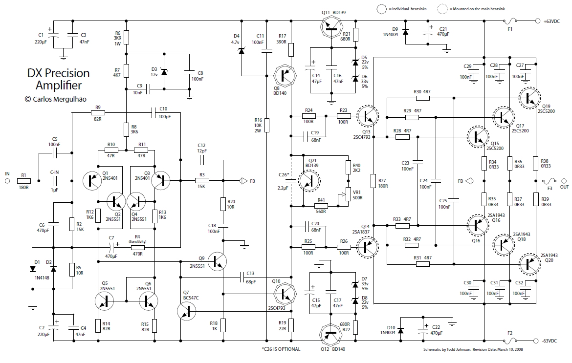

Dx Precision I ... or Precision 1
Alike all previous ones, an evolution of the former design, trying other ideas from books and from forum published schematics..... joining sub circuits together...forcing them to work in a friendly way, match them and put them to sound good as a result of careful tuning.
You see the modified differential, the VAS with current control, a kind of regulator or CCS to feed VAS, the rail regulators.... solutions to increase performance tried on this amplifier.
Resulted great .... despite flat electrically, had some sonic signature connected to low bass...people reported that 40 hertz appeared stronger when playing..... look alike.
The amplifier was flat...this is an effect, the so called "sonic signature" that differentiates amplifiers.

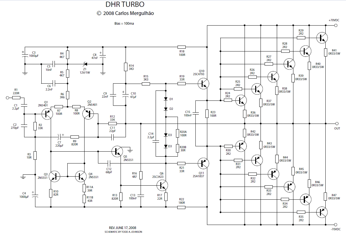

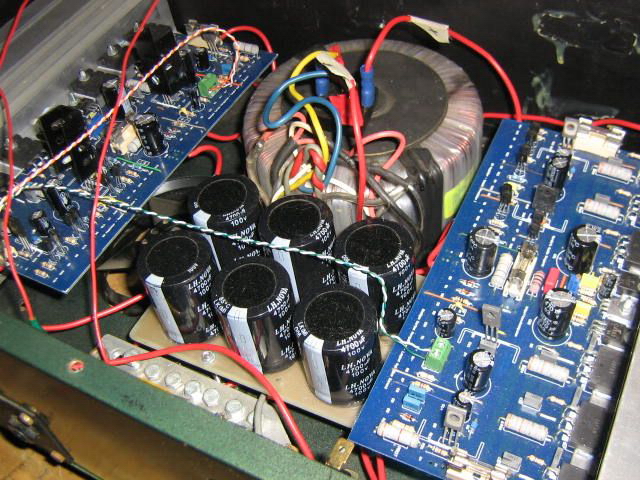

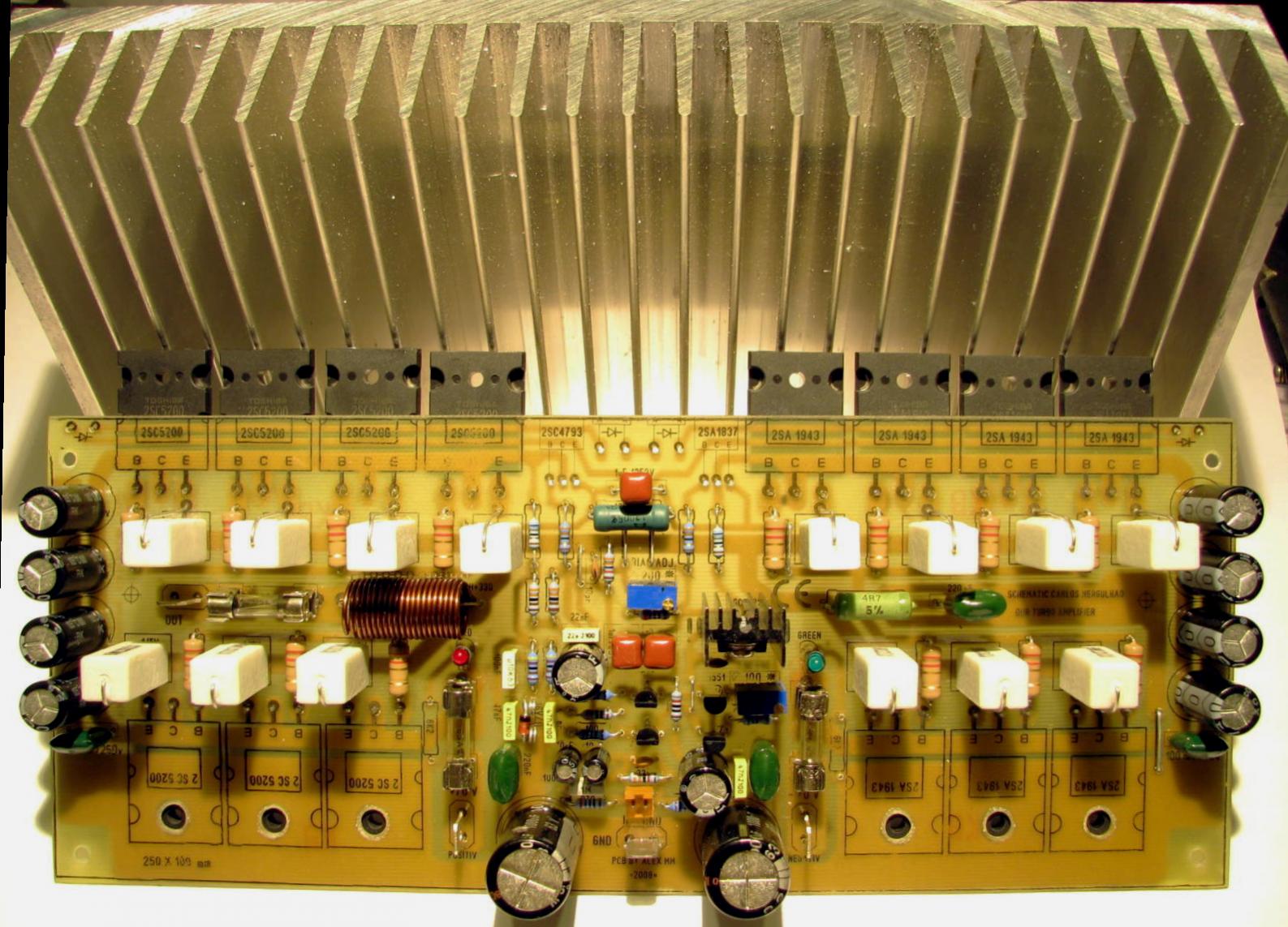

DHR Turbo was something more simple, less expensive
Using mirrors, enhanced VAS and traditional bootstrapp.
This amplifier received a big help from awesome layout designer (Alex mm)...also the help of Todd Johnson to produce schematic...this resulted in a more professional look to the unit.
This amplifier was very powerfull and reliable.... countries nearby Australia have built this one in big quantities...Philipines, Singapore, Malaysia and many others used to play loud sound in their College parties.
Use also as basis for development of College degree amplifier designs n their counties.
Here you have some pictures...was a diy design, the way forum management used to encourage us to make...no pcboards avalilabe that time...no group buy..people did it etching in their homes..one of the most pure DIY style amplifier.

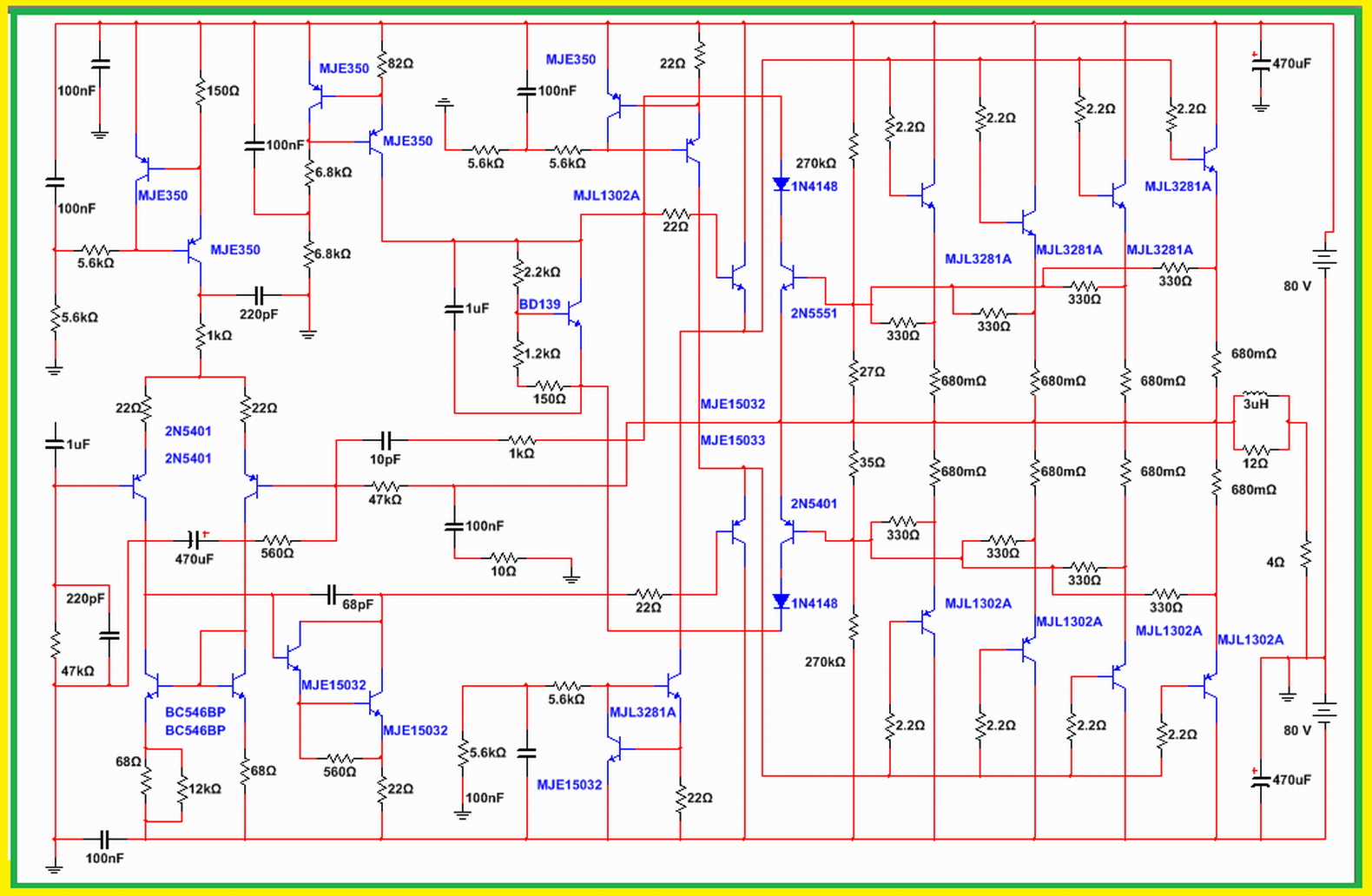

Troyan was a magnificent amplifier... i cannot understand why
it was not copied by the traditional pirates...maybe because of cost and also because there's something not perfect into the schematic (i have found that right now) that could cause unstabilities.
In my prototype i had something different applied.... cannot remember exactly what was different.
Well... this one is very special...maybe pirates tried and have smoked and they quit.... was not something i did on purpose...nothing done on purpose as a trap... but I think it was benign... otherwise because not a patented applied into the schematic, it would be copied wide world now a days as our forum is the display people come to capture ideas to earn money.
Well.... it is past and no more interested to study the subject once again as i am having very different ideas about some hybrid amplifiers... no comment..not a diy anymore.
Just showing you.... it is in the thread and you can give it a try...but check everything that something is not perfectly tuned to stability.
hehehe...people have not noticed but hey left scape under their own eyes an outstanding piece of audio electronics.
Output transistor count not show in the schematic... 5 pairs to 8 ohms, 8 pairs to 4 ohms and 16 pairs to 2 ohms.
Supply voltage can be increased to 95 volts and with a couple of pairs more you can reach 2 Kilowatts easy, per channel, with low distortion..but transformer or SMPS must be huge and heatsink will be 4 automobile batteries side by side (size) to each channel...electrolitic capacitors bank if traditional supply used will be something that you will have to sell your house to pay them.
Maybe this was the reason pirates left it alone..but for sure the circuit is inside one of these "real good high end" we have out there
