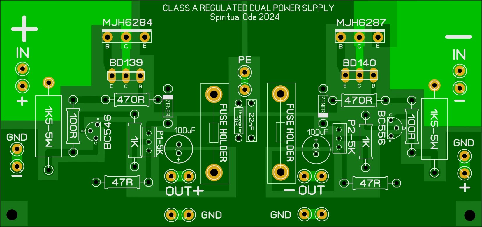

If you want to stay with the TO3 types, then I would look at the available On Semi MJ11015G/11016G darlingtons.
Those transistors can handle 25A. It's a good alternative solution but if you want TO3 On Semi MJ11015G/11016G darlingtons as Gary S has mentioned previously, is better. there are also MJH6284/87 TO247 as 2N6284/87 alternatives.I guess it was a little bigger with TIP35C+TIP36C on the out

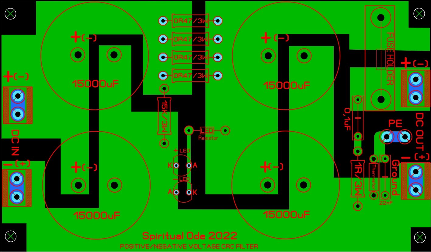

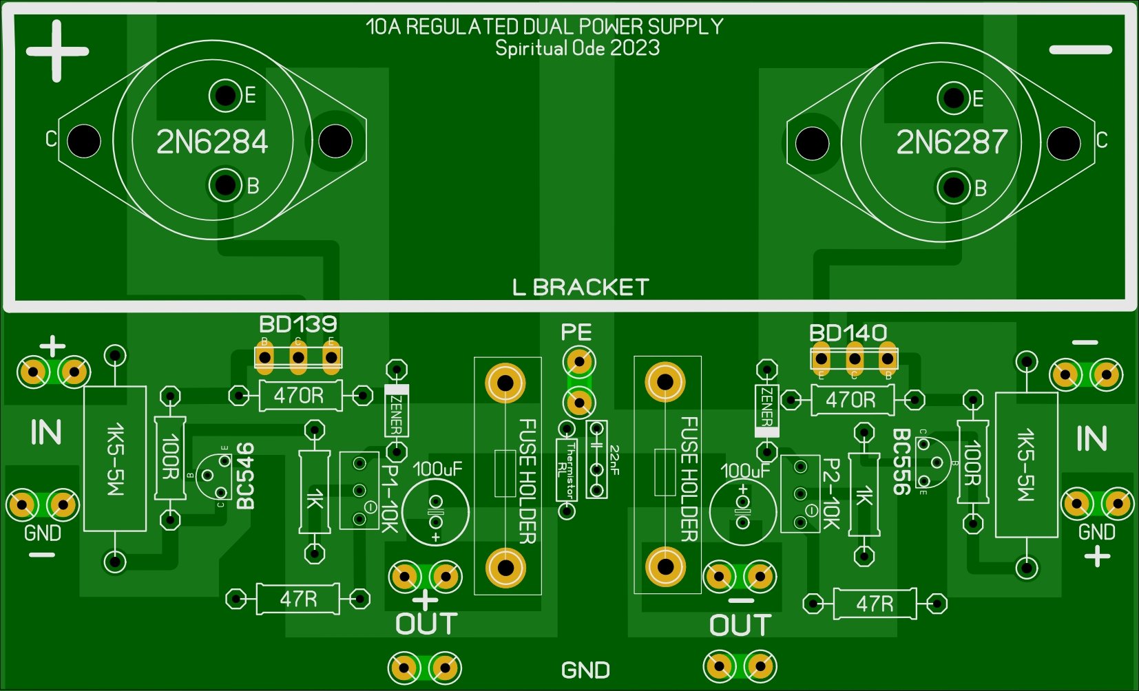

Hi JHUSTON,
I can send you the gerbers. I have redesigned that board using the TO247 Darlington transistor as an alternative to the legendary 2N6284/87.
Please verify which version you need, TO3 or TO247.
Here are the two boards plus CRC.
Have a nice day
