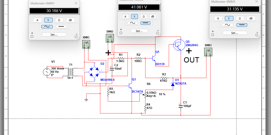

Wanted setting is 30 Volt out , 3 Volt dropout across the darlington .
I simply can't reach the output voltage of 30 Volt while remaining 3 volt dropout.

I like schematics using a pass BJT with the emittor at the output side.
There are good reasons to replace the 1k resistor by a CCS ( made of 2 bjts or 1 bjt + diode...plus 2 resistors ).
This has no impact on stability, because of little change about the loop gain.
The 1k induces current ripple to the pass transistor control, the CCS doesn’t.
With a CCS it is easier to cope with voltage drop about mains 10% voltage accuracy at any output load.

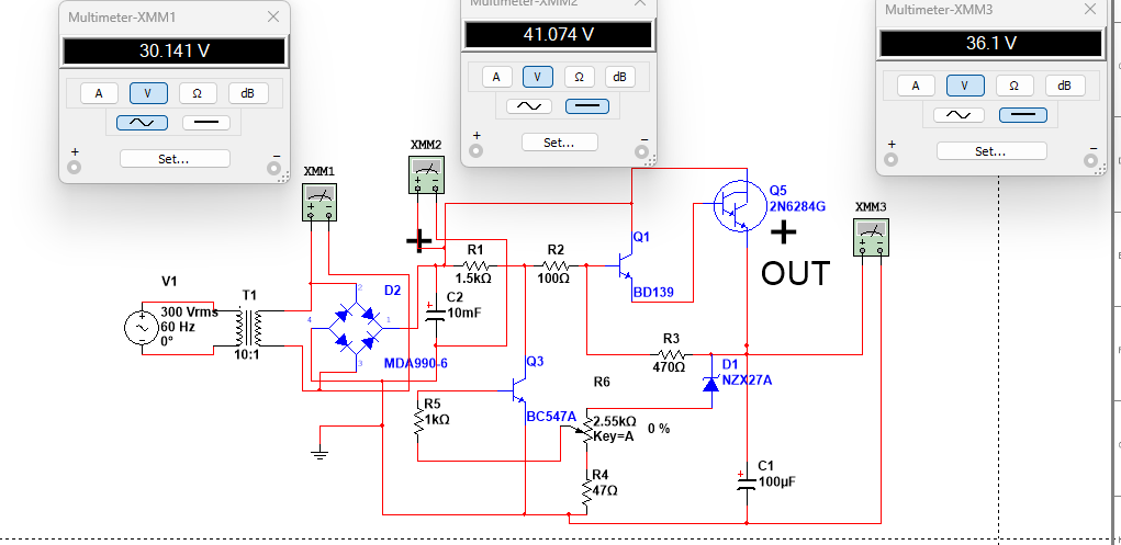

This is what National Instruments 12.0 "says" about this circuit.
In the first image, there is a regulation of about 31 volts using the trimpot. The second image shows the maximum regulated voltage from a transformer with a 30-volt secondary without load..
This is to correct a mistake ( 1k resistor ) in my previous post ( 103 ). The considered resistor is R2 = 1.5 k in the original schematic ( R1 in the last schematic ).I like schematics using a pass BJT with the emittor at the output side.
There are good reasons to replace the R2: 1.5 k resistor by a CCS ( made of 2 bjts or 1 bjt + diode...plus 2 resistors ).
