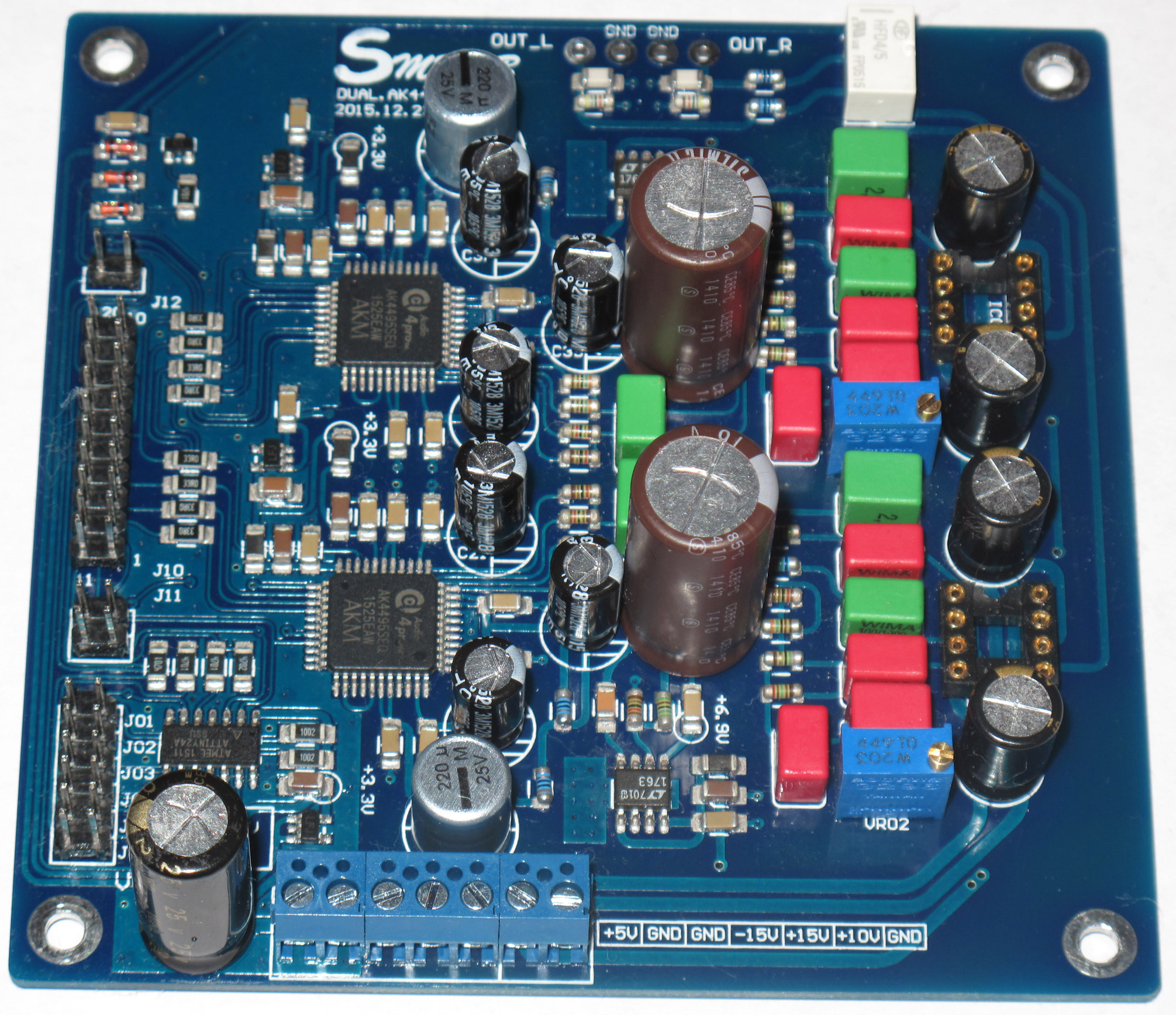

My Ak4137 board has arrived and I see that it has 3 jumpers on it : J2AND J3 set lsb,i2S or msb and I assume this should be set to I2S?
Any idea what J1 is for?

Hi Gordon,
J1 is not important...
J2/J3 are jumpers for output mode, it should be set to I2S

Any idea that does this board support direct DSD in (bypass filter, volume controller, etc)?
Yes. It works. Board xmos ustars/amanero + DAC boards. Without spdif board.
Yes I'm aware of this board, I'm more interested in NODAC approach, and have read someone mentioned that direct DSD on AK4490 + HQPlayer sounds amazing
Thanks anyway
Thanks anyway
NODAC approach means no DAC chip in the chain = I2S > analog filter (signalyst, Acko board etc.)
AK4490 + HQPlayer is DAC approach = I2S > DAC chip > analog out
so if you are interested in NODAC approach than you can post your questions here, otherwise what 730user mentioned around amanero/xmos interface connected directly to AK4490/4495 DAC board is correct...
