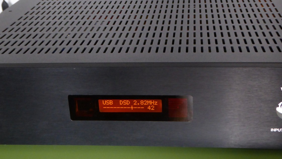

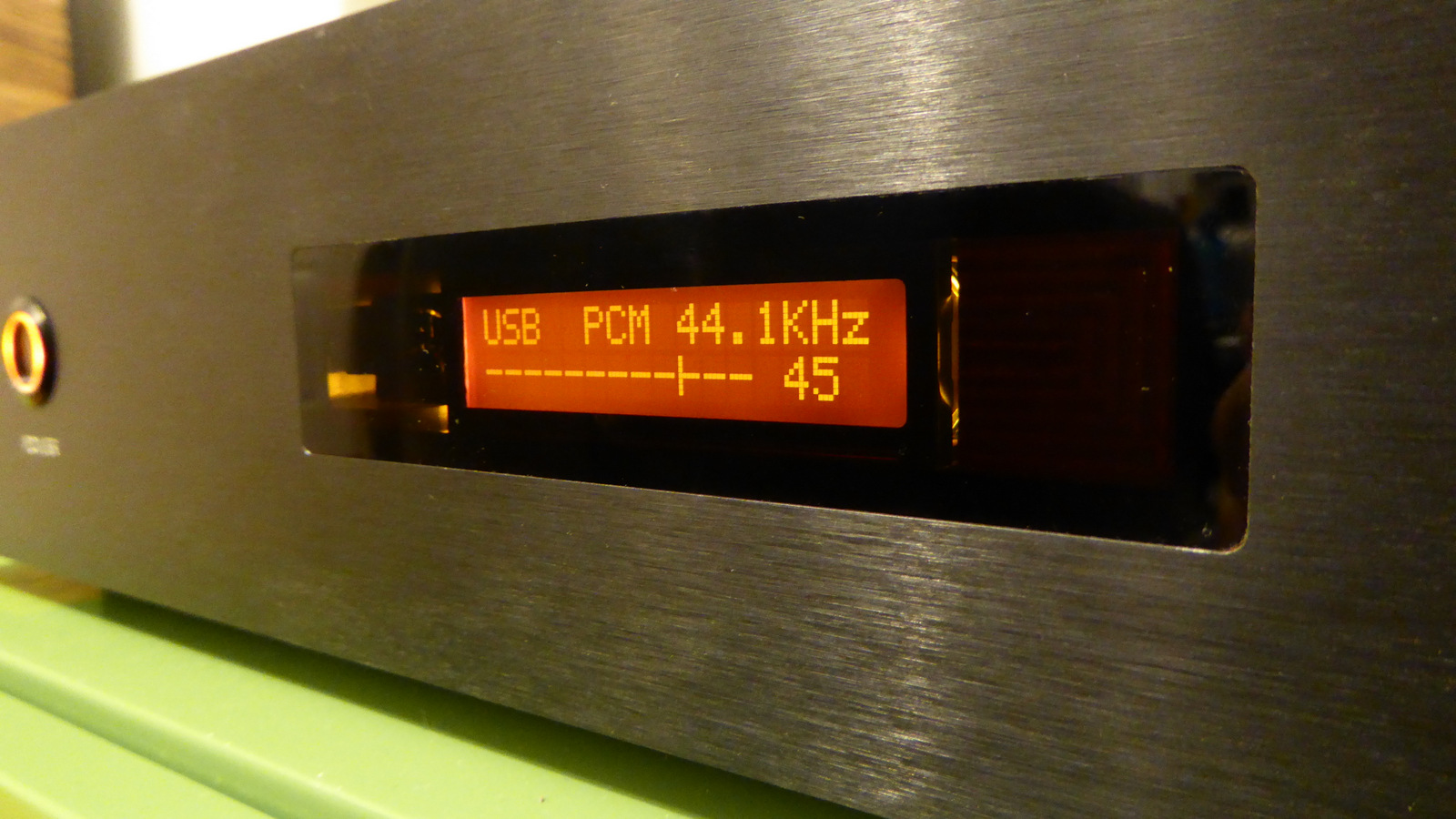

I do not have the DAC yet, considering to jump on or wait for the AK4497 version. Can someone onfirm that the display is HD44780 based. That's what I would like ;-)... It need not be the OLED - white characters on black LCD is nice as well.
I am somehow allergic to blue LCDs. Could the one on these DACs be swapped for another standard LCD without big hassle? Or even drop-in OLED?
You can always put some colored mask in front ...
Is this really the blue LCD behind the mask? If so - issue solved ;-)

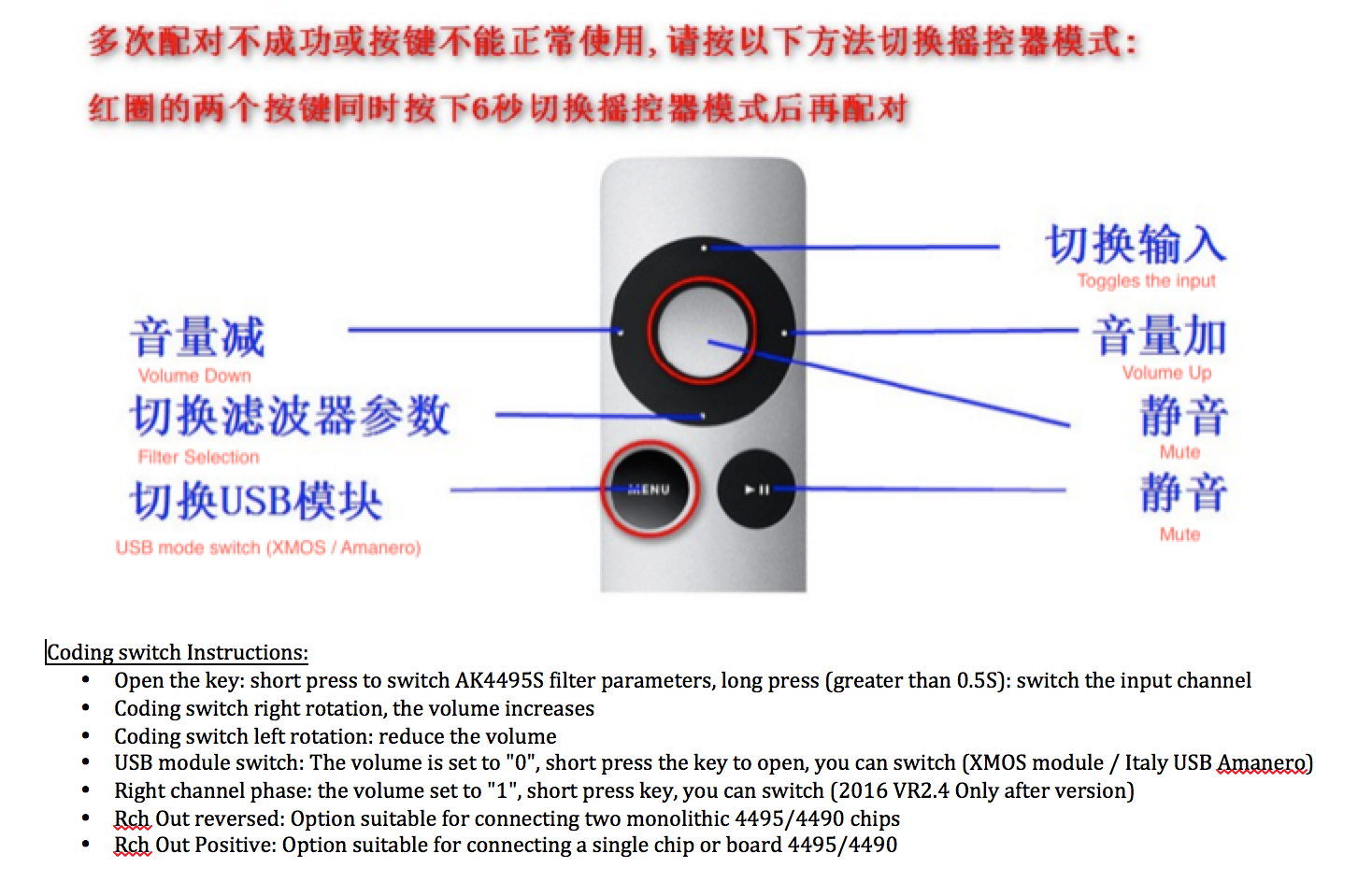

If i read correctly encoder turning is just for volume up and down and pressing quick filter selection and long pres for input select? Because i never used volume it is easier to install pushbutton. Volume changing then with apple remote..?
I bought mine from aliexp, version with encoder(b version, online mode) but ir receiver was not included. Tried to connect mine but no luck with remote so far. Fluid mentioned it could be firmware issue. It looks there is more than two versions of those boards. I asked couple of sellers on aliexp but no one could answer on technical questions.
Thank you.
Yes that is how the encoder works. Volume and all settings can be changed with the apple remote.
These are the instructions that I have saved
If you can order from taobao directly or through an agent then you will be able to choose the board you want directly from the designer.
The problem with aliexpress is that they have just bought them from taobao and are selling them on for a profit. The sellers don't know anything about the boards and they could have had them for a long time so the firmware might be out of date.
there are 2 versions but not sure how many revisions on the market, 1 with button and 1 with encoder, the one with encoder should work properly including remote functions, as fluid mentioned safe is to buy it directly from designer through Taobao
