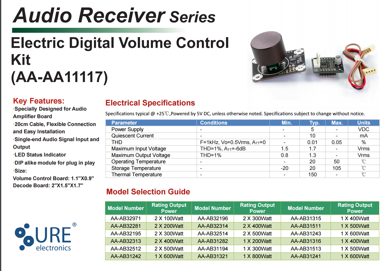

I am using this amp: Input impedance 33K: Sure Electronics' webstore 2 x 500 Watt Class D Audio Amplifier Board Compact - T-AMP
I am using this digital volume control that plugs into the amp: Sure Electronics AA-AA11117 Digital Volume Control Kit
I have an ALPS blue 50K pot at hand that I could use, if needed.
I would wire the alps pot onto some test leads so you can use that as the volume control to your amplifier and take the sure board out of the system for now. This will show you if you are getting clipping somewhere in the chain.
That sure board lists no maximum input voltage but shows 1.7V as typical and 1.3V as maximum output. I would imagine that the DAC is putting out 2V or there abouts at full volume and it is possible that this is clipping the sure volume board.
The sure board to me seems the most likely cause of the issue, I have also changed my opamps to LME49710 but that has nothing to do with the 5534 not working properly.

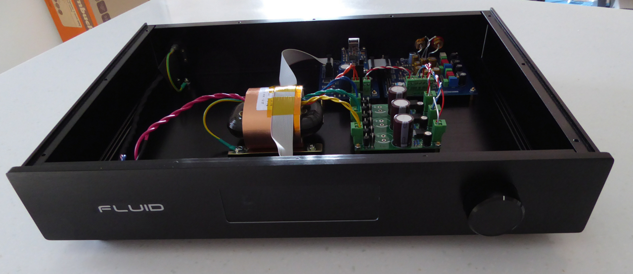

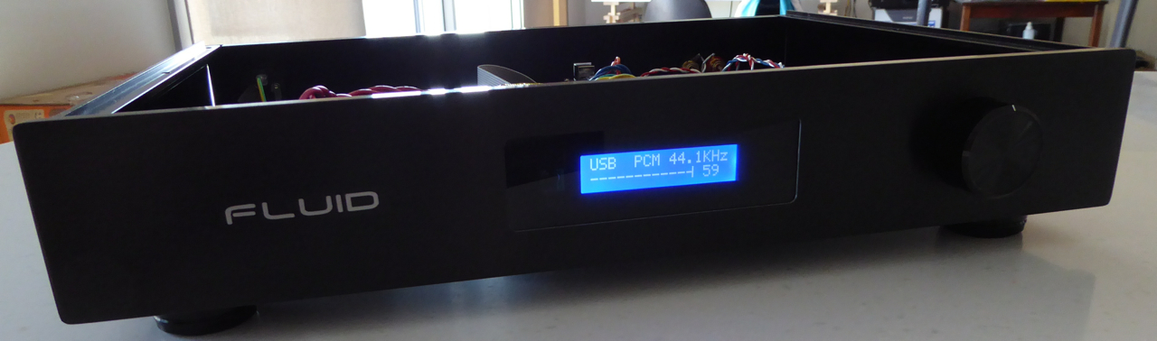

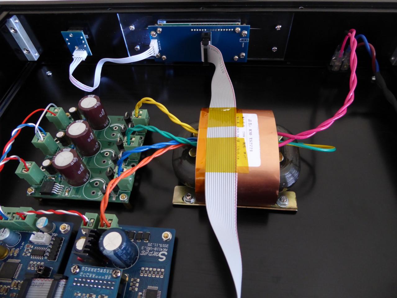

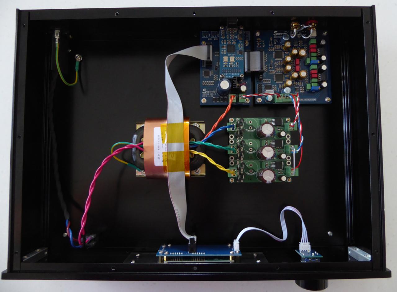

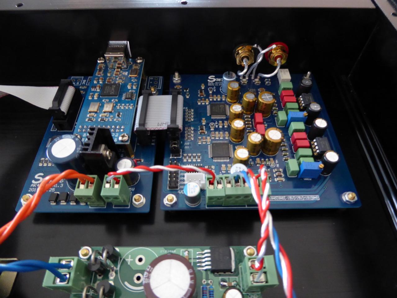

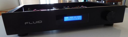

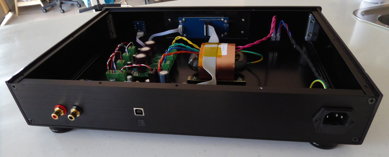

I finished the chassis for my DAC today. I decided to get a single 30Watt R-core transformer made with all the voltages I needed and used the built in 5V regulator as the pre-regulator for the DAC board. I went from barely being able to fit the three toroids into the chassis to having plenty of space!
Very nice🙂. How it sounds compared to the single chip version?I finished the chassis for my DAC today. I decided to get a single 30Watt R-core transformer made with all the voltages I needed and used the built in 5V regulator as the pre-regulator for the DAC board. I went from barely being able to fit the three toroids into the chassis to having plenty of space!

What do you have for the voltage regulators?I finished the chassis for my DAC today.
Lt1963 If it is not a very good choice.
Grounding of 220V You should not have attached to the body ...
Instead lt1963 what do you suggest?
I think at 5v position as preregulator is not bad. For audio +-15v i like Kubota or Audio gd.
I have tried some shunts but ... little to slow for me and darker sound.
Maybe that will help some members at assembling dac together.
Fluid...where did you buy that enclosure and maybe tell us price?
Thank you

I and several other people did not like lt1963 DAC supply chains. Neither the analog part or even in the digital part. Even the Chinese developers of low-cost DAC ceased to use it in new models of boards.
Surprisingly, this power supply board is good in the digital part. It's a classic scheme. Either it is necessary to use new ldo with good frequency characteristics.

My story has a happy ending too. Yesterday, I ditched the SURE digital volume control, and installed an ALPS blue 10K pot in front of the amp board. All is good. No clipping. Great sound, and I am already hearing extra backing singers, where I had not before.
Thanks everyone for the advice and debugging.
They are TL1963 the TI version of the LT1963 so pretty much the same.
You are certainly entitled to your opinion on the regulators but they are used by some top end manufacturers in some very expensive equipment. If they were awful then they would not be used.
Here is a picture of an MSB Analog DAC, a very expensive and well regarded piece of equipment and look what is in the power supply, LT1963 and LT3015. I think I'm with MSB on this one. Click on it for a larger picture.
If you are talking about the transformer then you are wrong, the yellow and green wire on the primary is a screen which needs to be earthed to the chassis. The two red wires are the 230V AC connections.
This is a little unusual as most transformers are not screened, but this one has a copper foil screen. Toroidy does the same on some of their high end toroidals.
Thank you
This is the enclosure from this store, I had them machine it to a CAD drawing that I made for the front panel it was about 60 Yuan more for the machining. The price for the shipping is what makes it more expensive depending on where you need it to be sent.

230V AC connections
I meant 230V grounded. It should not be connected to the DAC body. This is the opinion of one of the best developers DIY DAC in Russia - Linх.
??????????????? ??????????????? ?? ?????? "??????-?????" ???????? - Lynxaudio - ?????????????????? ??????? ????????????????????
I am absolutely convinced about lt1963. And it's not just my opinion.
I don't really want to debate the merits or otherwise of various voltage regulators. You don't like them that's fine, other's don't like them that is fine too.
My point was that not everyone agrees with you and some of those people make some great products.
That link just takes me to a page of nice looking DAC boards, no mention of regulators that I can see.
Are you suggesting that the chassis should not be earthed? Maybe it's a language barrier but there is absolutely nothing wrong with the way I have wired this DAC. The chassis is connected directly to the safety ground as it should be.
Lynx uses shunt regulators on operational amplifiers and high-precision current sources.
220V Grounding is not necessary to be connected to the body! This improves the safety of the appliance. But worsens other parameters.
It's perfect - if you own a cottage and a separate ground connection. If it is an apartment with common ground around the house is a bad thing.
