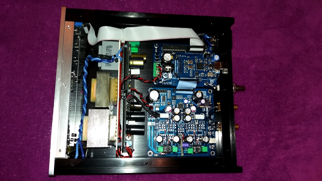

I have the single chip board, and have wired it all up. Just before I powered it up, I thought that I would do some checks with my continuity meter.
I have wired it as per this photo off an ebay listing for a completed unit.
AK4495SEQ AK4495 DAC decoder AK4118 PCM 384KHZ + XMOS XU208 USB support DSD NEW | eBay
My board is the same version with a different production date:
I am getting continuity between both coaxial connections.
I am also getting continuity between all of the line out connections and ground.
Any ideas?

There is very little that you can test on a populated board like this with continuity. Continuity will show you that there is a path between those points which there will be at many points on the board. If you test with resistance a 0 measurement will show a very direct connection and more resistance will show that it has made it's way through more components.
The only thing you can really do damage with is connecting the power supply incorrectly or by actually creating a short somewhere. If you are sure you don't have a short and have the power connected correctly then switch it on and see, preferably with a test speaker or headphone just in case

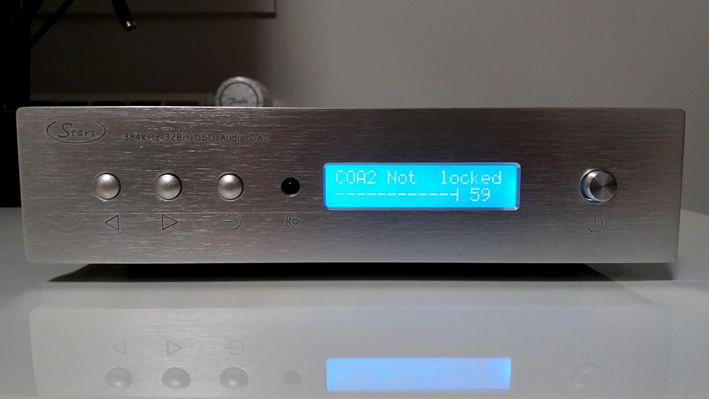

Still no luck with remote. Tried another IR receiver with no result.
Also measured 0V between V and G pin on receiver.
Should it be around 5V?
It looks like some parts missing on receiver lines...
It is more likely that the code in the micro is not setup for remote control on this version as there is no ir diode included on the board.
An IR diode from china costs nothing so if the code was there it is likely the diode would be too?
On the other input boards the diode is present and function works. I would confirm with the designer that the code is there before going any further.
dublin78: I assume your DAC board is coming with LCD panel fitted with IR diode right? I don't remember if the V pin supposed to be 5V or 3.3V but there should be voltage coming, can you post picture of front and back of your LCD panel board?
second part of successful usage of remote control is pairing, you need to hold your apple remote against your IR diode for 5-7 seconds with menu and right arrow pressed at the same time, message should pop up after successful pairing on your LCD screen
kukynas: Yes, the DAC comes with a LCD board, with three buttons, and an IR sensor.
I have tried to pair it, as you described, but no luck. My remote is a fake knock off that arrived with no battery or instrcutions for which battery to use. I fitted a 3v battery, and it is impossible to know whether it works. This does not bother me at the moment.

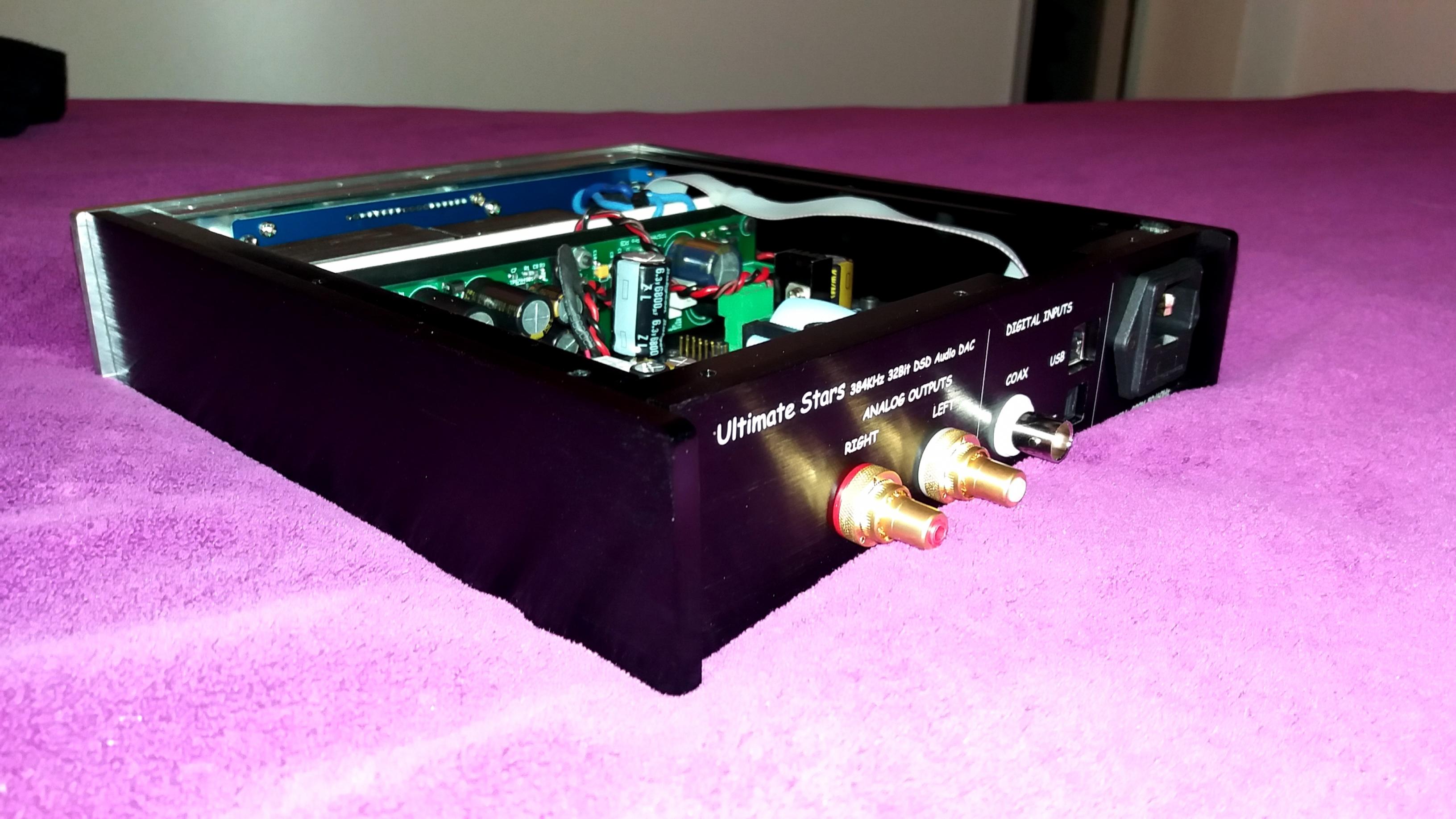

This sounded wonderful, until I played music with more bass. The DAC makes a horrible crackling sound that occurs in time with the bassier notes. This is not noticeable when the amp volume is turned up, but when the amp volume is turned down, it is quite loud, and is all that can be heard.
I have tried it with two digital sources. I have tested the amp with a different source, and it is fine, so it the problem is definitely with this DAC. I have connected the ground to EARTH. No difference.

dublin78: can you try different opamps? preferably LME49710
I have just ordered some and some DIP8 sockets. It will be a week or so for delivery.
The cracking/popping sound is very strong. It is hard to believe that it is down to a lower quality opamp.

Sounds like you might be getting clipping from bass transients, how are you controlling the volume?
I have used JRC5534 opamps and they work fine so changing them is unlikely to solve your issue. Can you take a picture of the DAC?
