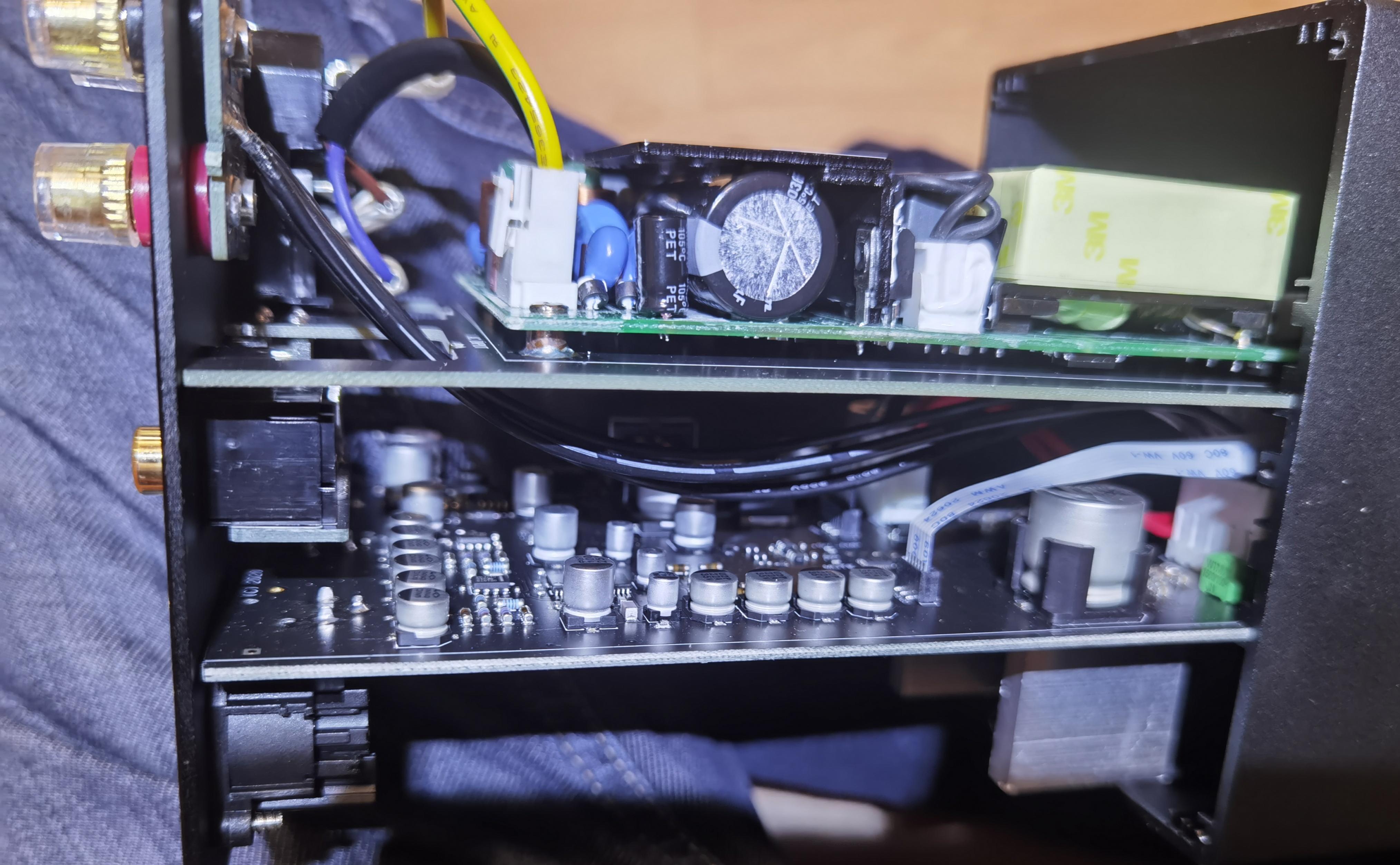

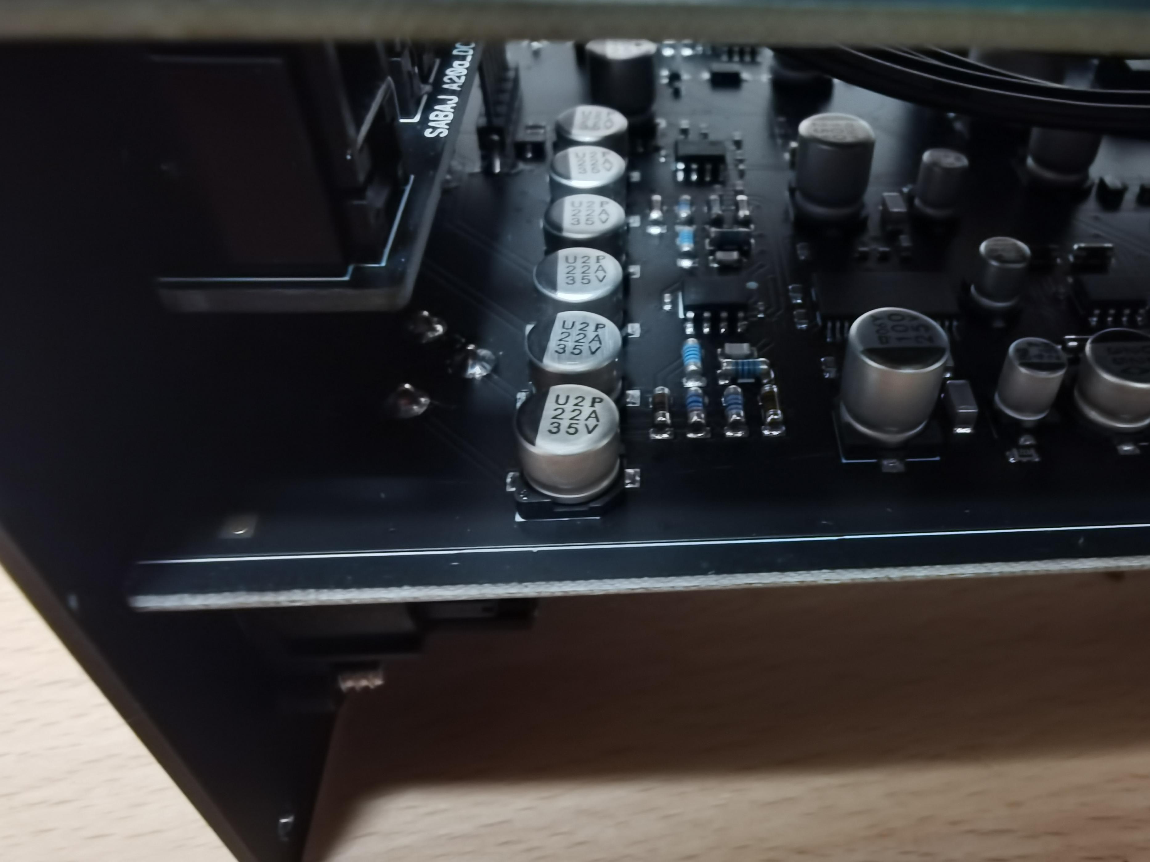

Could you please share some pictures of the internal unit ?
I unfortunately did not have time to disassemble it and I would be curious to see the OP amps inside )

I made some pictures, opamps are op1678. On one pic there is a row of 6 lyrics on the left, these are the input caps for balanced and single ended. Good quality board and components, they even use melf resistors.
Unfortunately the little adjustment potentiometer is located at the end of the power supply, so you have to pull out the boards completely out of the case in order to change the voltage. There are two ribbon cables which have to be unplugged at the boards, but it is a PITA to get them back in.

I was thinking that the first mod to perform could possibly change the PSU which is a Morsun @ 350W with PFC support
The Meanwell RPS-400-24 PSU should fit and seems to have almost the same size / frame :
- It has a better Ripple&Noise
- They can reach 250/470W short term before going into hiccup mode (200/385W@Mornsun LOF350).
- The Morsun is certified CISPR 32 vs CISPR 11 for the Meanwell = better against EMI
