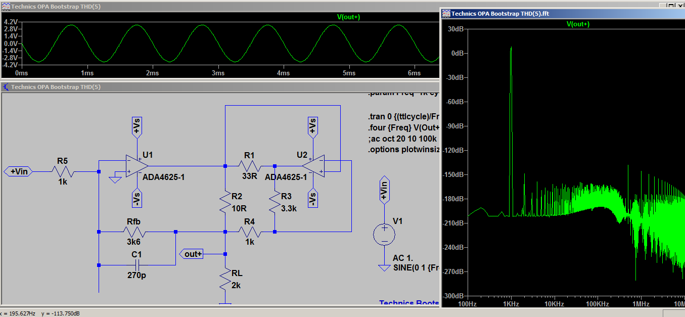

Enjoy EUVL's modeling skills !
  • Technics OPA Bootstrap THD(5).asc
Looks fine as far as it goes - AD797 wouldn't be my first choice for I/V though. JFET input opamps tend to be more resistant to RF (very high frequencies come out of DAC chips) than bipolar ones, or use a CFB one.
Thanks. The circuit came from the datasheet of AD797, there is an example with AD1862 DAC what is almost the same with the AD1865. I will try another opamp, remove the capacitors, what EUVL suggested.

Thanks ,the Technincs schematic was to complex for me. The circuit in Ltspice model is the same? This is what I need?
Well...electronics is a complex science...You first need to read all the documents and put them together in your head, see the similarities ad the differences and work out a solution for your dac.I'm sure that your dac is using the input op-amp of ad1865 , it's also using an output double op-amp which looks like an opa2134(identical pinout with opa2132), so you only need one more double power op-amp like lm6172 on a small board with those resistors and capacitors and some wiring...

The circuit in post#1 is not an IV.
It is merely a first order RC filter after DAC voltage output, followed by a voltage gain stage.
If you wish to use voltage output anyhow, you can take a look at our discrete 3rd order Sallen Key filter for the AK4495.

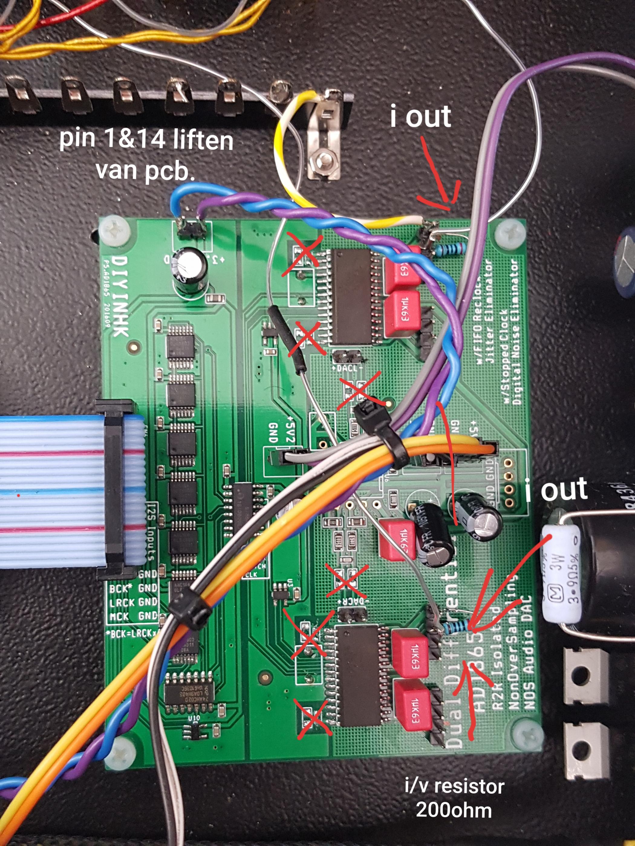

Hi! did you already have this dac running? I have the same board here and runned it with a tube i/v (lampizator style). Did some tweaks like lift the sj pins and used I-out, etc. After a while I ditched the project, I couldn't get the SQ even close to my single deck DDDAC.
I have this DAC board, but I did't modified it. Thanks to Democles I've built another AD1865 DAC. I wasn't sure that after the modification of the DiyINHK DAC will be better than the factory version.
If I understood, well you have same experience? After the modification the sound quality didn't improve too much?
In the original state I wasn’t thrilled by the sq. I used Salas ultrabibs to power it, the 3.3v line with a LT3042 and a Allo USBridge.
So I went for the tube i/v. It was certainly better but stayed way behind my other dacs.
