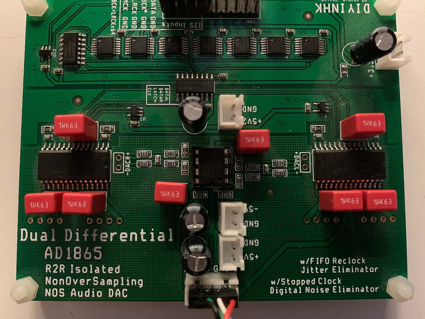

I have this DAC board, and I want to improve the output stage. My goal is a bigger sound stage, better separation between the instruments..
For the first step I don't want to spend too much money (for example output transformers, with vacuum valves etc) therefore I'm thinking about using the same voltage output of the dac, but I want to use better quality and through hole components, and if it's exist, a better circuit.
Any suggestion, schematic etc. would be appreciated. Because I'm not an expert I want to keep it simple 🙂
I tried reverse engineering of the output stage of the dac board.
View attachment IV_Schematic.pdf*
* It's not an I/V converter, this is the output stage of the dac board.
Is it recommended to using separate power source for the analog part of the DAC chips, and for the output stage? Because currently it's common.

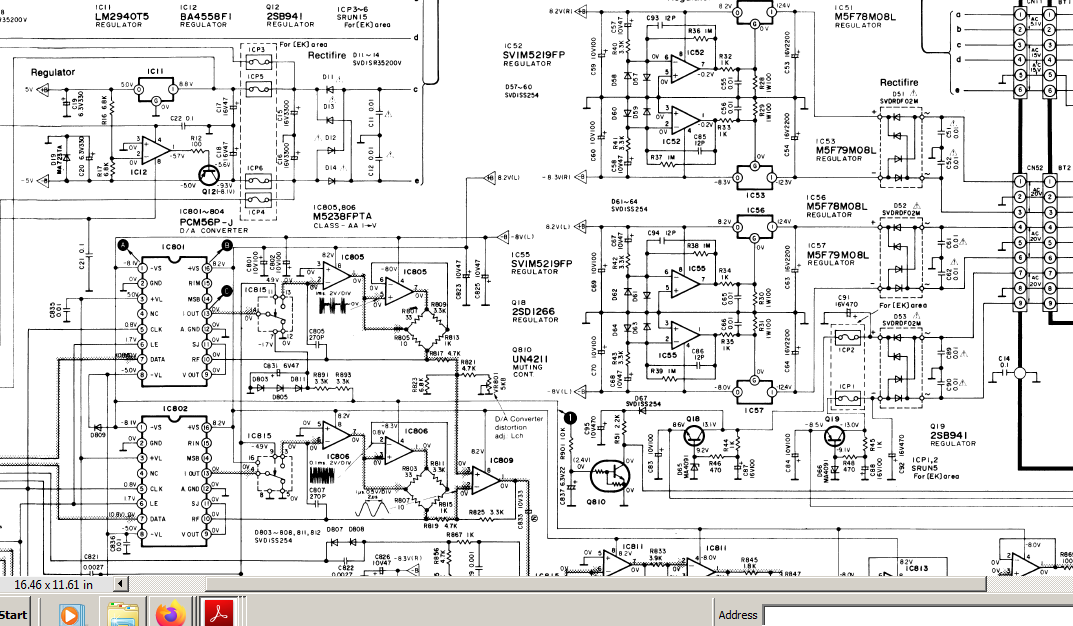

Honestly...this is exactly what you need:
Download and read Technics SLP-990 service manual schematic
TECHNICS SL-P990 Service Manual download, schematics, eeprom, repair info for electronics experts
download pcm 56, pcm61, ad 1860, ad 1865 datasheet.
They are all basically the same thing, except ad1865 has two ad 1860 in it.

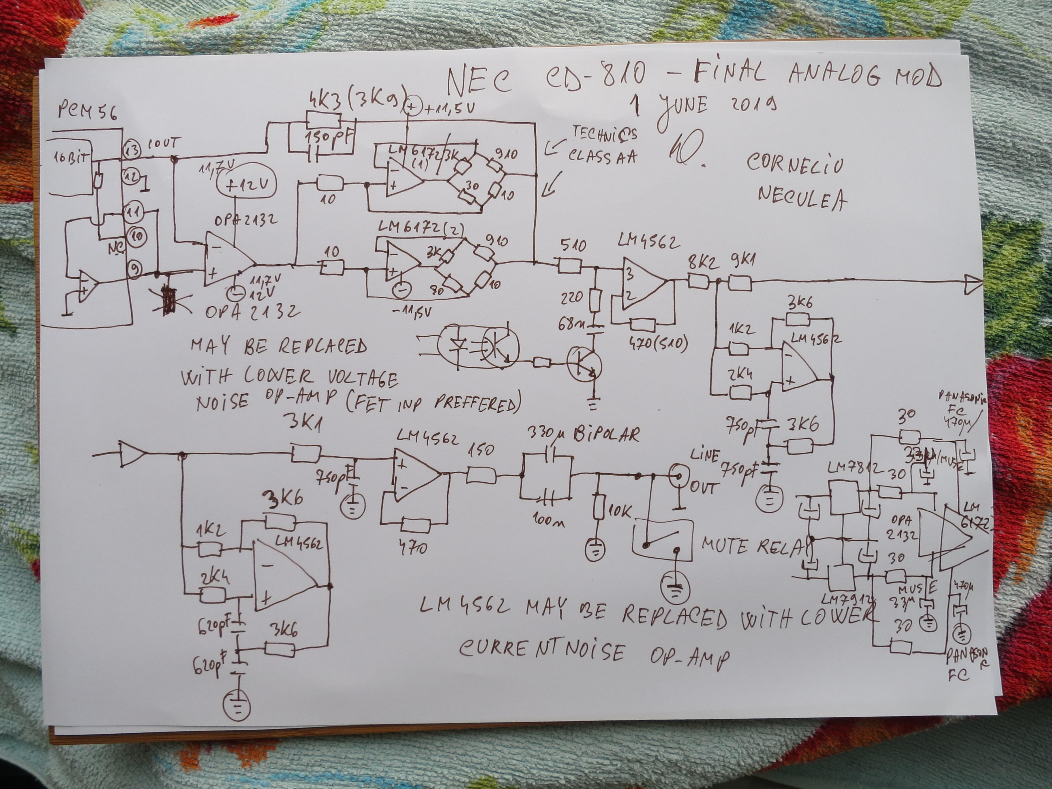

Build the Technics version of I/V converter.I did it in single ended topologies based on pcm56 for an older cd-player NEC cd-810.I also used the internal op-amp of that dac as vref for an external op-amp...It's your choice here! Here you have the whole discussion on how to use a fairly low noise fet input op-amp(opa2132) and a very fast and powerful bipolar op-amp for the second op-amp(Lm6172) including its own sub-base mods , thus circumventing each op-amp's weakness and using their best attributes in the compound op-amp circuit:
https://www.diyaudio.com/forums/digital-source/338152-nec-cd-810-revival-mods.html#post5809151
And here's the simulation made with the precious help of EUVL simulation model:
https://www.diyaudio.com/forums/ana...amuel-groners-super-opamp-18.html#post5810841
I can guarantee that the result can only be awesome by following Technics (some say Sandman's stolen )notes.
Believe it or not this was the most advanced I/V circuit ever to be manufactured by a company and i personally doubt that any other solution is more faithful to the sound reproduction.
As you can see it's not useful just for i/v stages as Technics used it in every single analog stage in their best players up to SLP-1000 and SLP-2000 model.
Just be warned that this I/V stage doesn't have any musicality of it's own, you only get out of it with the music you put in it!
