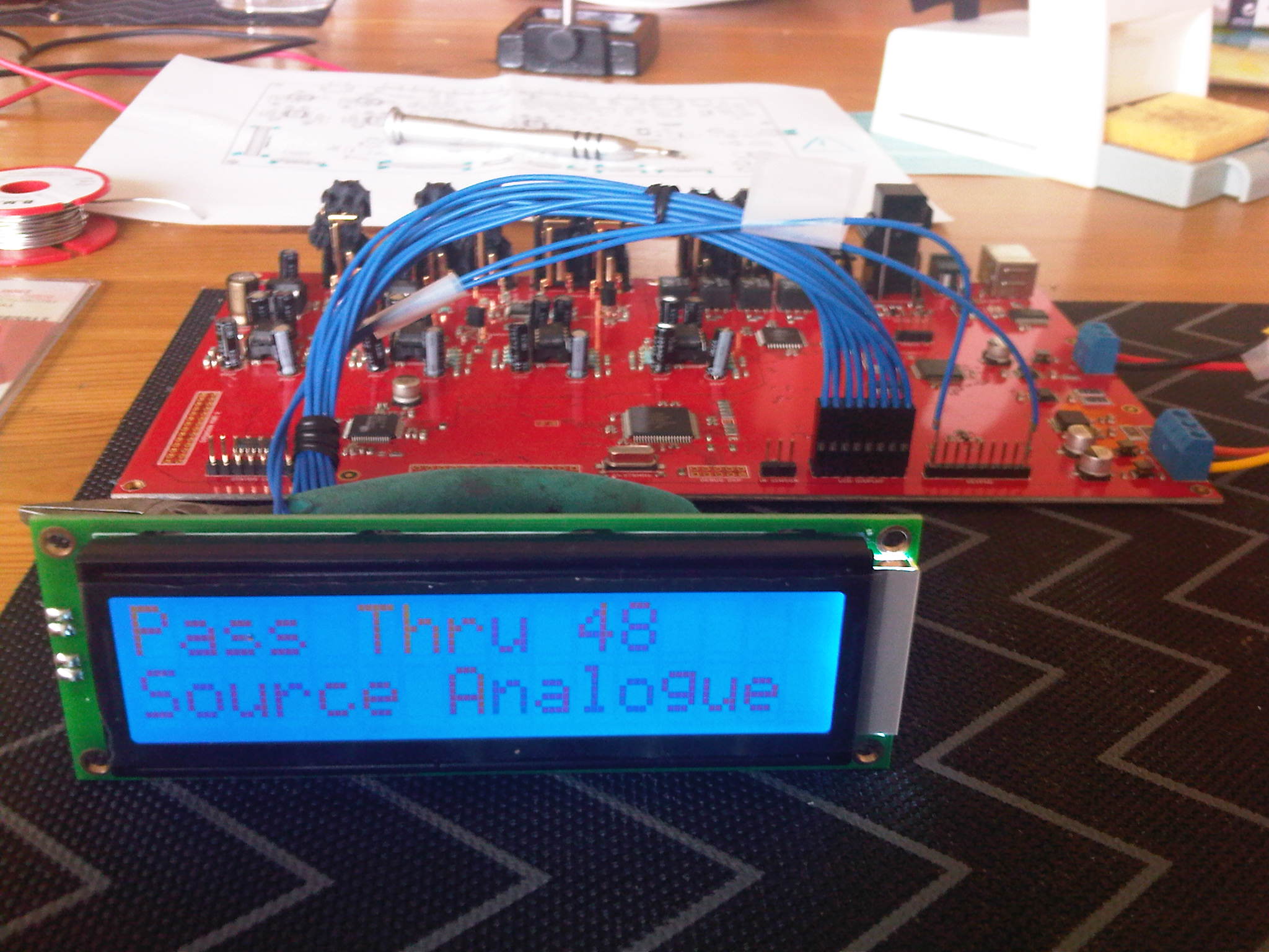

Hi Nick,
This morning I've just tested the card after cabling the LCD and the stanby button with Dupond cable.
I've double checked the PSU connection also ... and it worked 😎

Nice work. Wow, how big is that display?

Hi Speedysteve7,
Nice pavillons 😎
PCB of the LCD is 106x44 display char section is 94x20, see link of the datasheet,
the angle of the picture make it bigger LOL.
http://www.zyscom.pl/katalog/wc1602big.pdf
I've bought it on Ebay, search ZYSCOM LCD Display HD44780 2x16 chr 16x2 Blue STN White Backlight BIG 9mm char
Pin assignment is pin to pin the same than the Najda card 🙂

Looks gorgeous Pascal, thanks for posting the pic!
