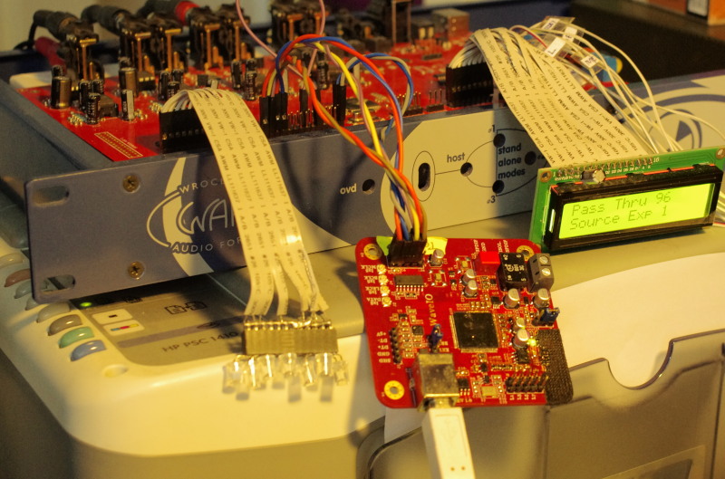

A quick update on the WaveIO/Najda coupling. Sigi had already posted here his findings, but as Lucian (from Luckit, the WaveIO manufacturer) sent a board for testing, I thought that I'd report too.
So I'm happy to say there's no problem whatsoever. The picture below shows my quick and dirty test setup.
There are 4 pairs of signals running between the WaveIO and Najda: Data, Frame Sync and Bit Clock (all with their individual ground return) - and a 4th pair as described below.
The WaveIO is equipped with a bus isolator that must be powered with the external device's supply. That's the 4th pair of wires, in the present case +5VD and DGND pulled from Expansion Port 1 (you could also use +3.3V instead of 5V).
Last thing you can see on the pic is the purple wire loop. That's the connection of IS_EXT1 to DGND (both on Expansion Port 1). This is required to let Najda detecting a I2S input source.
Najda board well received Nick, thank you. Beautiful card, very professionnally packaged.
Great to hear, thanks Jean-Louis!
That's great news Nick. will there be any issues supplying 5v from the Najda on board regulator? I believe the WaveIO draws over 400mA
So this 5V supply I was mentioning is just the isolator chip supply (IL715, see the WaveIO doc for details). The WaveIO board in my setup is powered by the laptop USB port.
If you don't want to power the WaveIO via USB, you should pull a wire from the power supply. +5VD on Najda doesn't go through a regulator, but through a small inductance which is rated for 320 mA. So if you power the WaveIO from Najda's 5VD, you might fry this inductance...
