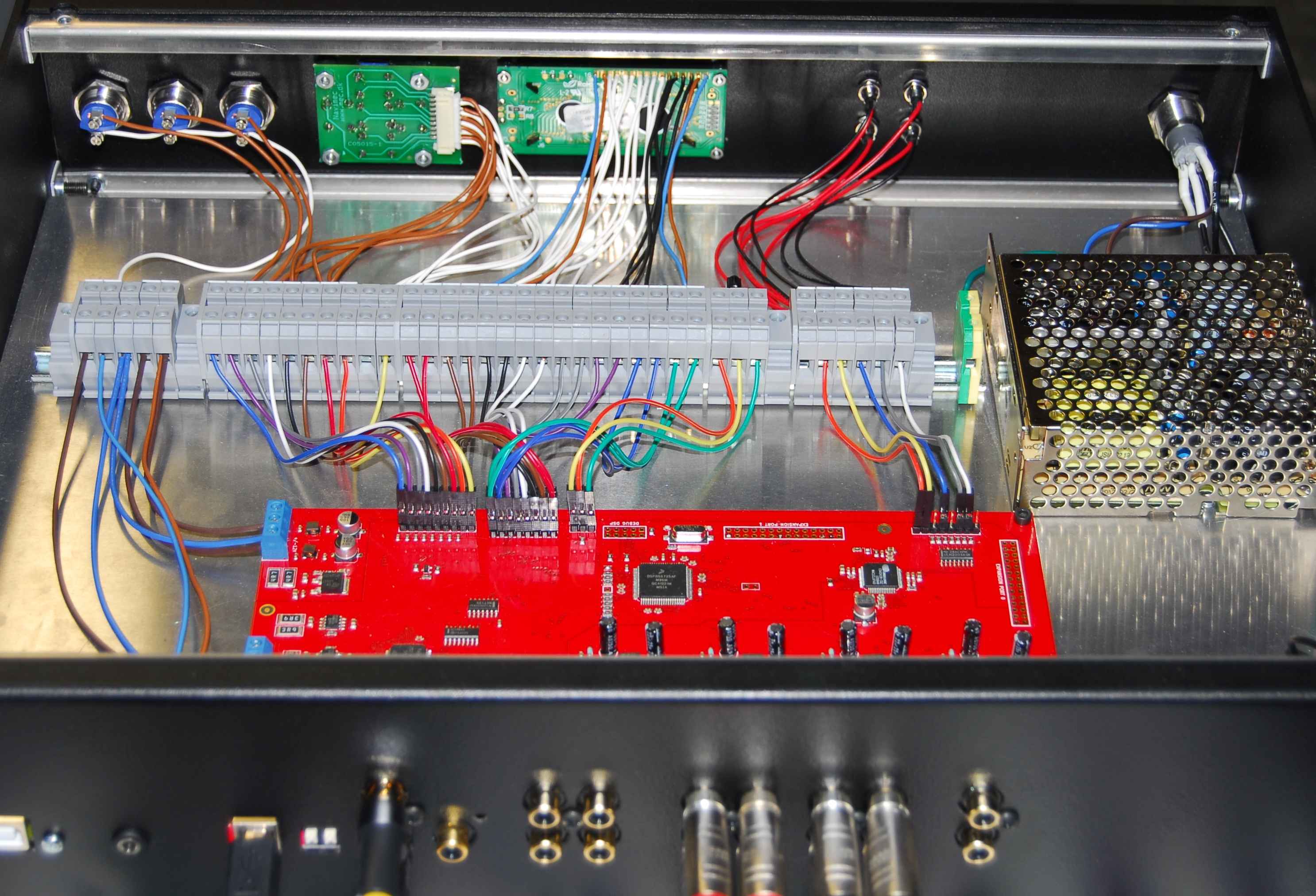

Im going to use a meanwell 35b,
It will physically fit in the enclosure, my concern is about radiated emf and similar, will the close proximity to the board cause interference with the Najda sound?
It will be within 10mm or so, the PS has a cage around it but Im not sure if that is enough shielding.

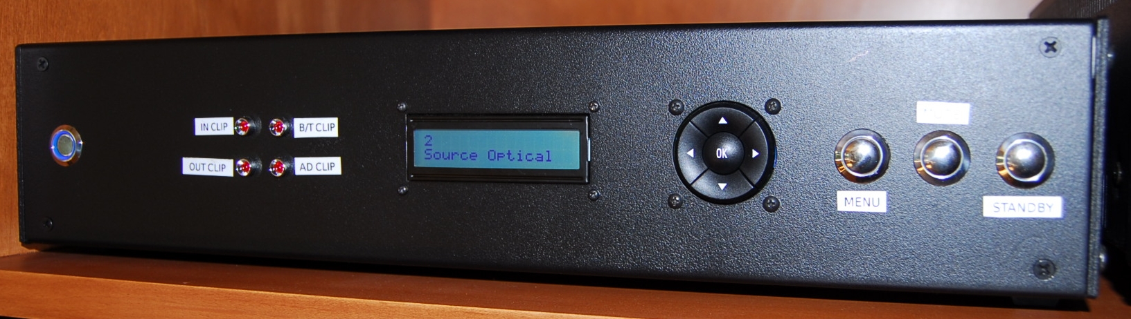

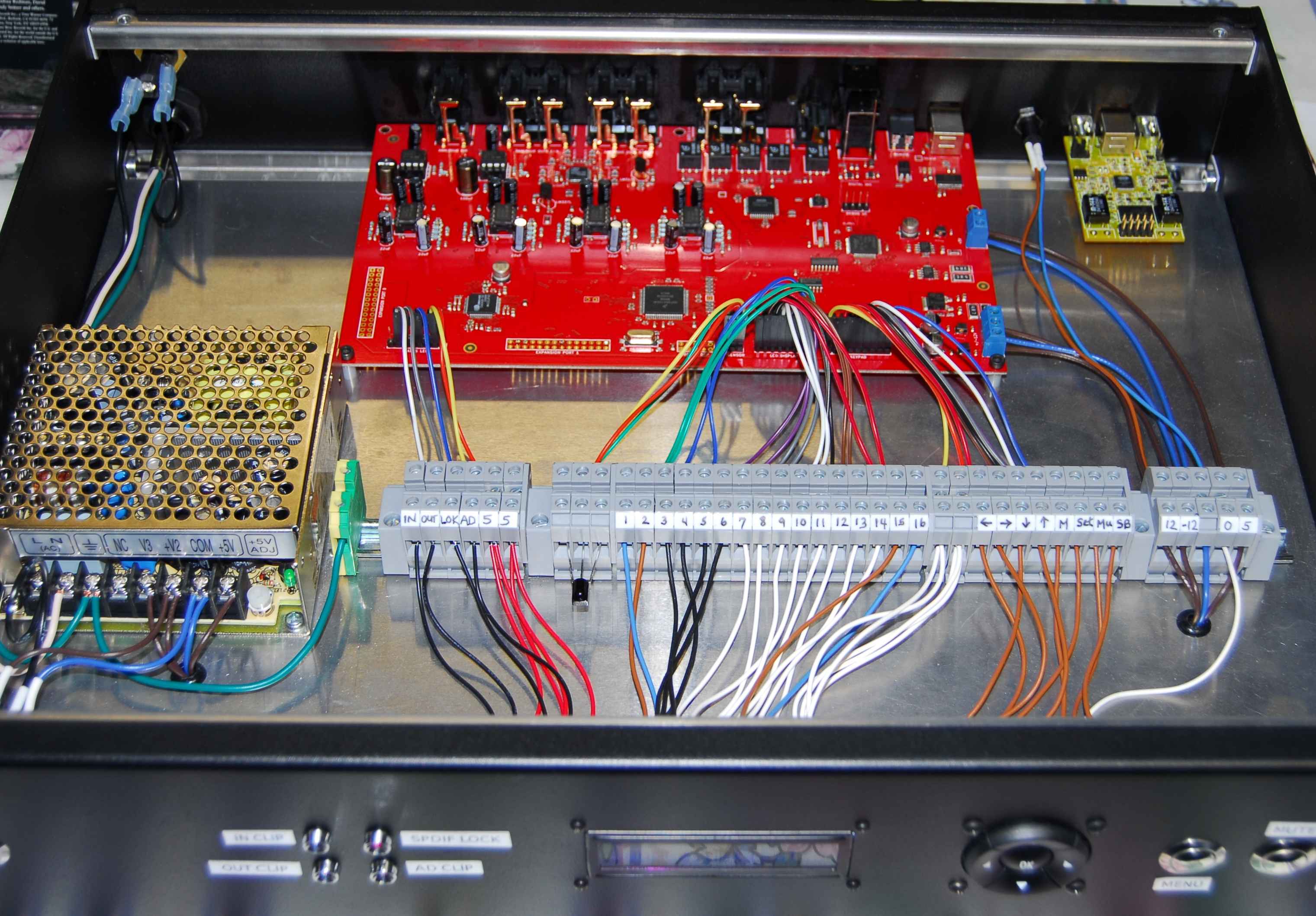

I’ve been using Najda for a couple of weeks and I would like to add some comments. I often think about how difficult it is (was) to design speaker filters with passive components and smile.
The board frequently indicates bass/treble clipping on all input sources. I have been slowing adding input attenuation to reduce it. Is that the correct solution?
A Meanwell RT-50B power supply works fine in this application. I like the screw terminals. The extra power is available for expansion, like the USB/I2S adapter. I’m also remotely controlling 2 amplifiers with 12V.
The MEC 5-position-switch buttons make an annoying clicking noise. The mounting holes for the MEC PCB are not concentric around the buttons. I chose Bulgin PB switches (MP0042/2) because of the screw terminals. They have a very small flange that requires a tight hole. The maintained Bulgin switch (MP0045/1E2BL012) requires a skinny fingertip (power switch).
The Newhaven NHD-0216XZ-FSW-GBW LCD display works perfectly.
I would prefer closer integration of the “menu” button to the 5-position switch (see wish list below).
Old habits die hard… I often have the impulse to quickly turn down the volume with a rotary control.
The Vishay TSOP38238 IR sensor works through the enclosure ventilation holes but the distance is limited to the listening area, but not my kitchen table unfortunately. I’m using a universal remote that is provided by our cable TV service.

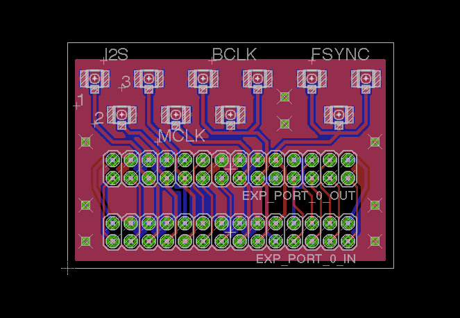

I’m glad the USB/I2S function is working now. I’ll hook it up again soon.

Hi Donald,
Thank you for your feedback. I like a lot your implementation, it's looking clean and great! And the wiring system is smart and original.
I need to look at what's going on with the bass/treble section. Jean-Claude had already reported a phase issue. In the meantime, if the led is bothering you, you can disable the whole bass/treble section in the software.
Great to hear this power supply is going well with Najda. I'll add it to the list of compatible parts.
It would work much better if you could drill a hole on the front panel and place the IR sensor behind - you probably knew this already 🙂
Actually, when you store a preset on the board, it's saved immediately. What is saved when you go in standby is all you can modify with the remote controller or keypad, i.e. volume, bass/treble, balance, LCD contrast etc
Najda is like a small computer: it's booting and shutting down. You should always go into standby before you turn off the board. The shutting down procedure isn't just saving into the eeprom a few parameters, it's also nicely shutting down all the chips onboard.
So when Najda is booting, it's reading in the eeprom what was the preset in use the last time it went into standby, in order to load that same preset. If you short-circuit the shut down routine (standby), then Najda might read in the eeprom something which is actually not the desired preset index. So please, always turn off Najda by going into standby, it's so easy: a single keypress on the keypad or the remote controller.

Hi Beau,
Frankly, your enclosure is too tight for Najda. If there's some imperious reason why you'd like to use that one, such as integration with the rest of your system, then placing the PSU underneath is your best option.
I'd recommend however you look at other cases. How about the offerings at Altronics?
