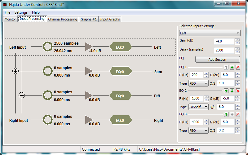

We're getting ready to release the software, so I'm posting a couple of screenshots of the IIR filtering mode (which is coming on top of the FIR Engine mode described earlier). If there's enough interest, we'll add gradually more meat into the software
Well for now it's a classic IIR. The input section:
So this is where it's all starting. The user supplies a stereo pair of inputs, and Najda transforms this pair into 4 separate signals (L, R, SUM, DIFF) with their own processing path.
In the above screenshot, only the Left channel processing path has something relevant in it (i.e. the other channels are unprocessed).
Processing begins with a 2500-sample delay (max 8191) followed by a -4 dB gain, and a set of 3 second order sections.
The second order filters that you have here are the ones that all of you have used: peaking/low shelf/high shelf. The peaking filter has of course adjustable Q factor and the shelves have adjustable slope.
I'm often asked: How many filters per channel do I get?
Well, Najda doesn't use a fixed processing path. You can see on the screenshot above the ADD SECTION button. Click this button and the application will add a filter to the selected channel. Click this button as many times as you like, there's no limit (well we've set a limit of ten for the sake of wisdom, but we could extend this to virtually any number).
Now an important point: you might remember that the monitor tab shows the DSP load. It's the user responsibility to make sure that the processing he's devising doesn't overload the DSP. In other words, while the user is adding filters, he should check the DSP load meters and make sure they stay below 100%.
This flexibility feature allows distributing the processing power where your system needs it instead of allocating a fixed number of filters to some channels you might not even use.

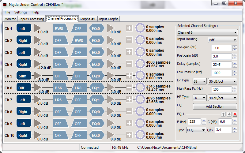

The next tab is the output processing.
On the far left, you're routing the signal. This means that you select one of the 4 processed channels we talked about earlier (Left, Right, Sum or Diff).
Routing is followed by a Pregain, then a group of 3 IIR blocks.
First block is the LowPass filter.
Second block is the HighPass filter.
Supported filters are
- Butterworth 6/12/18/24/36/48 dB/oct.
- Bessel 12/18/24/36/48 dB/oct.
- Linkwitz Riley 12/24/36/48 dB/oct.
Butterworth cut-off frequency is where the response is -3dB, as usual.
For Linkwitz-Riley, we also use the classic cut-off at -6dB.
Bessel filters are phase match - so there's no fixed dB number at cut-off. Instead, a low-pass and a high-pass with same orders and cut-off frequencies will have phases that are a multiple of 90 degrees apart at design frequency.
The cross-over design follows the same principle as the filter section I described earlier: a by-pass doesn't use processing power, and the higher the filter order, the more processing power it burns (so always check the DSP load meters!).
The crossover block is followed by the EQ block (peaking/shelves) which is identical to the one on the input processing tab.
Then you get the PostGain, the channel polarity invert and the output delay (4095 samples max).
As a quick and dirty example, here's what you can read on channel 6:
- Routing is the Diff signal
- Pregain -4dB
- Low pass F=1000 Hz Bessel 36dB/oct
- High pass F=100 Hz Linkwitz-Riley 48dB/oct
- Only 1 EQ section(it's a good driver
- 3dB PostGain
- Polarity inverted (don't ask why
- 2345 samples output delay, which is 24.427 ms at 48 kHz sampling frequency.
Of course, the whole processing can be viewed on the graph tabs.

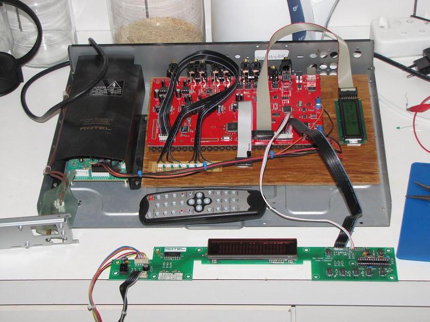

Some tips for those assembling a unit with Najda DSP board (as a beta tester I had early access to one).
The main parts you will need are:
The project documentation is very good. I highly recommend that you read it through at least once before you make any attempt at assembly.
The component legend printed on PCB does not clearly show the pin markings and IDs, so you must make use of the supplied diagram in Appendix_B_Pinning_Power_Supply.pdf.
Your power supply must comply with the specification described in the Najda_Startup_Guide.pdf.
The headers on the board are of the type with 0.79mm square pins and 2.54mm spacing. Essentially, you need a plug to connect onto it (you could solder wires directly onto these pins, but I would not recommend this, as it is messy, and the exercise would increase the possibility of damaging the electronic ports through ESD). Here are some options: (1) buy some cables with pre-crimped plugs at the ends (2) assemble your own, for which you'd need to select the correct plug bodies and crimp contacts, as well as a suitable crimp tool (3) use old-school ribbon cable and ribbon cable connectors (IDE-style); these you can crimp in a bench vise.
LEDs and pushbuttons: Connecting up the LEDs is straight-forward. The Najda_Startup_Guide.pdf describes wiring very well. It is the same for the pushbuttons (it is not matrixed like a regular keypad, that's why I'm not calling it a keypad).
IR sensor: match the header pin allocations vs the IR sensor's pin-outs and connect accordingly.
IR remote control: the remote I used belonged to a old TV card. Check that the remote you use has a sufficient amount of buttons to accommodate the functions of the Najda system. My own, I found, uses an NEC protocol. It is very easy to set up; just find the remote setup in the menu and follow the prompts.
LCD display: This must be of the type that has 2 rows of 16 alphanumeric characters, and must have a parallel data interface complying with the HD44780 driver chip. It must also have back lighting. The one I got has very low efficiency back lighting, and I would appreciate recommendations for better-performing units from you guys. I chose my LCD display primarily on the basis of pin-to-pin compatibility, so I could plug directly into the Najda DSP board with a 16-way ribbon cable. Note that other compatible LCDs may not have directly-corresponding pins, and therefore cannot plug in directly, without rerouting the wires. Also - very important - note which side of the LCD display connector is the right side up. On my own LCD, the pins are read from the front. But do check what is correct for your own LCD. In order to plug in correctly, I had to use a 90 degree header, because there would not be sufficient space next to the LCD module to plug from the front. Again, there are other numbering schemes, so check your own. I would have loved to use a VFD (plasma) display, but compatible models are rare and expensive. Please share if you find any at a good price.
Startup: Najda DSP starts up in standby mode, so once power is applied there are no signs of life*. To get it going, push the STANDBY button. Then the LCD back light will turn on, the LCD will display the firmware version, and one or other LED will flash momentarily.
PC installation of the Najda configuration application: the USB driver software is available from here D2XX Direct Drivers. I opted to use the executable installation download. Although the driver got installed by this application, the Najda software would not run until the driver was fully configured. This required the Najda DSP to be connected to the PC via USB cable.
Saving your configuration: After making any adjustments to the system variables (volume/bass/treble/balance, etc. and programming), you need to set the system into standby mode, during which process the settings/configuration will be permanently stored in memory.
That's all I can think of, for now. Good luck! Here are some photos of my own setup in an intermediate (test) phase. (I hacked the chassis on of an old Rotel DVD player, and used the existing power supply and push buttons).
*Actually, to be more correct, it powers up in the same condition as it powered down. But the manufacturer's instruction is that the user should always switch to standby at the end of a session (and do not power down directly), due to some internal operations that need to happen at the end of the session.
