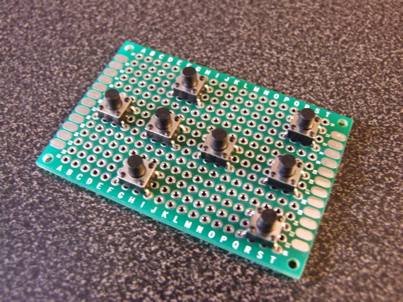

Your pushbutton setup looks good!

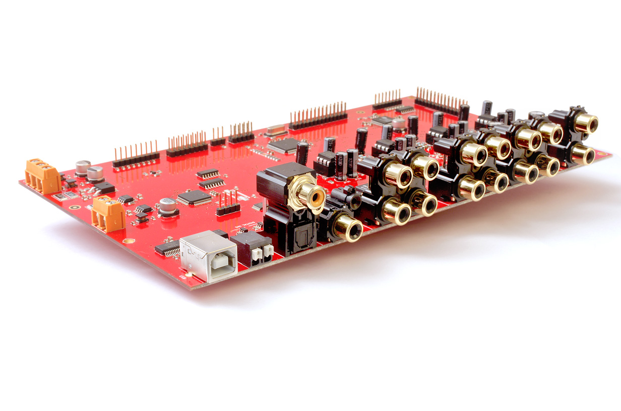

By the way I received yesterday the production sample, finally 😀
Pictures coming soon!

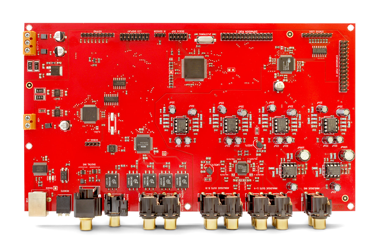

Dimension
Great looking PCB board, could you provide the dimensions?

I'm old enough to have my eye sight dissapering, this was a reminder of that 🙁
Actually tried a magnifying glass in front of the screen 😱 Anyway, I'm looking
forward to some more pictures 😀

if you click on it, it should expand to a reasonable size.
