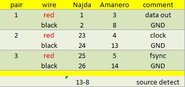

I am about to receive Najda board and I am preparing for assembling.
Could you be so kind to confirm pins when connecting Amanero with Najda expansion slot?
I know that it was discussed earlier but I am not sure if I got everything right. I have also prepared easy-to-follow table to contribute something new

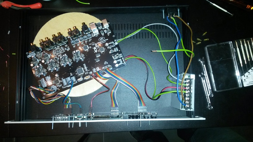

I am almost ready to fire up najda for the first time, but I'm not 100% sure about the grounding. Maybe someone here can answer my noob question?
I attached +-12V ground on cosel rm15-a to najda +-12v ground
+5V ground on cosel to najda +5 ground
There is still a ground wire from the IEC socket and there is still a Flouting ground on the cosel. I read here to attach the IEC ground to the case for safety, do I also attach the Flouting ground from the cosel to the case?
It looks like you have made the right connections from the power supply to Najda although it is likely the grounds are connected inside the power supply anyway and you would only need to connect one ground wire from the power supply to Najda for it to work.
The spare wire from the IEC connector is for safety ground and should be directly connected to the chassis with a bolt, nuts and lock washers. Any paint or anodizing needs to be scraped away to form a good electrical connection as this connection is what will save your life if the case becomes live somehow.
I had a quick look at the datasheet for the RMC15-A1 power supply and there is very little information other than a label for the outputs you should not need to connect the floating ground to anything just AC live and neutral.
Please be careful as from your post it does not seem that you are very familiar with mains wiring. Getting this wrong is not really an option.
Perhaps it would be a good idea to post a picture when you have it connected that way it will be clear exactly what you have done and someone may be able to double to check it for you.
