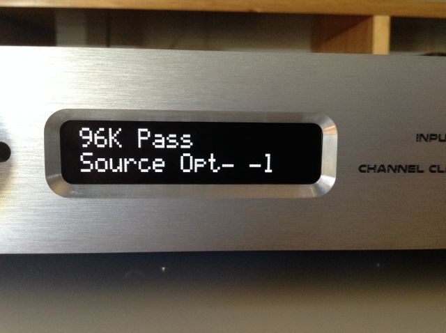

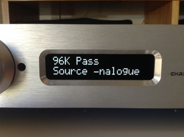

Weird Display Problem
My Najda has developed a slightly strange display problem where some of the characters are corrupted and not displayed correctly. I have attached some pics to show what I mean.
It was not like this when I first built it but seems to have happened after I have connected Najda to a computer. My laptop likes to go to sleep and when this happens while connected to Najda it seems to cause some strange effects and DSP overloads.
Is there a way to reload the firmware from NUC to see if this clears the problem or do you have any other ideas on what could be causing it?
It is not a huge deal as my preferred input is Exp 1 which is not affected but I would like to fix it up if I can.

Hi Fluid, I'm experimenting exactly the same display problem with the "Analog" input !!
Oops! That is weird 🙂 Probably a bug introduced when I made the source labels customizable. I'll check what's going on and fix that.
In the meantime, see if you can overwrite the labels in NUC (Settings -> Display Options).
You should not let your laptop go to sleep while a session is ongoing. It's like you're sitting with a mate, having coffees and you're telling something, and your mate is suddenly falling asleep on the table. Not good 🙂
Anyway, I'll see if the Najda can detect that the Host is going to sleep mode, that's not obvious.

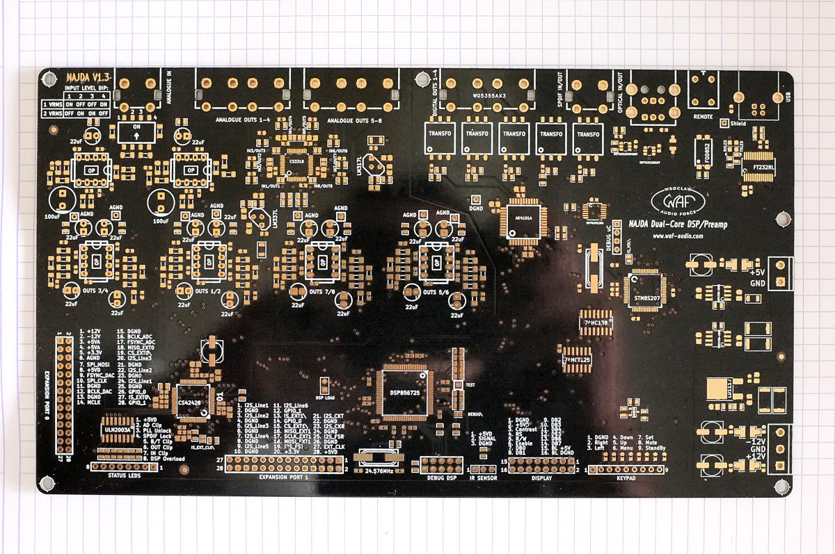

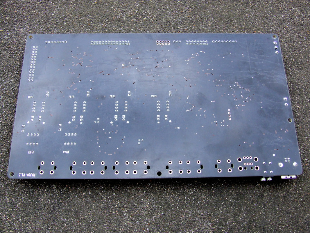

I've finally received the new PCBs, that's HW revision 1.3. Going to assembly this month.
I just had a similar issue with my najda. The display was getting corrupted and also had heavy overload cpu usage and issues connecting to the NUC software. I found the problem to be some solder bridging 2 pins of the chip where the usb gets connected. Desoldered it and all was good again. Looks like it was disrupting the data transfer to the board and who knows what else.
I should have tried changing it myself in the software first!
For some reason Analogue was blank in NUC. I changed all the labels and now they read properly.
Might be worth putting a line in the guide to avoid letting a computer go to sleep while connected to NUC seems to do weird things.
What has been changed in HW revision 1.3?
Changes for HW rev 1.3 are:
- Adjustable analogue input level (1 VRMS / 2 VRMS)
- Extra toslink output
- PCB and parts improved

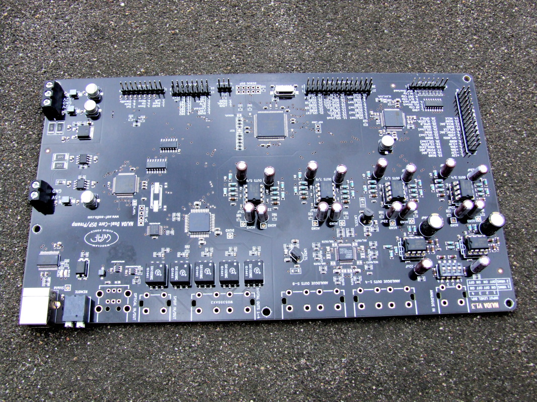

I've received many emails asking about the availability of the new hardware revision. I've received today pictures of the first boards that were finished at the assembling plant. I think it looks good 🙂
As you can see, audio connectors were not assembled because that's a frequent request. One special feature about the assembling, is that through-hole components are wave soldered (vs. manually soldered on previous batches). The benefit of wave soldering is that all joints are clean and trouble-free.
Another change you can note is the use of tulip-style sockets for the opamps.
Analogue expansions will follow next 😉
