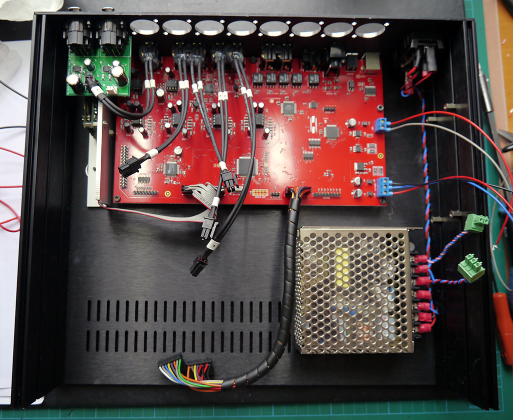

you made a lot of nice things round the Najda. Your Navigation Board looks high-profession. What i not understand in the thread, where do you pick up the Signal for your balanced output boards?
Best regards
Dieter
To be fully undo-able , I soldered shielded cable directly on the back of the RCA connectors and I put some hot glue for mechanical reason. Everything could be removed nicely and both unbalanced and balanced outputs are functional/
JC
Hi JBS,
I did some additional sym input and output boards (see post 1356) but unfortunately I don't have any sym output pcb left. If there are enough demand I can re order some pcbs though.
JC

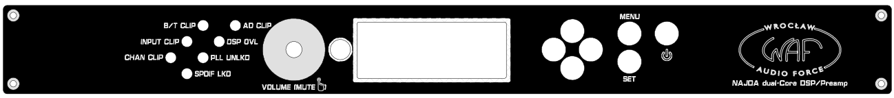

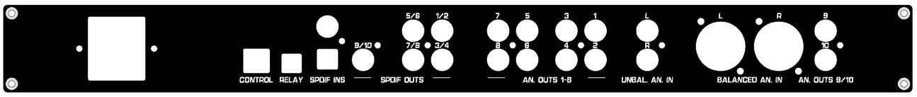

hi nick,Here are suggestions for the front and rear panels (1U):
I'll prototype these panels, further to what I'll make the files available - so you could modify them to your taste and have your own panels manufactured.
Nick
I have one of your control boards and constructed as your instructions ( 2 nuts as spacers between pcb and display ).do you have 3d or .fpd files for the front panel as pictured #2203 .
