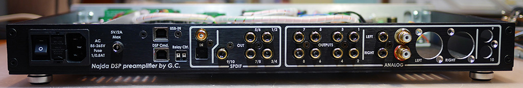

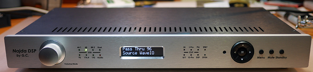

I've completed my second set of Najda and the challenge was this time:
1U cabinet, external low jitter clock ready, WaveIO USB board, Najda symmetrical input expansion board ready, optimization of cabling in the minimum allowable place.
Here are low resolution pictures of the front, back and top
I choose a slimline 1U 230 mm deep with silver 10 mm front panel from Modushop cabinet which is very nice to work with. I also use their new digital printing offer. Of course, milling on both sides of the front panel, back panel milling and digital printing had a cost (about 300 €) but I like the result.
Note that I had some minor problems that I will describe in a subsequent post

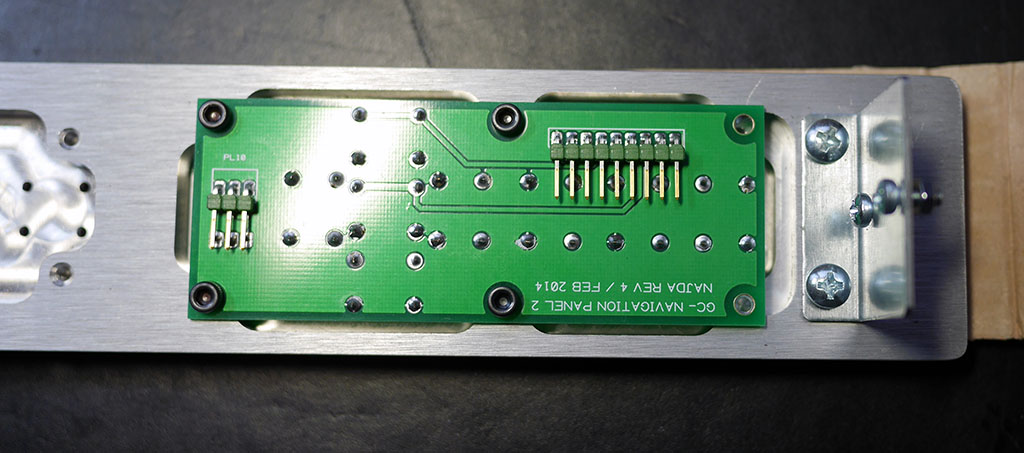

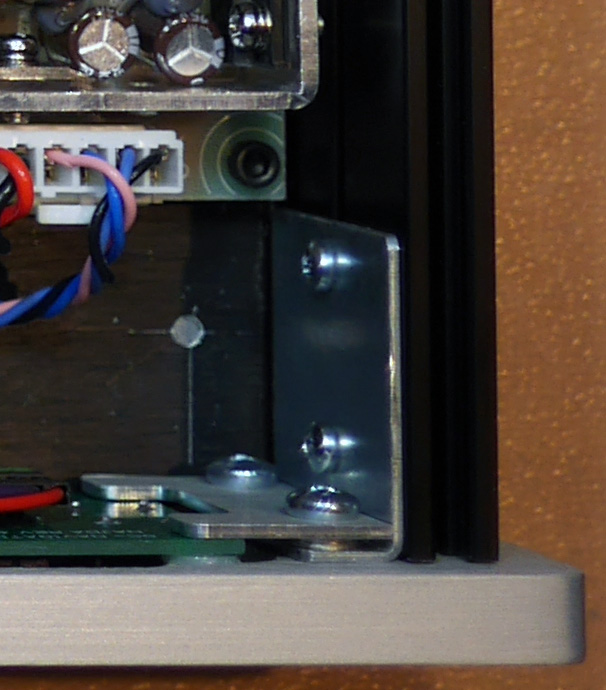

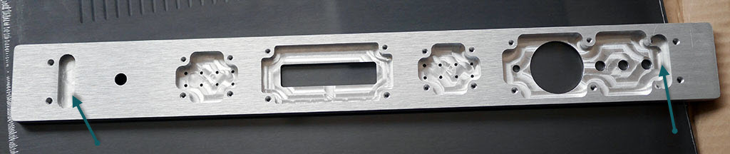

I would like to warn people interested in such a nice cabinet (Slimline with 10 mm front panel) that there are some milling made on the inside of the front panel which are undocumented in the original dxf files that could be downloaded from the web site. You can see on the picture were the arrows are !
So, I was not able to fix correctly my navigation panel but Modushop handled the situation quite nicely. I designed a small work around part that correct the problem (see the closup). They made it very quickly and sent it to me for free.
Note that, on my request, they have put today in the download section of the web site a new file with all updated 1U, 2U, 3U & 4U 10 mm front panel to avoid future problem.

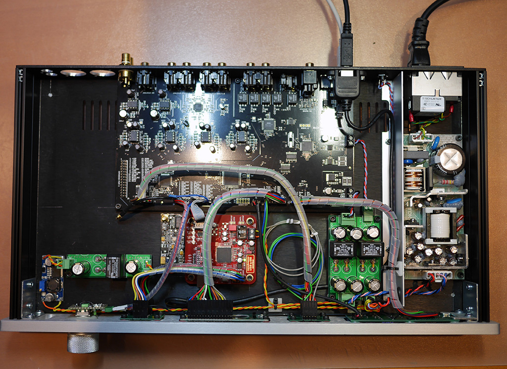

Hi Jean Claude,
Very nice chassis, I see a family resemblance 😉
The Digital printing is a nice option.
Is that a filter or something else between the SMPS and the Nadja?
Hi Jean Claude,
Yes, this is a C-R-L-C filter I designed. The idea was, beside further filtering the TDK SMPS, to provide some kind of isolation with other devices. In addition, on the 5V side, the double choke provide some separation on the ground side too. It could be specially interesting, if your SMPS doesn't provide separate ground between output voltages.
For the Najda board, R = 0 to avoid too much drop-out voltages and chokes values according to the current outputs (2 x 4.2 mH for the 5V, 2 x 15 mH for +/- 12V)
For the external low jitter clock, I cut a pcb in half and use 47 Ohms and 2 x 47 mH). With those values, I'm under 1 mV peak to peak of residual noise.
