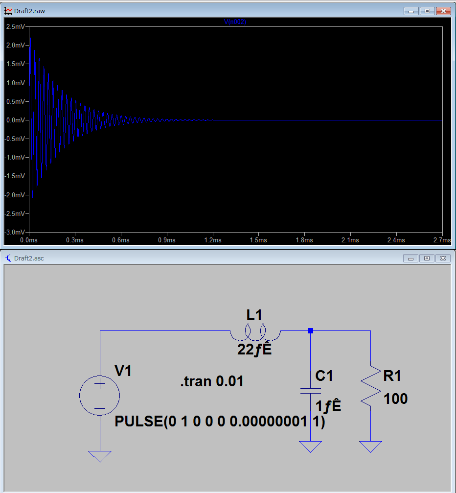

You do "pulse height control" in a way that is equal to analog amplifier. You will have the finals open only partially and disipate heat like any AB class.
Also I thought that you have solved the PCM-DSD part. Wasn't that what you where after at first?
And yes, straight DSD is not easy to control in volume.
Pulse height control is..
DSD(1/0)*(V1*C1+V2*C2+V3*C3+V4*C4+V5*C5+V6*C6)
C1-C6 is 1/0 control from PIC(ADC), does not changes while volume is not touched.
V1=1/2Vcc, V2=1/4Vcc, V3=1/8Vcc...
So this is not related to audio frequency, only effects DSD frequency.
DSD amplifier can be un-linear (but to be controllable), for example, +-0.1V pulse in -> +-0.5V final out and +-0.15V pulse in -> +-0.77V final out, is terrible distortion in analog amplifier. but no problem in DSD amplifier.
Before LPF, there are no analog signal, only DSD pulse. attached LPF output from single DSD pulse - it lasts some msecs.
Then thousands of this impulse response will be summarized to final analog(audio range) signal.
So DSD amplifier don't have to work like analog amplifier, just should be fast enough to process DSD.

I don't care partial or full...
This amplifier does not require Amplitude Linearity.
If this amplifier has terrible 2nd distortion like below (actually not)
input +-0.5V -> output +-2.5V
input +-0.8V -> output +-3.6V
Still signal result (after LPF) is clean.
This amplifier is built as 'high-speed only' analog amplifier, don't care about NFB / current mirror / constant current source-sink etc.
but this amp is not working in analog area.
Please make your one and look on Oscilloscope, what's happening.
I don't need, I know what happens :)
Sure, you don't have to worry about the zero-crossing distortions, but you will still have variable time-switching due to the fact that you don't saturate the transistors. And the heat issues. All that will result in some level of distortion IMO.
