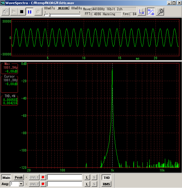

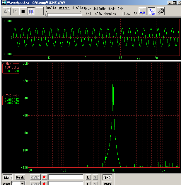

By the way attached original 1kHz wav file "C:\TEMP\1KHz.wav"
and I converted to 1kHz.DSF by my program,
Then convert DSF back to WAV by KORG AudioGate. "C:\TEMP\KORG\1kHz.wav"
very little noise (below -110dB) was added, but should be OK.

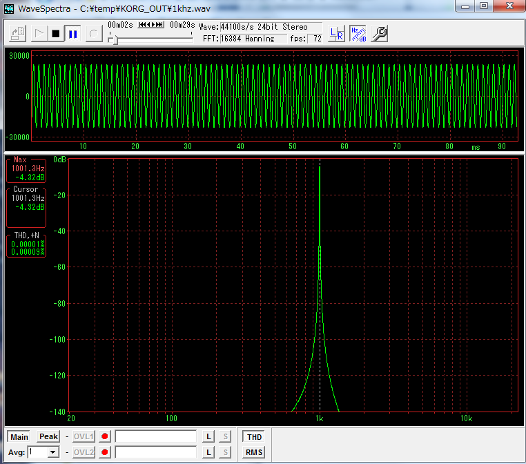

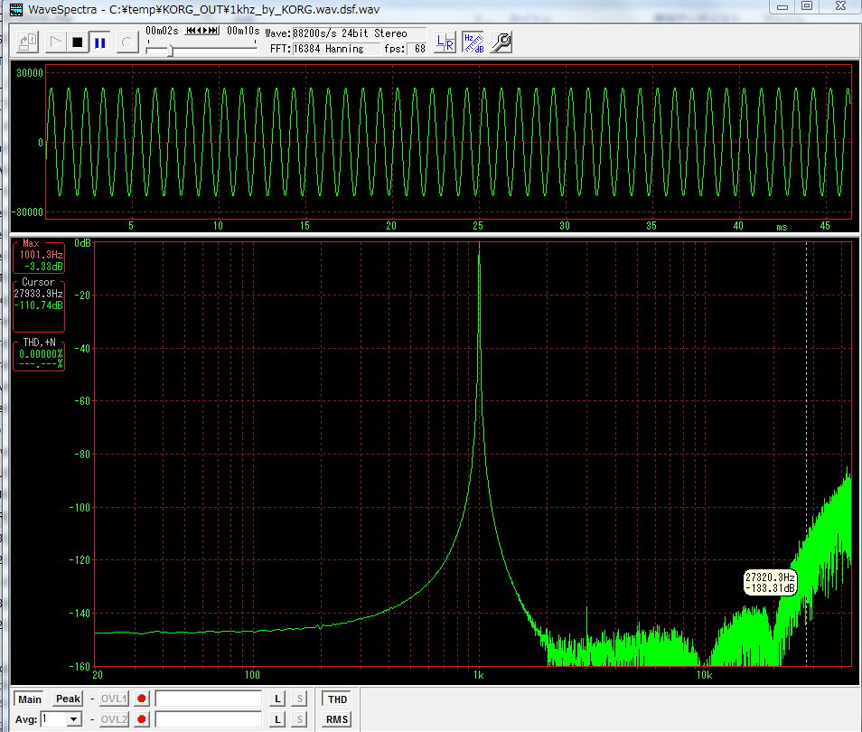

Please forget Post #22. that is because of 16 bit limit. (final digit error)

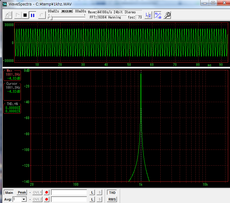

I made 44.1/24bit 1kHz Wav file
converted it to DSF format by my program
converted back to 44.1/24 WAV by KORG AudioGate
and there are no noise over -140dB. 🙂
I wonder my mistake.. I checked final WAV, and there was KORG Tag. OK I'm not looking same file.

That's more like it! Try a wav file that is higher in frequency, since DSD it has less capability there. A 22kHz audio sampled with 48 or 96 would be sufficient.
PS: 144 dB is the theoretical limit of PCM 24 bit resolution. No audio DAC on market comes close of that.
So, now we have over 140dB (DAC - LPF)? DSD only needs LPF to get back to analog.
you just need low noise LPF 🙂

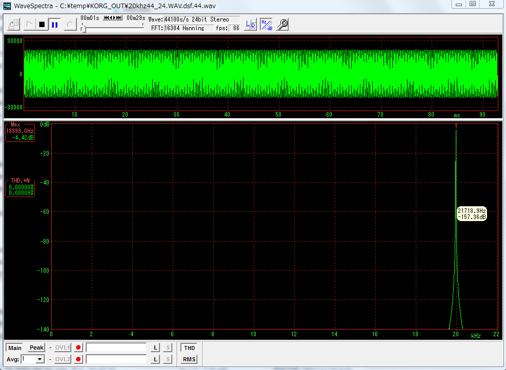

OK 20kHz 24bit WAV -(mine)> DSD -(KORG)> 24bit WAV, still there are no noise > -140dB.
48/96 is not natural for DSD.. I can not convert them linearly.
Yes, but you will see them in "nature" 😀
Can you extend the graph past 22kHz or is a brickwall there in the Korg?
Hi, I can not see over 22050, by WaveSpectra.
if I convert 88200/24bit wav, I will see noise curve attached "DSD_noise_Shaper.png".

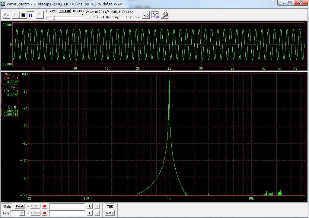

oh, KORG can handle 88/24. I tested 1kHz-88-24.wav to dsf to wav.
it shows -160dB range.
-101dB: 30000Hz
-88dB: 44000Hz
So, If I use LPF cutoff at 25000, 4th ButterWorth,
Then 44000Hz noise goes to -88dB - 10log(1+(44000/25000)^8) = -107dB.
maybe it's OK.
anyway I can not notice over 18500🙁
