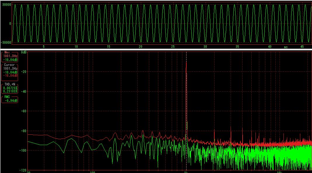

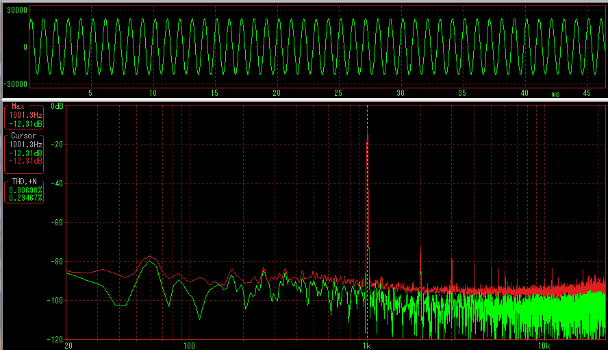

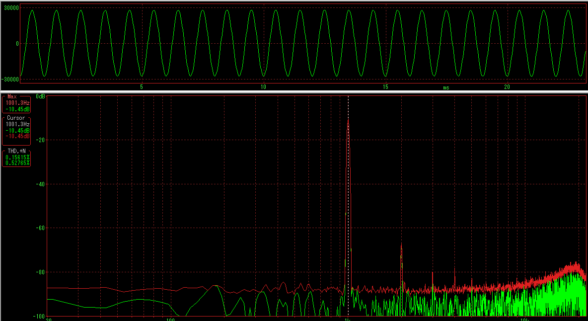

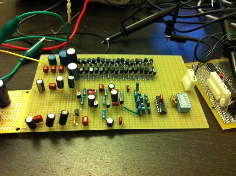

16 parallel is working. I'm listening single channel, but sounds like magic, natural.
I'm using AudioPro Bravo FX-01 now, but I feel want to try MarkAudio full range with DSD direct amp.
1kHz THD: 0.15%, It looks like this is an amplifier of good birth.
The most fun is now only I am listening this sound, pure DSD signal just before LPF.. then suddenly the music appears on the speaker terminal. :)

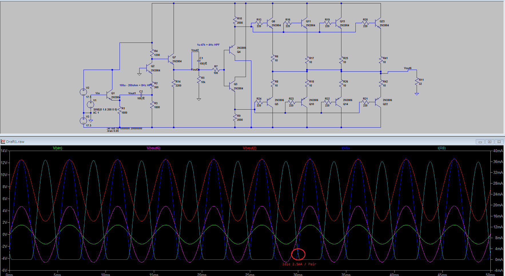

and components are, 74HC08, 2N3904/3906, caps, resistors. in 21 century:)

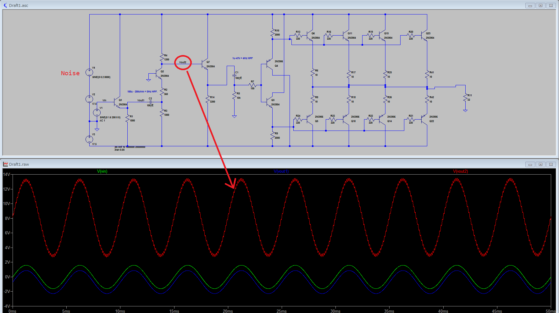

The reason of distortion and noise, I remember 2nd stage (Base Common) is high-speed, but has 0dB PSRR. (PSU_Noise.png) omg.:(
So current usage of final stage may return to here.
This stage must be separated from other stages. Others are Emitter follower, have very high PSRR.
By this experiment,
(a) Volume can be controlled by pulse height (DSD + parallel -> AND gate -> R-2R).
(b) paralleled small Tr can amplify > 10MHz signal, and very clean. By LTSpice, -3dB point is 42MHz.

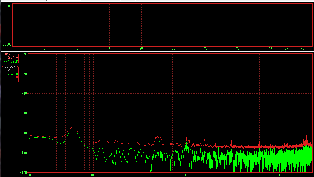

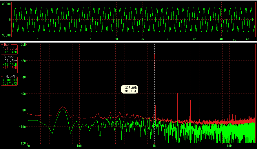

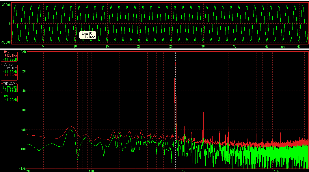

Now I'm watching how to handle DSD signal from source to amp output.
NoConnect.png: nothing connected, Cheap Behringer UCA202 shows -90dB noise floor.
FPGA_Direct.png: DSD_L output-> RC LPF -> level control ->UCA202.
Buffered.png: DSD_L output-> 74HC244 Buffer -> RC LPF -> level control ->UCA202.
Reclocked.png: DSD_L output-> 74HC574 FF -> RC LPF -> level control ->UCA202.
So, DSD signal should be handled by Fast logic, not to be buffered or reclocked by slow gates.
modification for 1/0 pulse curve / width = non linear distortion.
not only amplification, but signal path must be fast / symmetric for positive - negative slew rate.

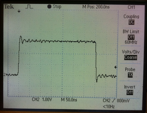

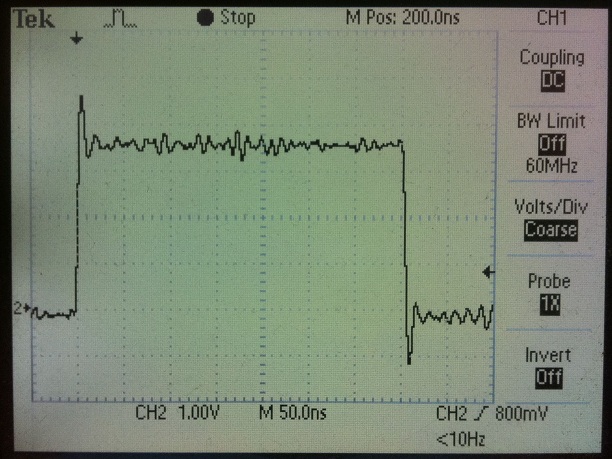

I received 74AC08/32/74/244 yesterday and tested DSD quality.
not better than FPGA output... Xilinx is faster than 74AC.
74AC's t(L->H) = 4 to 16 ns, (around 8ns on oscillo), t(H->L) = 3.5 to 14ns (around 6ns on oscillo)
Maybe I need NC7SV08/32 etc (very fast, 1ns/3.3V) device to get "better than FPGA" result.
WaveForm shows only a slight difference, but 2ns difference is very large for DSD signal. Pulse width difference 1% makes 1% 0 cross point distortion.
DAC chip handles reclocking and conversion in one chip, but I want to make direct DSD amp on PCB board. difficult..

Hi Kiwi, Now I'm free from dead-time issue.
Here is "straight DSD amplifier".
(1) DSD pulse height control volume: parallel ADC + AND gates + R-2R DAC
(2) High speed pre amplifier, 2N3904/3906 (+-15V, regulated)
(3) 16 parallel driver amp, 2N5550/5401 (+-17V)
Now I'm listening single channel, have to solder one more board:(
  • DSDAMP04d.pdf
