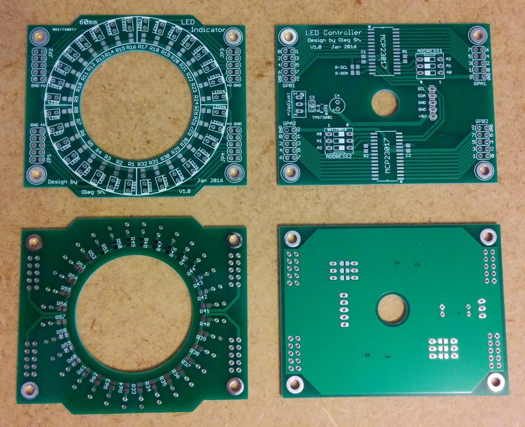

Just finished the updated PCB using the TPS73601 regs. Initially I wanted to have separate regs for the MCP23017 and for the LEDs side to independently control white and red LEDs but this could make the entire project even more expensive. So I stopped at only one reg per upper/lower deck. Now I can test and design for a fixed voltage after regs of let say 4.3V and still have enough adjustment range up and down to fine tune the brightness.

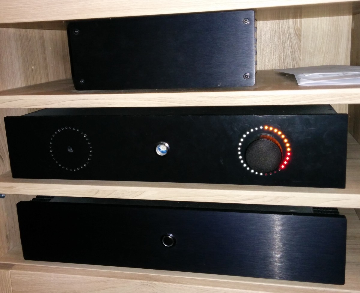

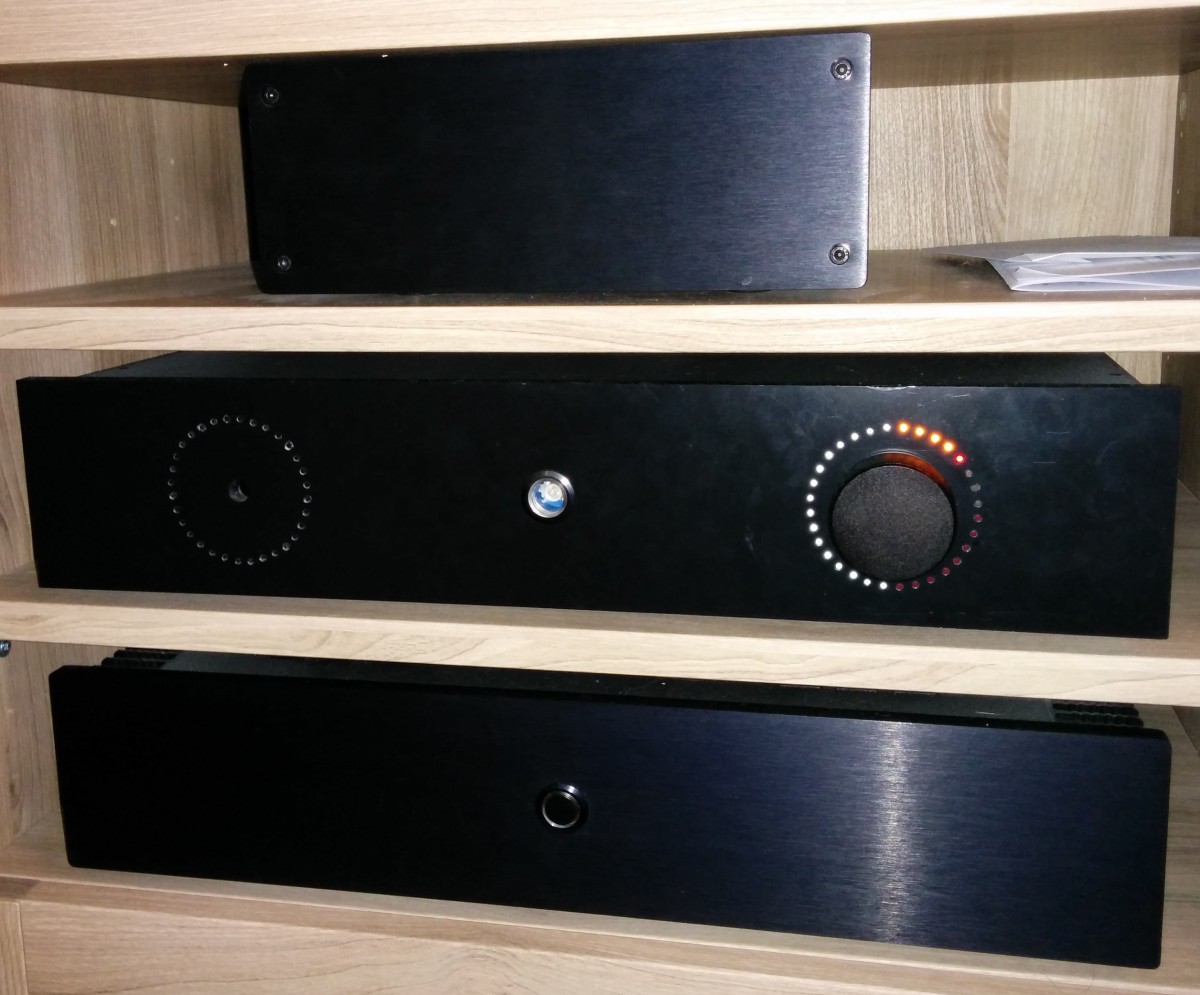

I've made the boards and assembled one indicator (see attached). It all works almost as intended and I really like it. But I have a little problem. As you might noticed some of the white LEDs have slightly lower brightness and if I turn the overall brightness a bit more down, some of them dim too much and are nearly off while others are glowing as I want them. So more work is needed to fine tune the indicator. There are two options that I see: I should either buy more LEDs and select them by brightness or mess around with individual current limiting resistors. And I don't like either of the solutions🙁 The LEDs are bi-color (white/red and yellow/red) 2mm type and cost around 1 Euro each on ebay (I have 32 of them in one indicator) which makes buying more LEDs not so attractive. Adjusting 64 resistors individually is also not so much fun...
The difference in brightness between the white and the yellow LEDs is expected and is easy to tune, which I'll do later.
So if someone knows a good source of 2mm bi-color LEDs which are not so expensive I would appreciate if you can give me a pointer.

Yeah, I only found two guys on ebay who sell those, and I haven't seen anything similar on any of the big online electronics stores, e.g. mouser, digikey etc... But I really like the idea of leading red dot on my indicator🙂 It makes it more difficult to control but it looks really cool! The flash from my smartphone camera overexposed the front panel. In reality the LEDs are not so visible when off. The front panel itself is made of black PVC and is just for testing. Later I'll order the predrilled anodized aluminum panel from modushop to match my amp.
