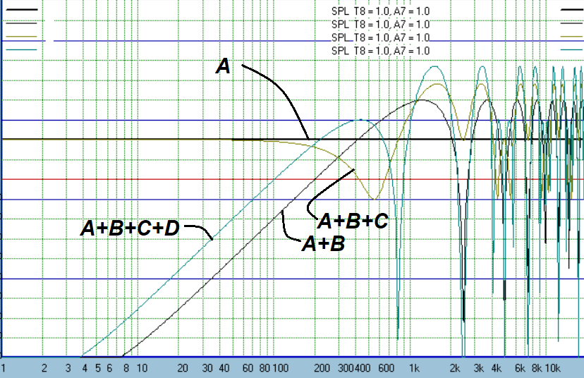

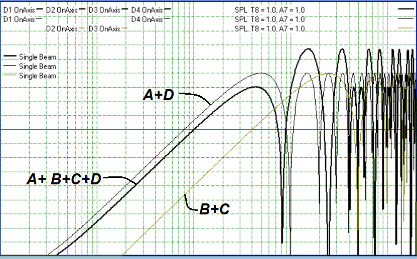

for the dual drive configuration shown in the 1st post here is the simple reasoning. First, acoustics follows linear theory. Basically that means if you know the solution to problem A and the solution to problem B, then A+B is the solution to solving both at the same time. So looking at the original configuration let A = the SPL from the front surface of the front driver, B the SPL from the rear of the front driver, C the SPL from the front of the rear driver and D the SPL from the back of the rear driver. The far field response is just A+B+C+D where you have to add considering phase and delays and each source is a monopole in the far field. So adding them and looking at the various sums it looks like this on axis:
A is just the flat monople response. A+B the dipole from the front and rear of the front driver. A+B+C the front driver dipole plus the front monople response of the rear driver, and A+B+C+D, all 4 sources.
Looking at it another way, adding the front of the front driver and rear of the rear driver, you have a long axis dipole, A+D. Then adding the rear of the front driver and the front of the rear driver you have a short axis dipole, B+C. Then adding them together you are back to A+B+C+D. But noted that adding the short axis dipole to the long axis dipole actually reduces the SPL. It would be better the have the two drivers mounted on the front and back side of an enclosure.
Of course, the net result will depend on what the separation between the drivers is. But I hope the concept is clear. Just adding the SPL of each source as you would in any multi source system.

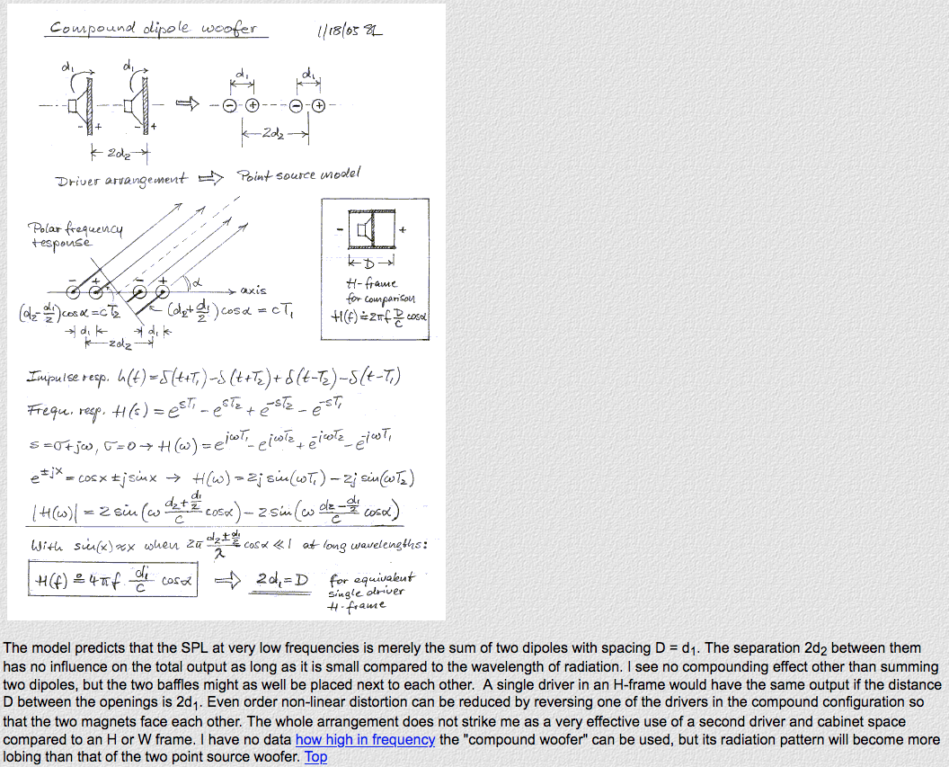

Siegfried's model predicted the compound dipole woofer pair's combined output sum would be equal to a single driver in an H-frame, so the results don't seem strange to me.I will return the drivers into the H frame they were in (courtesy Siegfried). Strangely enough in the H frame the excursion is less and SPL higher.
https://www.linkwitzlab.com/models.htm#B1
At any rate, these arrangements are not about getting the most output from woofers, they are about the radiation pattern.
