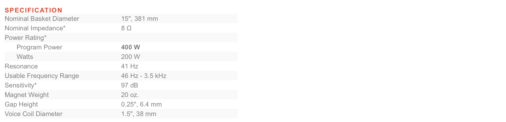

Key specifications of the drivers:

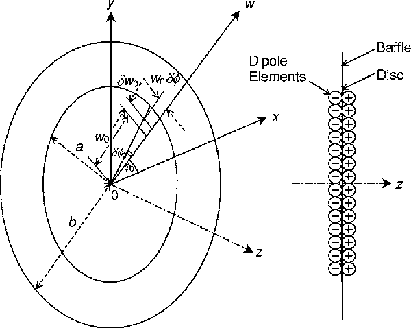

Please search studies of Mellow&Kärkkäinen - driver vs baffle ratio
https://acris.aalto.fi/ws/portalfil...low_On_the_scattering_of_disk_source_JASA.pdf
Thanks Juhazi, you make it perfectly clear. Which graph would apply to a baffle of 0 sq meter.
Oh cr@p Juhazi, I did not realize you were the author of this Mellow&Kärkkäinen dissertation writing under an alias.
Actually the link I gave was not the one I meant (I'm Juha, not Tim ar Leo), sorry. Anyone can ask help from Tim https://www.frontro.co.uk/mellow-acoustics
The right one with pics is here https://www.semanticscholar.org/paper/On-the-sound-field-of-an-oscillating-disk-in-a-open-Mellow-Kärkkäinen/460d1b61e116d50ad3ed136152d8176e9984c28e

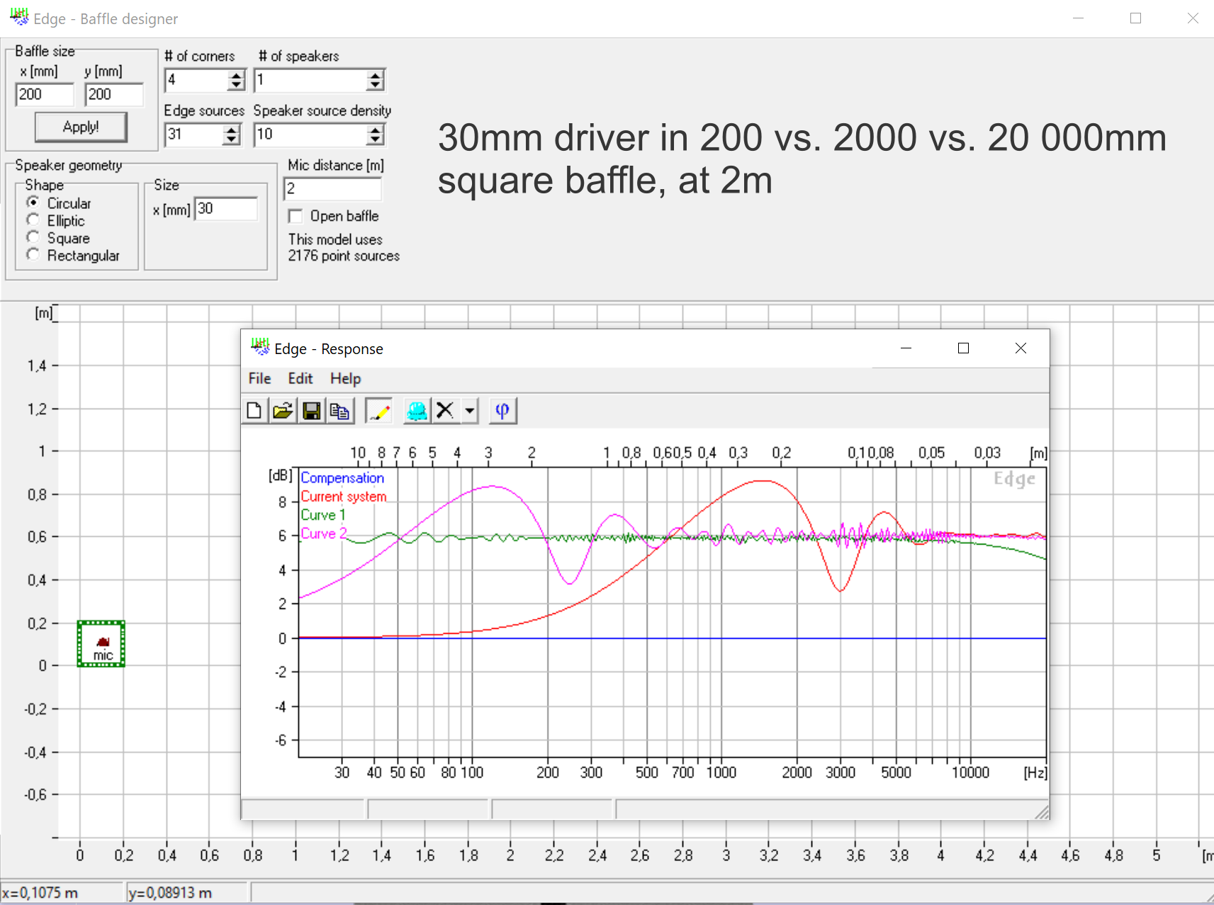

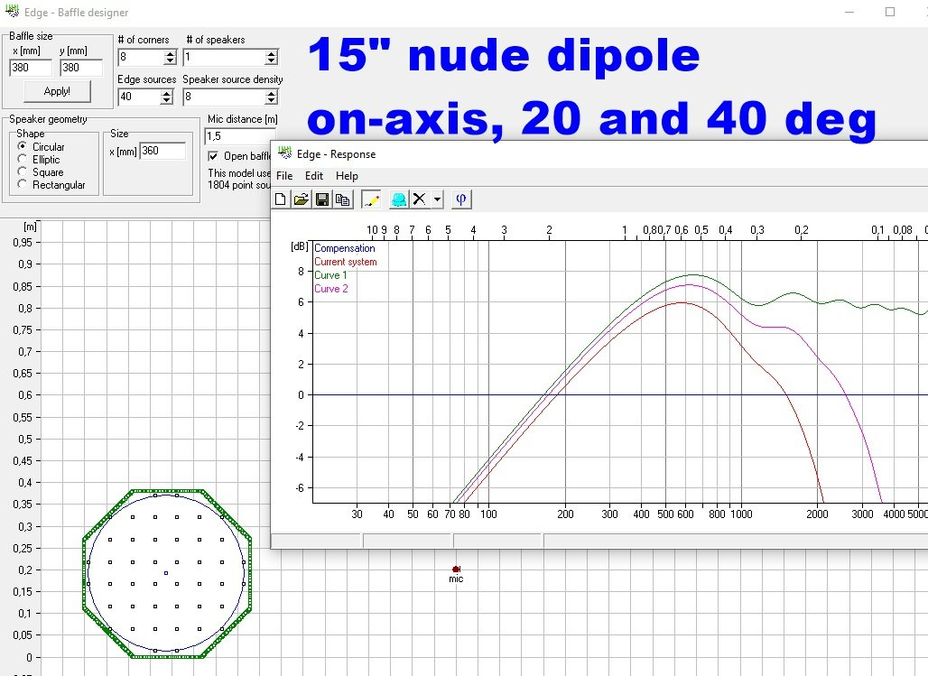

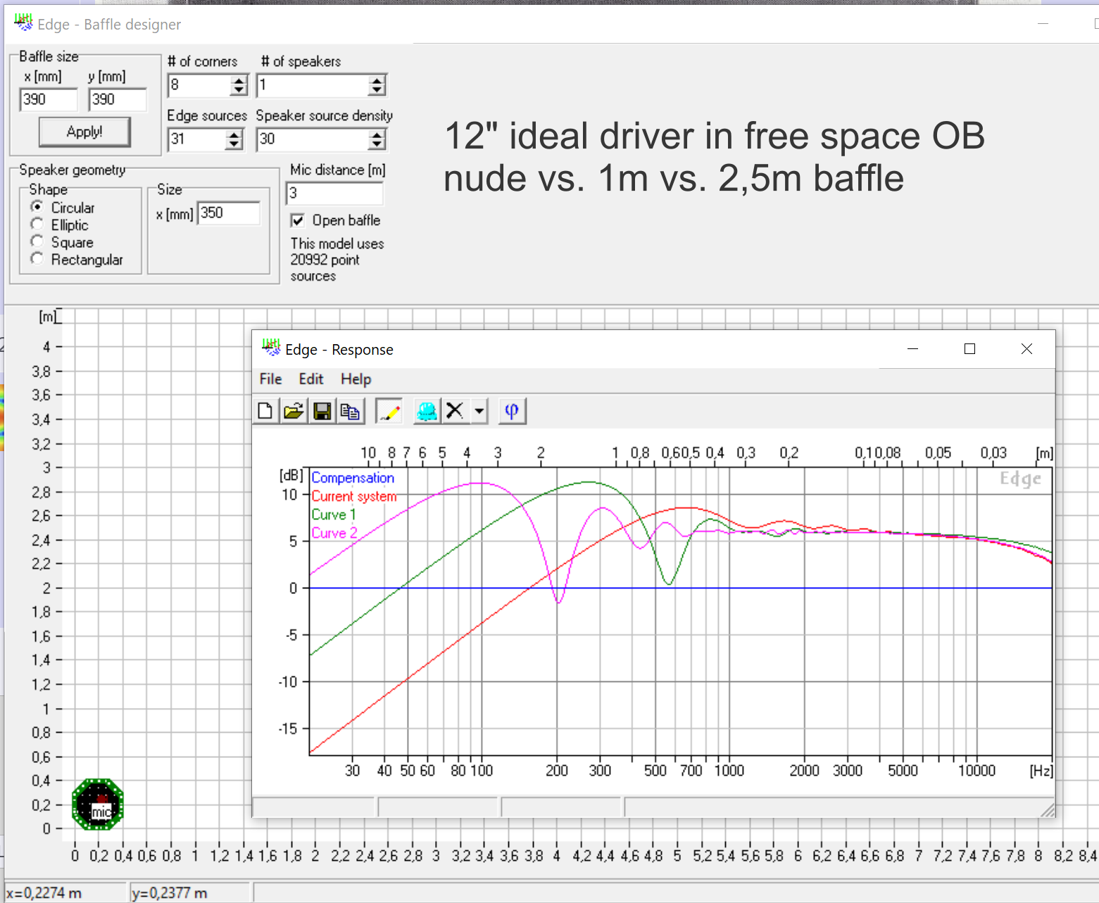

A cone or dome make deviations from ideal flat pistonic model. They can ce calculated too... Here is a peek to that issue by W. Klippel
https://www.klippel.de/fileadmin/_migrated/content_uploads/KLIPPEL_Sound_Radiation_Poster_01.pdf
Edge sim of a nude woofer
