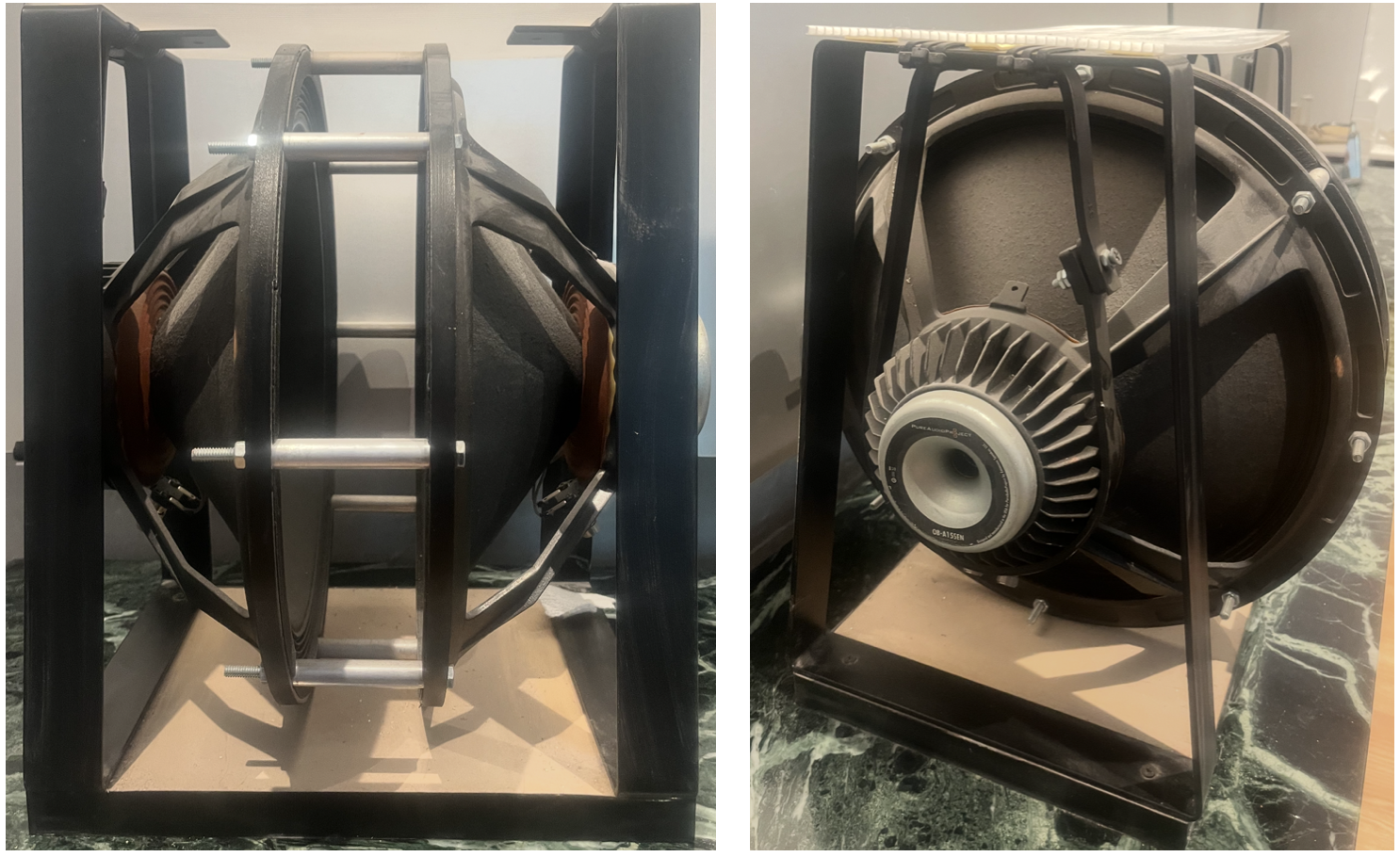

Well great, I tried it today as I said last night using 2 x B19 woofers. I hung them from the door post since I did not want to spend time using making a stand thing, just tried to find how it worked. Then I hung a single speaker in the same position, they did sound different. Then I was advised to study Siegfrieds paper on the matter and proceeded to confirm the maths and I come to the same conclusion about the ineffectiveness of the application. The cone distance Siegfried referred to is for two flat cones hence me using the B139. Is there anything I am missing? If the cones were rigidly coupled, which I did, the bass extended a few Hz lower since the mass sort of doubled, the compliance remained the same. The input power was twice that as it would be for one speaker. What would be different than using a driver with two voice coils?

Well great, I tried it today as I said last night using 2 x B19 woofers. I hung them from the door post since I did not want to spend time using making a stand thing, just tried to find how it worked. Then I hung a single speaker in the same position, they did sound different. Is there anything I am missing?
Hanging from a door post implies the speaker's radiation was distributed to two rooms.
If the speakers were hung perpendicular to the door the null pattern was distributed to each room.
If the speakers were hung parallel to the door, the null pattern would be parallel to the walls of both rooms.
In either case the reflections from another room would "sound different".
In either case, your listening results would be different than from a typical dipole set up in a single room, away from walls.
A single driver with two voice coils only has a single cone, two drivers have twice (+3dB) the radiating surface.
I remember a similar system proposed in Wireless World some time in the sixties/early seventies that a concealed subwoofer in a box acting as side table was designed using two B139 drivers this way coupled face to face.
Face to face, two speakers in a box radiate as a monopole, that radiation is not similar to a dipole's radiation.

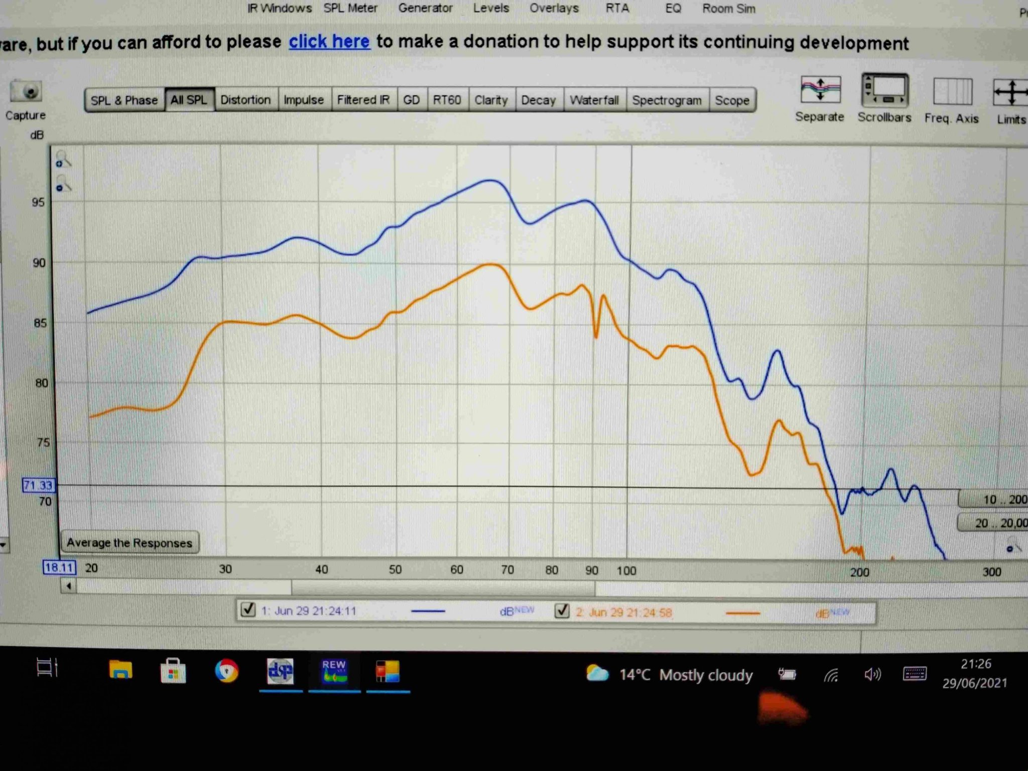

Just wanted to comment that I recently threw together a "compound woofer" test. Using a second Eminence Beta 15A I had on hand, on a temporary baffle, behind the one mounted on my flat OB panels. Magnet to cone configuration (similar to the Legacy Whisper) and I liked the improvement in sound. Driving both with a plate amp, wired in parallel. No measurements yet, but the added output and extra null on the sides of the speakers were obvious. Seemed to be an improvement in my room, the OBs are 24" off the side walls. Also tried magnet to magnet, preferred the former. I am going forward with a more finished inner baffle that will allow a closer distance to the front driver.
