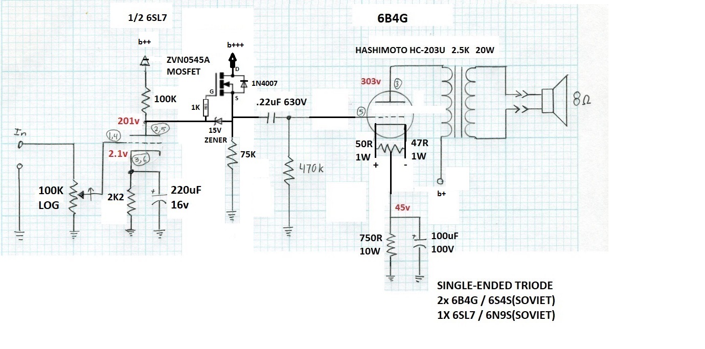

I don't know what schematic you are referring to now (your first posting showed cathode bias) - but I would expect something like this for a MOSFET source follower:
These days I also use 1N4007 (or UF4007) from Source to Drain for ZVN0545A (newer MOSFETS often have this protection built-in but the ZVN0545A doesn't) and back-to-back zeners from Source to Gate. But you can also simply use a single zener like the above. You can directly couple it to the plate of the 6SL7. The coupling cap comes after the mosfet source follower.
I checked out the plate curves for the 6SL7 and estimated that with your B+, load and cathode resistor the plate will probably be around 200V. This means the resistor from source to ground should be around 75k - but you should check this yourself because sometimes plate voltages for 6SL7 can vary when using a resistive load...

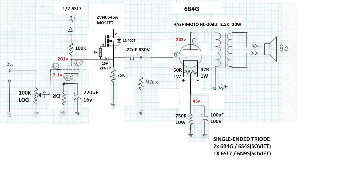

This drawing is from the TSE-II from Tubelab shared in Post #16. It's a little more elaborate than the MOSFET Follies link you shared.
There's a negative voltage rail that I assume biases the MOSFET below 0v. Fancy. But necessary?
Hi, yes I see the whole schematic now. In this case, the coupling cap is in the correct position, and yes, you need a negative rail because if you don't your output tube won't be correctly biased.

Hi gerrittube, the ZVN0545A device is chosen for it's low reverse transverse capacitance (Crss) value of 4pF. This is needed because of the very high output impedance of the 6SL7...
Yes, something like that. I would use something like 300 ohm grid stopper on the MOSFET and 1k ohm grid stopper on the 6B4G.
The cathode resistor on the 6SL7 seems a little high to me but I am sure it will work fine. You can certainly get away with sharing the b++ supply off the pre-amp tube.

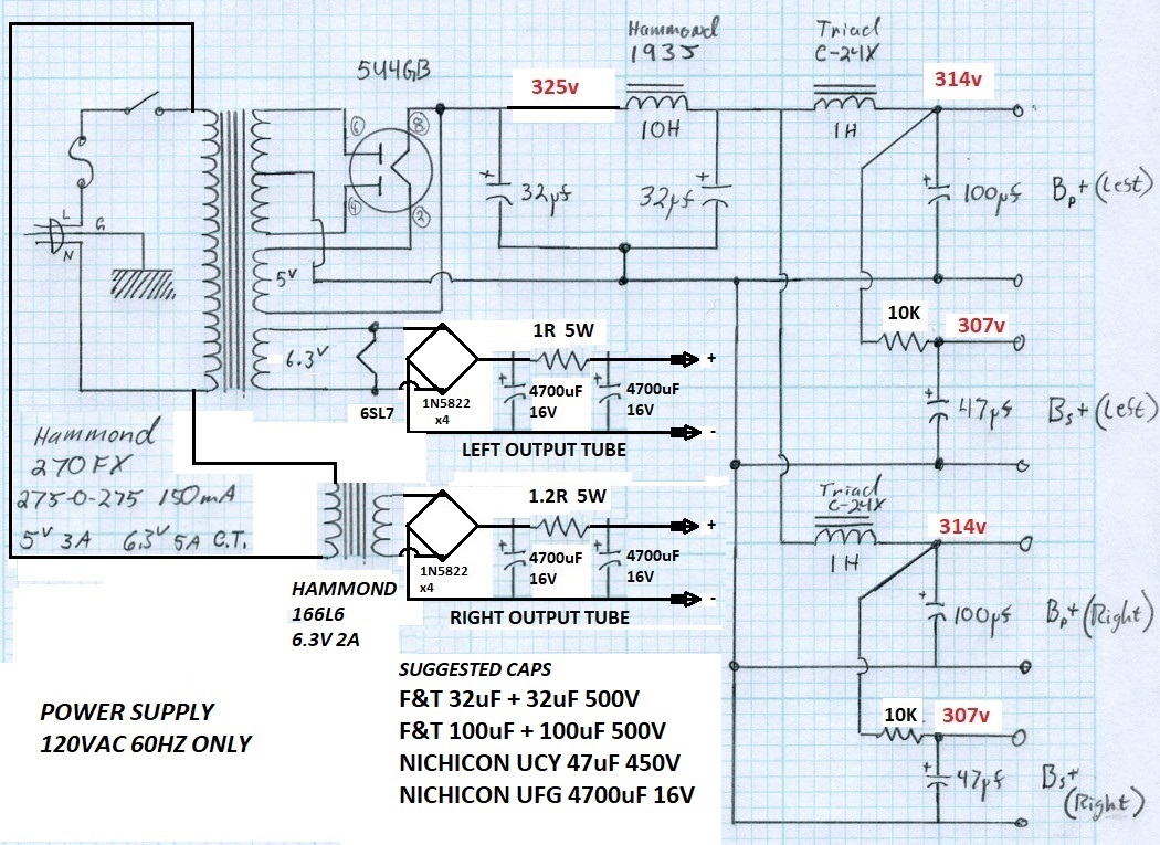

edit: ok one thing.. you are using 6B4g right? The heater voltage is 6.3 volts.... so you are going to get some hum for sure if you don't come up with a DC heater circuit. It's DHT so you will hear that heater hum...
Something like this?
Does the MOSFET need its own node on the power supply or can it share the b++ supply with the preamp tube?
Yes, 6B4G output tubes. Amp started life as a 6v6 UL SE amp. Now I use the main PT to heat the driver tube and one output tube with a simple DC circuit, and I added another LV transformer for the 2nd tube.
The plate and cathode resistors are taken from the RCA Resistance Coupled Amplifier charts. Well, they show 2k1 and I had 2k and 2k2. But I might see how 1k8 does.

ok I've looked at some parts. The ZVN0545A only comes in the small TO-92 package. Will this need additional heat sinking? it is operating at ~200v
the 15v Zener - 1W ok?

It's about power dissipated. You need to multiply the drain - source voltage, then multiply by the current. It should be less than 0.5W to be safe. If higher, then just get a TO-220 MOSFET.Will this need additional heat sinking? it is operating at ~200v
Subtract, not multiply! The whole sentence is a mess. Hopefully you got the point 😅You need to multiply the drain - source voltage,

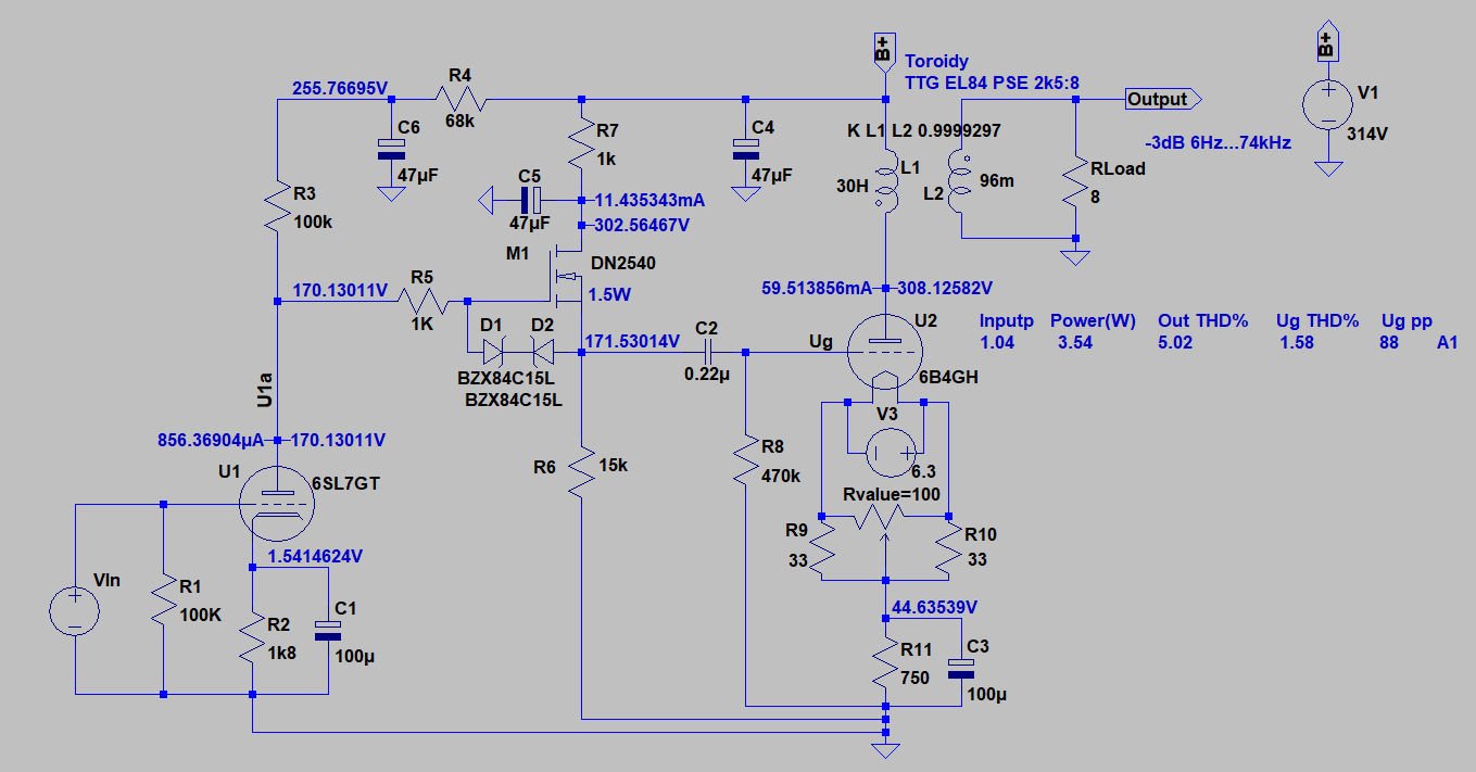

No need for a heatsink if you keep it below 700mW. The 15v Zener can be 0.5W - I have been using some BZX55C15 but there are many others out there.
I like SF at about 10mA current, so TO92 is inadequate.
As you can see this sample, the SF FET dissipation is at about 1.5W, so TO220 version with appropriate heatsink necessary.
