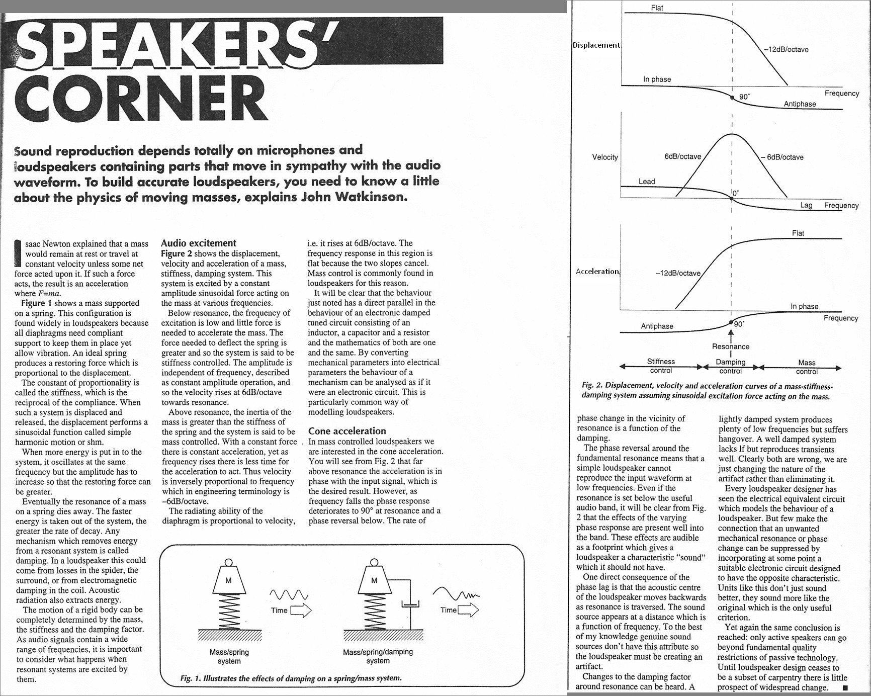

The mass and spring analogy falls short here because this would appear to describe a mound or band pass response and it does exactly IF what you’re looking at is the radiator velocity.
The problem is that a woofer is usually on the sloped part of the radiation resistance curve and so to get flat response, the velocity must fall off with increasing frequency. That correction slope is provided by the woofers moving mass of the resonant system above it’s resonance dominating the system.
John Watkinson wrote a short article for Electronics World about a dozen years ago that had a nice set of plots showing the amplitude, velocity, and acceleration behavior(amplitude and phase) of a loudspeaker.
for F >> resonance:
acceleration is in phase with applied voltage, amplitude is 180 deg out of phase
for F << resonance:
amplitude is in phase with applied voltage, acceleration is 180 deg out of phase
This is why when you do a polarity check with a battery and see the cone move outward, the some polarity will give you a positive going impulse response.
This is also why applying motional feedback to a woofer is not as easy as one might initially think.
Amplitude (instantaneous position or displacement in the article) is a scalar. It has no direction, just magnitude. Acceleration is a vector. The statement that amplitude and acceleration are out of phase makes no sense.
All three parameters are vectors...directional sign convention for all three being
(+) for outward position, outward directed velocity, or outward directed acceleration
(-) for inward position, inward directed velocity, or inward directed acceleration
The statement that amplitude and acceleration are out of phase simply means that while the loudspeaker is reproducing a steady tone, and the cone position is (+)(ie outward) with respect to resting position the force applied to the cone by the voice coil is trying to accelerate it in a (-)(ie inward) direction.
The difference in behavior for tones of frequency well above or below resonance is whether the displacement is following the input voltage (+ displacement while + voltage is applied to voice coil) or the acceleration is following the input voltage(+ acceleration while + voltage is applied)
Having a positive or negative sign does not make a quantity a vector. Minus four degrees versus plus four degrees does not make temperature a vector. Amplitude means magnitude. Scalars have magnitude but no direction. Position only has meaning as a vector only when compared to a reference point. Displacement is another matter, the reference point is the neutral position of the voice coil/cone with no external force applied. The spring constant k will always create force in a direction opposite to the direction of displacement and the velocity related drag constant b will always create a force opposite to the direction of motion. However, whether the voltage is in phase or out of phase with the direction of motion is the result of the net force acting on the coil/cone. It is the motive force acting to direct the motion of the cone. If it is greater than the restoring force at some point it will be in the direction of the cone as the cone catches up to it. If this were not true then the rotary motor analogy would be that a motor would always run backwards relative to the direction of the magnetic field pulling on the armature pole pieces.
Aah, OK. I didn't catch the discrepancy in the article you were pointing to.
Yes, I agree that the label "Amplitude" on the top plot in Figure. 2 should be "Displacement" as described in the text and the Fig. 2 description.
A little photoshop fix attached...

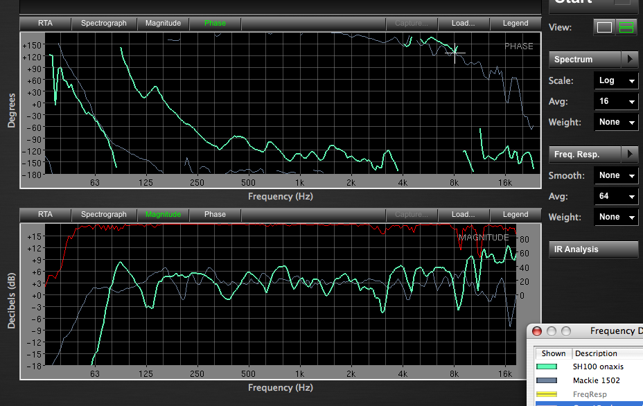

You misinterpreted my comments. I was simply pointing out that the idea the efficiency can increase without limit by increasing the number of drivers is in violation of the laws of thermodynamics.
A complete Bodie plot must show both amplitude and phase angle as a function of time. I've never seen a plot of relative mechanical phase angle as a function of input Voltage phase angle. Usually only "group delay" which is the time delay between applied voltage and mechanical response is given, typically in milliseconds. Generally this is only of interest at crossover frequencies where matching group delays between drivers is of value to those who are deluded that they can build a phase coherent speaker that is not also coaxial. Anyone got any real world measurements?
The charts below are a Mackie HD1502 which has built in processing (Gunness Focusing) and is bi-amped using a 1" exit horn on top of a 15".
The SH-100 is a Danley Sound Labs 2 way passive crossover 8" coaxial coupled to a shallow "Synergy" horn.
Both speakers are remarkably phase coherent, using quite different design approaches.
The HD1502 is smoother in both phase and magnitude response.
Both speakers sound quite good throughout their horizontal coverage range.
Art
for F >> resonance:
for F << resonance:
This is generally good but I believe the acceleration plot is reversed (should advance at low frequencies rather than retard).
The three parameters are being compared to the input voltage. There is obviously a phase difference between displacement, velocity, or acceleration, and voltage. The response shapes alone (lowpass, bandpass and highpass) would suggest a 90 degree phase shift from one to the next and 180 degrees between the extremes. The phase curves (perhaps not the acceleration curve) are simply the Hilbert Transform of the response shapes shown.
