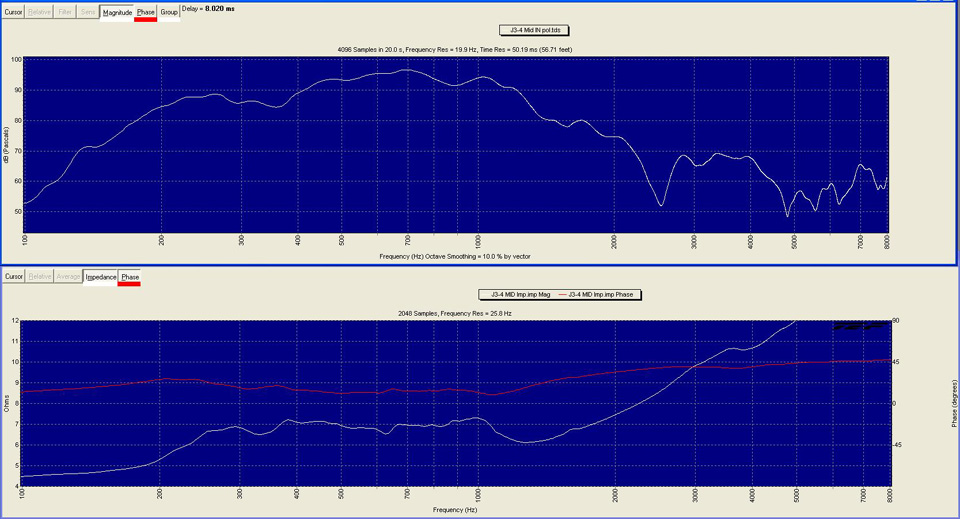

While it is true one can normally ignore the acoustic part, it is also true that the acoustic load can be very visible in an efficient horn system. That acoustic load is a resistance and does show up like one, in fact, if one had a 50% efficient horn, then one would see that the impedance in that frequency range is about twice Rdc and resistive.
Here is a handy measurement that shows this. This is a ½ volt 2 meter measurement of a part of a large 4 way synergy horn, this would be the raw response of the lower mid section.
In this case the 1w1m sensitivity would be about 115-116 at the peak but the efficiency would be in the 25-40% range (est) so about 10dB of that on axis level is from forward directivity.
Note how the impedance is raised but is also close to resistive through most of the band. As VC heating is I^2*Rdc, this means the electrical power handling is also increased over the direct case.
Best.
Tom Danley

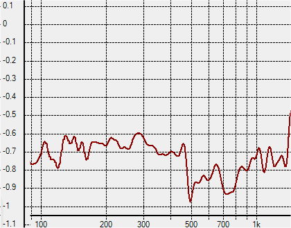

Further to this, below is a difference curve between a FR sweep on my Delta 15 with and without -4VDC on the VC, crossover in place. (Response dropped with VC displaced inward)
There is obviously something going on beyond a flat loss. How much effect it is having is not clear but there is a very subtle conditional level dependent distortion that I have been trying to track down and this might have something to do with it. FWIW my crossover may not be typical.

Regarding the Le(x) and passive crossover Q question, a number of years ago I looked into something like this. The initial purpose of the investigation was to look at the effects of VC heating but it ended up looking like what was observed was Le(x) bebavior. You can view the old web page HERE. When the way back pahe come up click "Impatient " at the bottm, center right of the page.
Interesting simulations John, but are you sure about the L(e), R(e) thing? I would swear that you hve the two reversed on your simulated low-pass. The green curve is different only at the crossover point (Q) and that should come from a load resistance shift. The red curve shows the crossover point lowering and that would have to be from load inductance rising.
Note that 60 degree C temperature rising is a lot of input power. We used to inject a little DC through drivers at KEF to measure temperature, and actually had calibrated voice coil temp thermometers that we would take to HiFi shows to show the public. Most of the time they sit at 20 C. Short blasts could get them rising (especially) the tweeter. It takes a lot of sustained high level to raise the steady state temp because you need to raise the magnet structure temp. You can also see the time constants of the VCs and the structures. Tweeter time constant: about 2 secs, woofer 5-10 secs, magnet structures, maybe 10-20 minutes.
Also it should be noted that L(e) does not shift to a new average value with input signal. It modulates with excursion but the mid point is generally constant. As such you can see modulated HF level riding on a big bass note (classic intermodulation), but it should always return to normal when the bass input stops.
David S.
Hi Dave,
The curves are correct. But as you note changing Le is not the same as Le being a function of excursion. The simulation are just an example of what agrees best with the measurements. The sims suggest that VC heating is not the issue here since changing Re in the sims has a very different result. Changing Le seems to match the measurement better and suggests Le(x) may be the culprit. Yes, Le(x) modulates with excursion, but there would be some RMS value, and remember, the measurement is also an RMS type value. I think the results are pretty conclusive that this is Le(x) behavior. The thing that isn't on the page is that after the discussion at Madisound I when back an tested some higher quality drivers with better motors, namely SS and Seas drivers, and the effect was not present. Then I tested some older drivers including the KEF B110 and the Audax HD13 B25 and there is was again.
