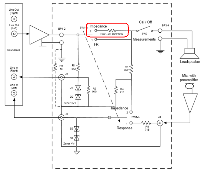

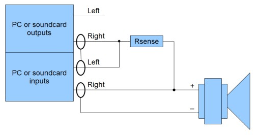

if you put any resistor in series with the loudspeaker and just measure the voltage over this (= current) plus measure the output voltage just coming out from the power amplifier, the results will have an offset of that resistance (0.1 ohm in this example).@b_force What do you mean with
0.1 ohm error?
There are definitely ways to compensate for this, but putting such a small resistance just between the output of the amplifier and the feedback loop of the amplifier is much easier.
An error of 0.1ohm is small, but it's one nevertheless 🙂
Yeah that is also doable, actually pretty handy and a great idea! 🙂I was planning to make a small voltage divider network to decrease the amplifier gain by ~20 dB... So you think this would be unnecessary? If so, that would be convenient.
Gives you much better control about what is going on and you can just keep the gain of the audio interface fixed basically.

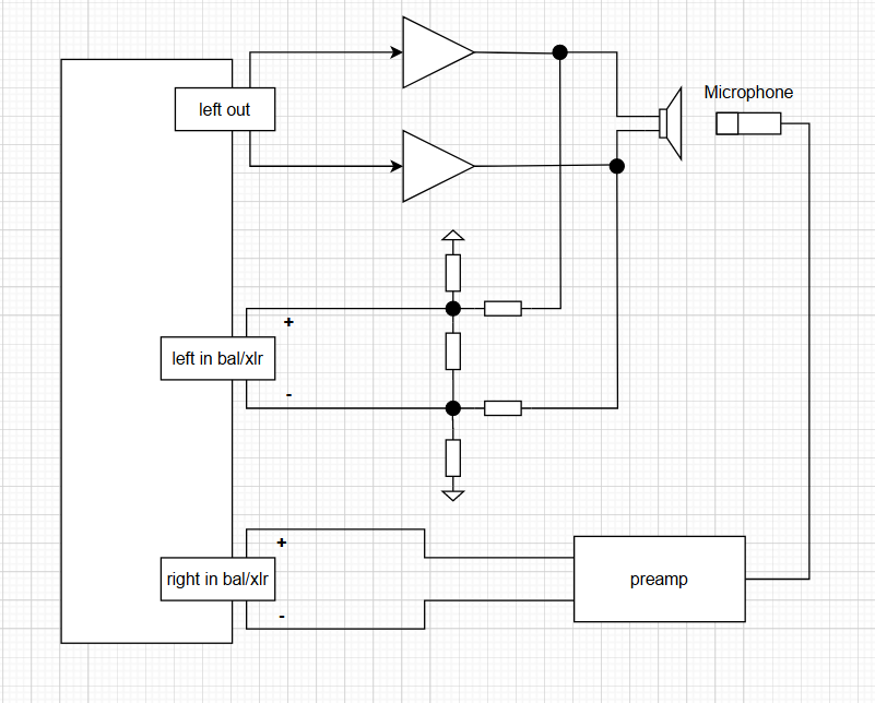

For a balanced input it's best to also make this balanced as well.
I showed this in another topic, but will just copy-paste it here as well 🙂
This is with a bridged amplifier, but a single-ended amplifier (= negative to ground) will work the same.
If you just want to use it for loudspeaker measurements, I would recommend putting some capacitors in parallel as well.
With a f3 around 40-50kHz or so.
There are those 2 pole 6 throw (2P6T) rotary switches, that are perfect for this! 🙂
Just leave the zeners out btw (originally in ARTA's manual), they just introduce quite a bit of additional distortion in some cases.

The impedance network for a bridged amplifier can also work this way.
That being said, the series resistor attenuator method isn't the best, but unfortunately the only thing that programs like ARTA (LIMP) support.
The 0.1ohm method that AP is using is already better.

The problem with the series resistor attenuator method, is that the voltage isn't constant.I gave this a thought. It likely is true if you want the impedance on a voltage source. But why do we measure impedance? Quite often because we want to cross passive and use inductive and capacitive networks that also bring a real part of impedance in series with the speaker. So maybe the method is quite fit for that application. What do y‘all think?
Especially with the recommended values of around 27 ohm.
For just a simple measurements at a low voltage for a (passive) crossover design, this will be fine.
But if you want to get more data, especially on a poor man's Klippel LSI way, this won't work well anymore.

Yes but it does account for this making it accurate, doesn't it? The problem with more common choices like 400 or 1k is SNR.The problem with the series resistor attenuator method, is that the voltage isn't constant.

Using a current sensing resistor does not cause an error. The operator (or the software) will of course take into account the voltage drop. That's part of the measurement principle.An error of 0.1ohm is small, but it's one nevertheless

That totally depends how the voltage is being measured.Using a current sensing resistor does not cause an error. The operator (or the software) will of course take into account the voltage drop. That's part of the measurement principle.
But as you can read in the same post, it can be compensated for.

This circuit can show the Voltage across the driver as well as the current running through it, as long as the resistor value is known. Am I missing something.. how is that anything but accurate?I think you mean more simple?

I think we are talking about two different things here probably.Am I missing something.. how is that anything but accurate?
The circuit you're showing is the attenuator circuit we have been talking about.
I am talking about how the voltage (and current) changes with an higher output voltage from the amplifier with such a circuit.
This can easily be moddeled and calculated.
