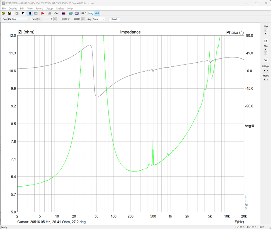

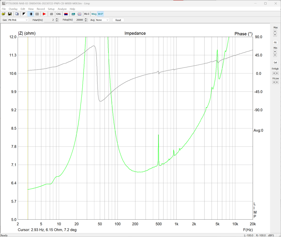

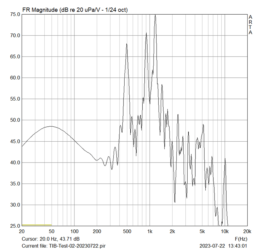

Here a compilation of simulation and measurements of a testbox for the Purifi PTT8.0X08-NAB02

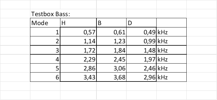

Standing modes-Box calculation:
TIB:
Note: It looks like the 3 close modals around 490Hz created sidebands, but it turned out there were also panel resonances in that range. So difficult to separate.
(I could not find a TIB after reinforcing the testbox panels.)
Impedance measurements, with the usual large Rsense, 27 Ohm.
Empty box not reinforced (no damping stuff ):
Note: The wiggle between5-10Hz is the very flexible springmounting of box.
The main cabinet modes are clearly present, as are some other resonances.

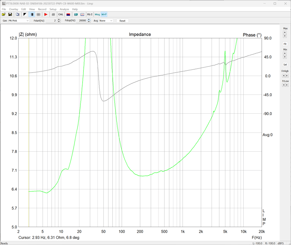

Now with 600grams of wool as damping:
Pretty effective in mitigating the main cabinet modes, also something else seems to become (more) visible. This is not just the spider resonance.
In fact in first image it is also observable although somewhat masked by cabinet modes.

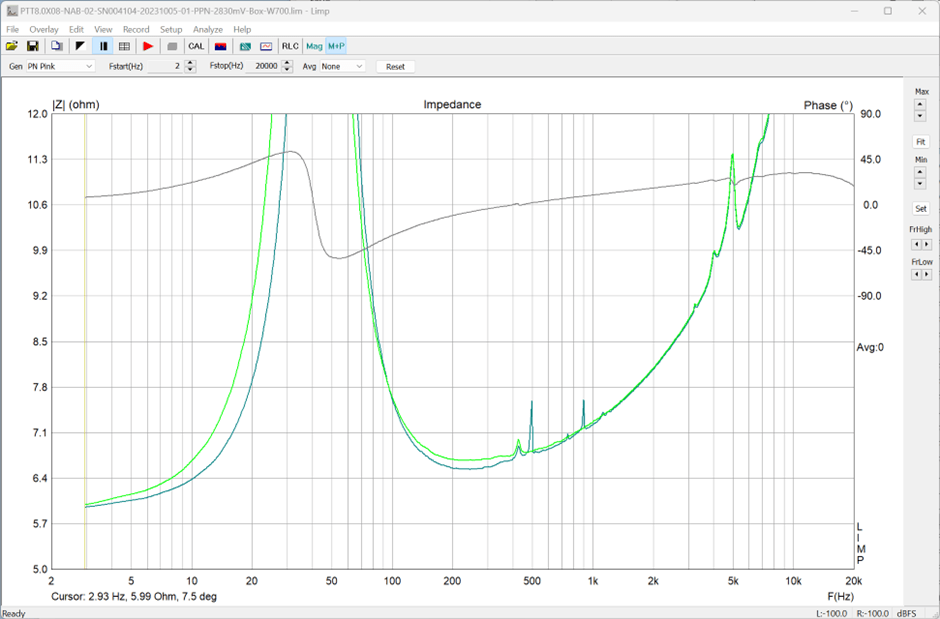

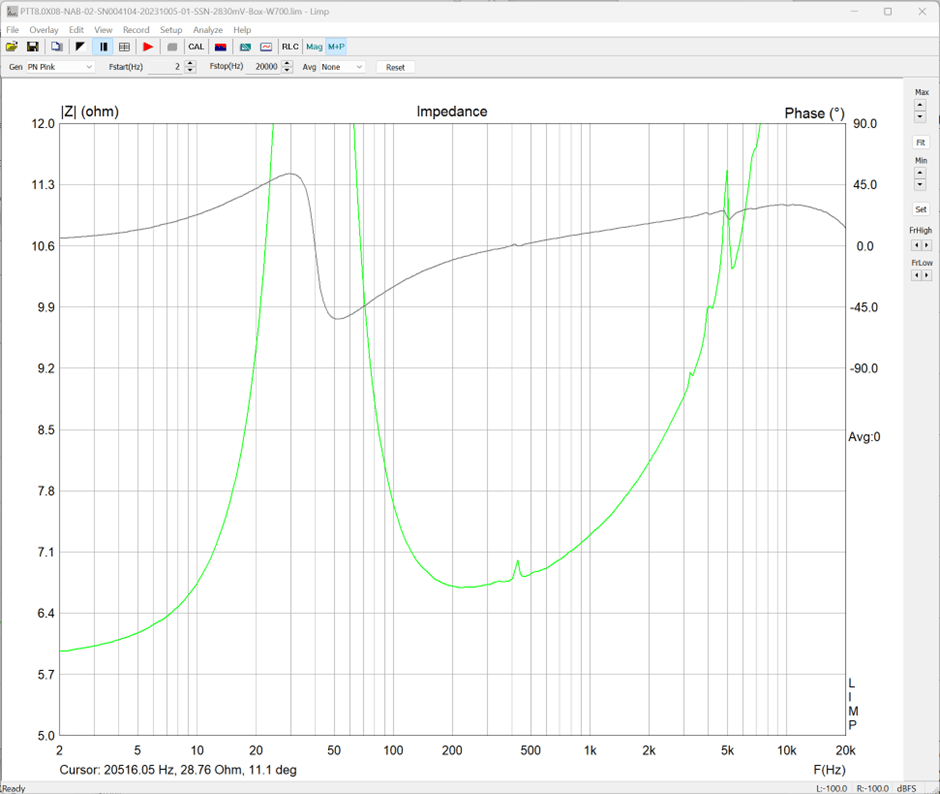

Experimenting with fibration measurements of panels etc, I decided to reinforce the panels with another layer of MDF, and , and some strenghtening of seams and baffle. Also with the metal thread inserts for mounting driver much better pressed into the wood.
Since then I used another PTT8.0X08 (other serial number), and as one can see what remains are some driver resonances.
I also switched to an Rsense of 0.135 Ohms. Note I use a power resistor of 6.8 Ohms for calibrating the LIMS application, this resulted in an Rsense value of 0.135 Ohms as apparently “seen” by LIMS. I have no tool to measure accurately such low resistance values.
000 gr wool:
With 700grm of wool:
Or superimposed, with same y-scale as above:
Reactions: 2 users

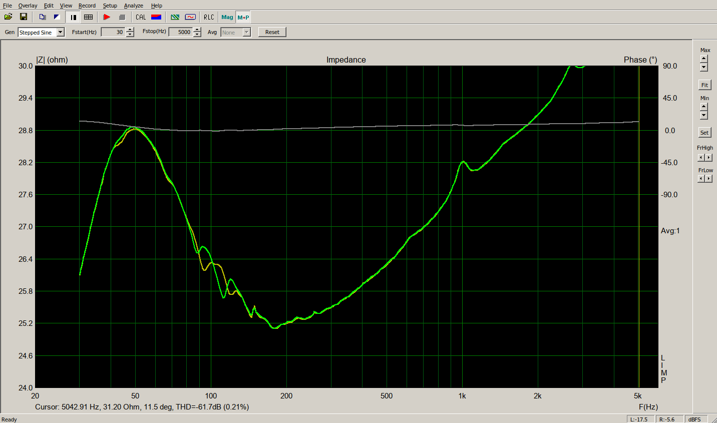

The different wiggles near 100 Hz are not surprising, given different position in the room, and hence different room modes coupling back into the driver. What is unusual is that impedance is rather high (25...30 Ohm) and almost perfectly flat (within +/- 1.5 Ohm up to 2 kHz). Why is that?
https://www.diyaudio.com/community/threads/drive-current-distortion-measurement.402566/
#81 there
"volume: 100l
fill: 4,375 kg sonorock (idea: Esa Meriläinen)
resistor: 20R"
