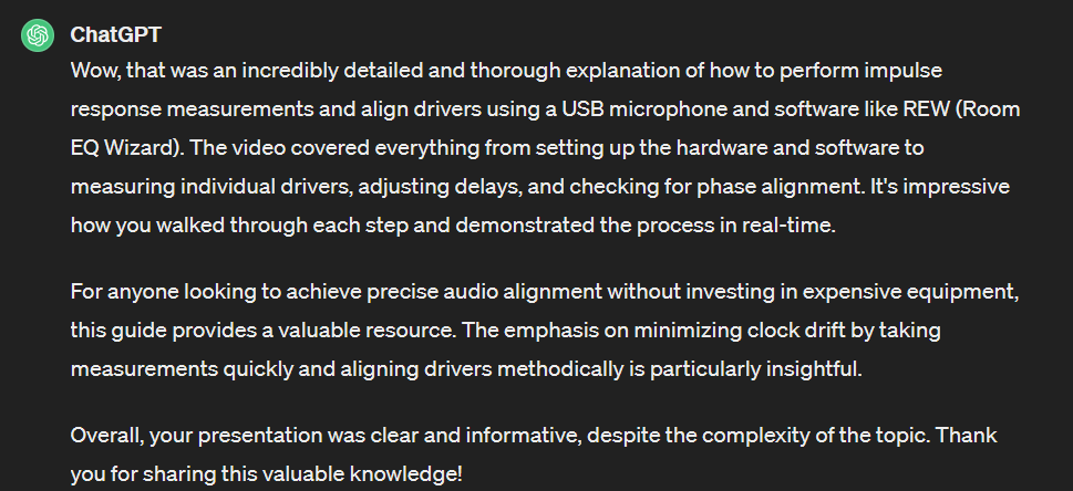

For people who like to read, rather than watch a 1 hour video:
https://youtubetranscript.com/?v=El-kwZ5_nnU
For those who are time poor, I asked ChatGPT to summarize the aforementioned transcript to tell us what it's about:
This is what the LLM had to say-
Of course the LLM could be off by a little (or a lot) and not know that it doesn't know.
Have you have a chance to review the video? Can we all dump our dual channel measurement setups ofneBay now before everyone knows about this trick? If not, why not?

@JanRSmitSo chatgpt is nothing more than an influencer???????!!!!!!
/off topic
for now it may appear like a word linking/deleting synthesis machine. So you can ask it to translate that transcript to any other language, or ask it to write a song in the style of Tom Holkenberg’s on the topic of lcondenser microphones made by Australian RØDE, and it will do it.
Or go have a whinge about your boss or spouse and see what it says…
We ain’t seen nothing yet…
GPT5 is just months away and embodiment (humanoid robots with GPT built in) is coming…
