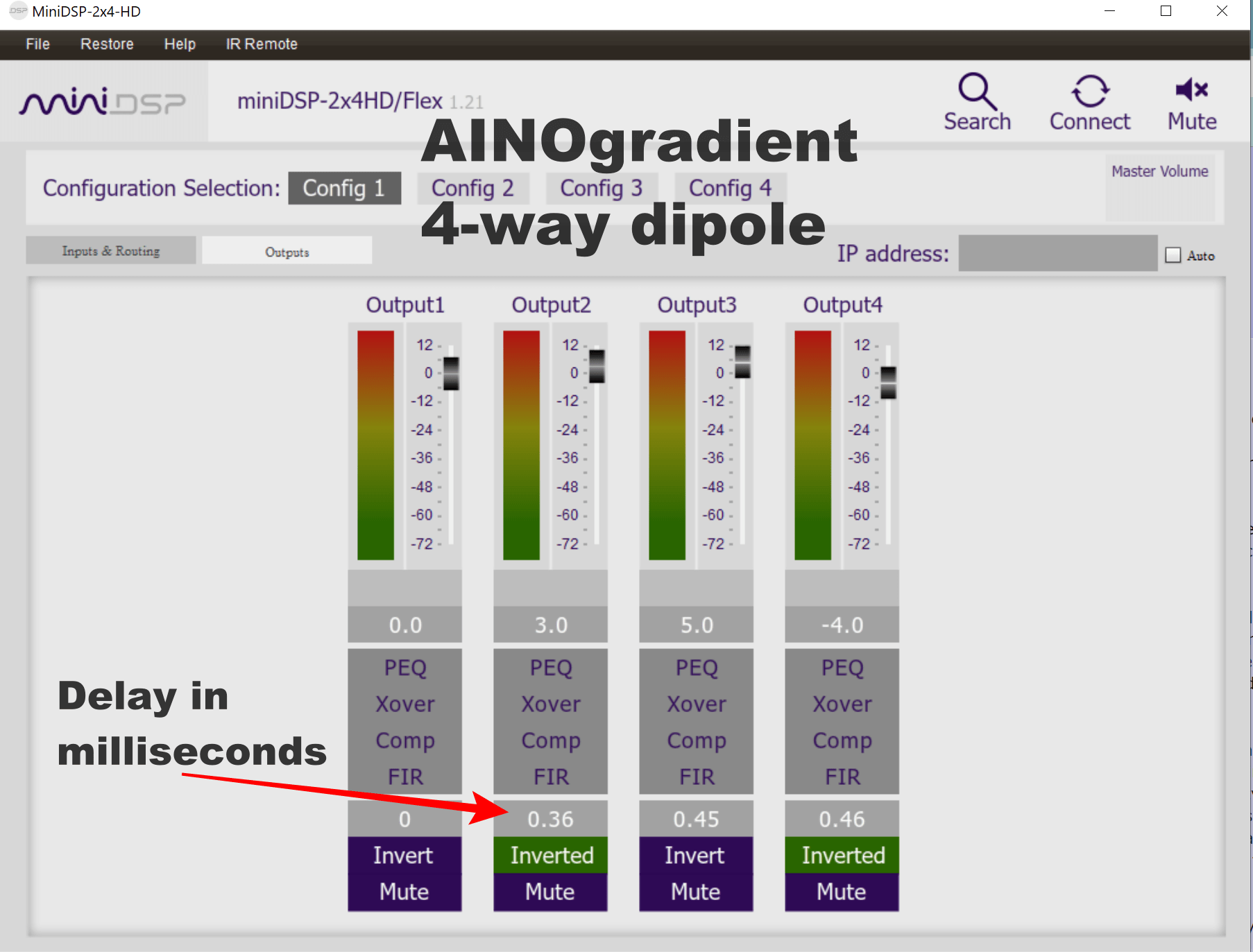

I've got opinion based on observation on the timing stuff, relating to Juhazi and Azrael comments about how important it is to measure timing:
Playing with my DSP controlled speakers, adjusting DSP while sitting other side of the room (where the DSP is), I cannot hear any difference adjusting delay of tweeter, until quite a long delay.
Starting to deviate from "optimal delay" first there is some frequency response dip forming, which is audible but quite hard to hear like any frequency response dip is. Then, many many milliseconds later, delay way way off, the tweeter and mid start to sound separate and this is clearly audible. This happens like 10ms delay, which equals three meters in distance, 10 feet.
My takeaway is this: if one listens far away in the room, or in other words uses strong early reflections to get "wide sound stage", one cannot simply hear differences with the timing, at least it's not high in list of importance. But, move your chair closer up, shrink the stereo listening triangle enough, so that early relfections get delayed and attenuated enough (compared to direct sound) so that stream separation happens in auditory system, clarity, now, even rather small delays seem perceivable.
What the close listening distance does it allows auditory system to lock in to the direct sound, and the lock in is basically due to good preservation of original harmonics (read Griesinger papers), which means group delay, edge diffraction, early reflections all kinds of secondary sounds kind of prevent, or reduce ability to lock into, reduce signal to noise ratio. What the preserved harmonics do they superimpose huge amplitude peaks for every fundamental cycle, making the sound stick out from all the sounds around us. Ruining the harmonics one way or another just reduces signal to noise ratio basically. When auditory system doesn't lock in it feels the sound is just noise, can't lock in, it's automatic process we cannot do nothing about except learn to listen for it and then take advantage of it, reason with it, gravitate to sound one likes to hear atm with the recording that happens to be playing.
Well, what ever it is eventually, delay mismatch with loud early reflections seem to make small delay / xo issues inaudible simply because most of the perceived sound is combination of direct sound and early reflections (6x boundaries on a cubicle combined is far louder than one direct sound), which are by far more scrambled than any small delay on xo region. Thus, agonizing about delays is irrelevant in my small experience as long as listening setup is like it usually is on audiophile photography, or in hifi shows, too big stereo triangle in reflective room, no toe-in, no directivity control and so on. So, if you plan to listen the "spacious hazy sound" at home then measuring with USB mike might be just fine, but if one want's to get accurate sound and is able and willing to set the system to get auditory system with it, then it pays off to measure and adjust delays accurately. I think it pays off to always measure accurately to be able to optimize for both perceptions, with or without auditory separation, which allows not just one good sound but two! It's just that a DIY setup could skip on it, as long as one always wants to enjoy only the spacious sound of loud early reflections, and never the accurate one, where brain pays attention to the sound.
This time delay stuff is relatively easy to experiment with active systems. I should make web app to allow testing this kind of stuff easily with any speakers: split signal, delay the other, assemble back, all in electric domain. While it's not too accurate it would still work to demonstrate this particular phenomenon I think, everyone could try.
Anyone tried? Did you hear a difference? We all have different listening skill/experience, so don't take my post as absolute truth, but just another perspective on things.

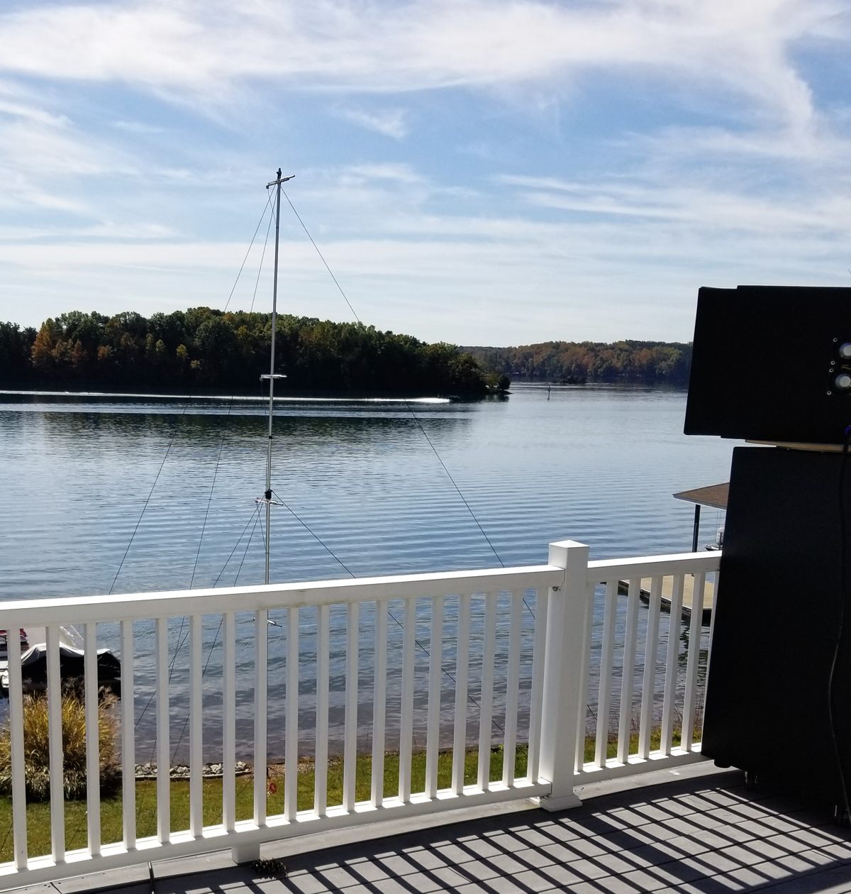

QuantAsylum has some nice kit that you can put in you backpack and take it outside and down the road or take out on the deck.
The QA461 is a test power amplifier with a internal 0.01R current sense resistor.
The QA472 is a low noise mic pre-amp with mic power supply.
Thanks DT
Thx,What a beautiful view! It looks relatively quiet too.
but don't ever think it comes with quiet. A big motorboat lake is one noisy mother just from boats and PWCs !!
Plus, lot's of folks (like me for example) love blasting music outdoors, either from deck, dock, or boat/PWC.

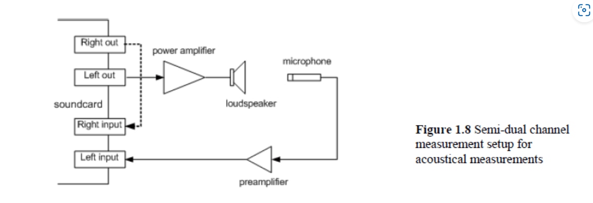

I set up my audio interface in the "Semi Dual Channel Setup". I use ARTA.
For several years I used a Behringer UMC202HD. It was perfectly serviceable, and provided good quality polar frequency response data. Last year I decided I wanted to something which had better than a 80 dB SNR and better than 0.5% THD+N, so I bought a MOTU M2. Using a loop-back test, then internal noise in the unit was about -120 dB, and THD was less than 0.01%.

Any modern audio interface can be just hooked up to the output of the power amplifier.I set up my audio interface in the "Semi Dual Channel Setup". I use ARTA.
https://www.diyaudio.com/community/threads/arta.76977/post-7436346
Since they have 48Vdc phantom power, this means they can withstand at least that DC voltage (in practice that's either 50Vdc or 63Vdc).
It depends a bit, but often 7Vrms or so is also not a big deal anymore.
This way, even bridged amplifiers can be used, since the input of any audio interface is balanced in.
