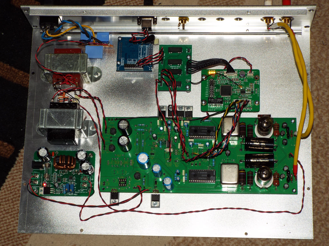

Hello,
I would need some help. I did tried to read back some, but I could not read all, I hope it is not something was on topic times before.
So, my problem is the following :
From a RPI I feed an Amanero combo 384, from that the I2S to PCM board. I use U.FL cables between the interface and the AD1865 board.
It works fine with 16 and 24bit files, 44, 48, 88, 96kHz sample rate. It does not work with 192kHz sample rate. The audio is loud and fully distorted what comes out of the chip. I was investigating why. I think the AD1865 must handle it, since that is designed for 8-16 times oversampling of 44/48kHz. That is plenty. In fact, according to the datasheet it should not work in NOS config, the minimum clock what the datasheet calls is 13.5MHz, while with 44kHz * 32 or 64 is still a lot less than that.
I do use AD1865 in another DAC, with SPDIF receiver, but there the SPDIF receiver is the limitation.
I was thinking is the master clock from the USB interface is not enough, but the minimum requirement is 128*192kHz is 24.576MHz and this is what the amanero outputs.
Do you guys have idea what could be wrong?
Thanks,
JG

I forgot to note an important thing:
I'm not sure the termination of the signals are right. From the USB interface to the I2StoPCM board, I can not measure termination resistor on the I2StoPCM board, which I'm not sure it is right, but I guess it is since Ian know what he is doing. However, I can see significant ringing on the singnals.
Also, on the input of the AD1865 board, I have place for the termination resistors, but I did not placed them, I do not know what value should it be. There is even more ringing on those lines. I think it is not the root cause of the problem above, but anyway, it should be corrected. What termination resistors should I use? 47 ohm?
Should I place some termination in the input of the I2StoPCM board?
Thanks a lot,
JG

Hi Giordano,
The source termination resistor has to be placed right after output. So, if you saw ring on the input of PCM board, you should place those termination resistors right after signal drivers of the source (I guess your USB), normally 33 ohm to match 50 ohm transmission line(u.fl cable). You can not place them at inputs of PCM board.
No any termination needed on your DAC. PCM board already has those termination resistors on all signals.
Another thing I have to mention is that you need to make sure your oscilloscope has enough bandwidth the see a 1ns raising edge. Otherwise, what you saw might be incorrect. PCM board use GHz devices.
Good luck to your project!
Ian
Hi Ian, thanks for your reply!
I can not measure resistance on the output either. I mean, can not measure resistance on the I2StoPCM board output. I do something wrong or it is right this way?
On the other hand, I see no termination resistors on other DAC designs either. I do not know it is right or not. Just try to find why my DAC does not work on 192kHz.
Thanks,
JG

This is my current setup:
http://kepfeltoltes.hu/161005/DSC_0044_www.kepfeltoltes.hu_.jpg
I also have a FIFO board with OSC, but that is in another circuit. If this turns to be the better (and it should) than I will move that too.
JG
